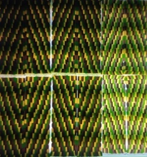

- 2.5x5 inch slices
- image.jpg (54.91 KiB) Viewed 19886 times
I've been cutting a lot of pattern bars and started having a problem with the spray attachment getting plugged up. I ALWAYS use a large bucket to put the water pump with fresh water instead of recycling it. I unclogged it today and cut about 20 slices of a 5x2.5 pattern bar and it happened again. Do I really need to do hourly maintenance of this? Can I avoid this problem all together - what do you do? Here are 12 of the 40 that were cut before coldworking to make them fit.
