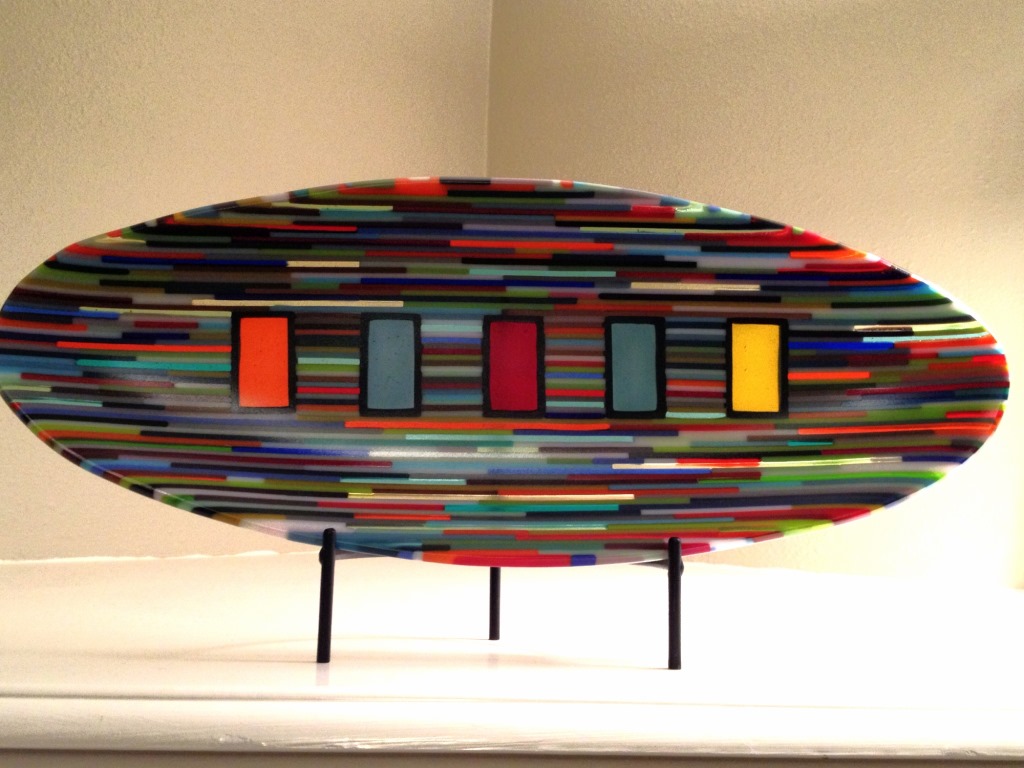

(in the image attached, there was as 'hot spot' was to the upper left corner of the red window, everything was great. very frustrating. Also, not the best picture--iphone and all.

In my opinion, trying to fire polish and slump in the same firing are asking for trouble.
You'd be better off doing separate firings and slowing down on your slumping schedule. I use (what I believe to be Brock's schedule) of 250° to 1150° and hold for 30-45 minutes (or until I visually confirm the slump). I think your slumping temp is too high and perhaps that's contributing to what you're calling 'hot spots.'
Or maybe those are areas that were unevenly coldworked and/or blasted?
Re: Hot Spots during Fire Polishing
1235 really isn't a fire polish temp, so I don't see a slump & fire polish in the same schedule (and isn't the point of a fire polish to get it shiny? :mrgreen: )
In my kiln, my experience is a good slump at 1225 (after a 30 minute hold at 1100). I would drop it 20 degrees and see what happens -- your kiln may be firing hot.

If you want a matte finish, fire to around 1150 and hold for an hour. You can usually do this during the slump.
Firing higher makes it more likely you'll shine up. The variation in finish you're getting is because the coldworking isn't exactly the same everywhere; it's noticeable because of the higher temperature.

By the way, that is a good looking plate, and the shiny spots do not show in that photo!

When producing the satin finish you must be aware of the different colours and how they surface melt at diff. temps. Black will be the first to start to get shiney.. The solution has already been mentioned.... slump the sand blasted piece at 1200F max. or less to keep the "shine" away.

that's a great looking piece!
