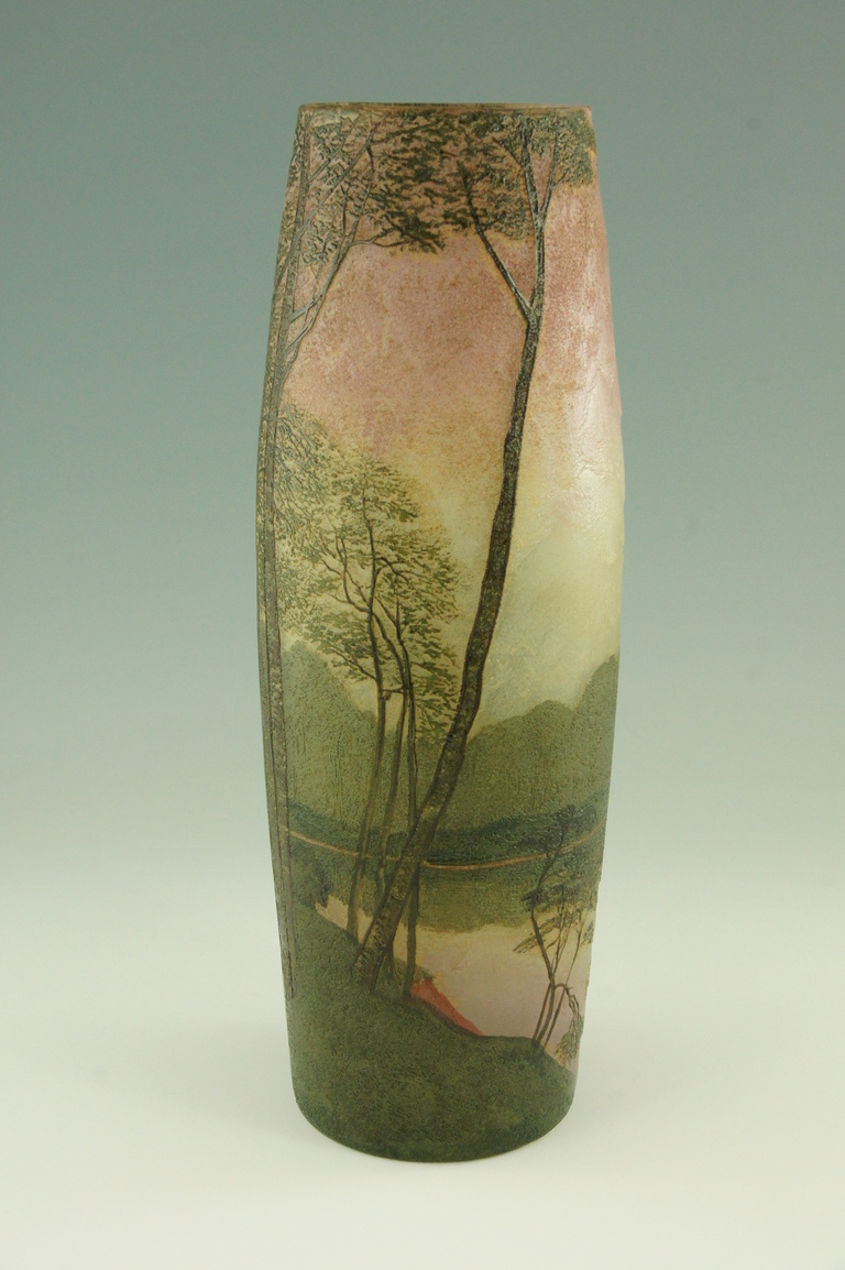

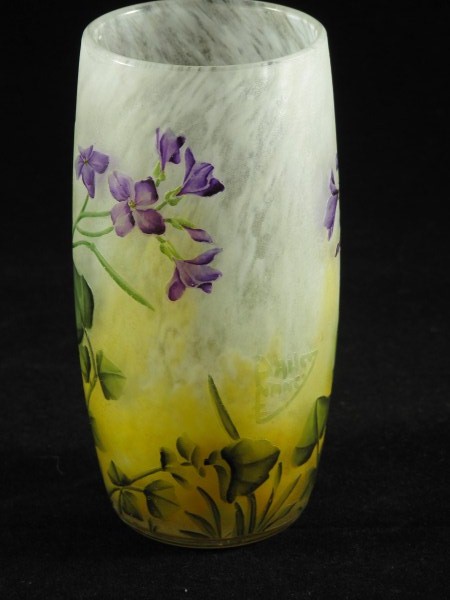

I need transparent enamels to use after kiln casting or fusing. . In the meantime I don't want the enamels to be shiny, like ferro for example... I posted some images as an example of what I have in mind. Thanks a lot for your suggestions.
I would appreciate your advice before buying enamels that would mature at 1200 F max.

Reusche has some transparent colors that mature around 1200 or 1250ºF The top picture could use them. If you were to underfire them, they would come out matte. The bottom picture looks to me like some sort of etching away of thin layers of glass applied by a glass blower. It is hard to tell in a photo.

Yes, it is probably a cameo vase but the pink pastel close to the rim looks like enamal applied as a final touch. I think that something similar can be produced using kiln casting + enamels.

To piggyback on this, the two vases shown at the top of the page were most likely done with enamels or paints that matured at lower than 1200F. Otherwise, they would have distorted in the firing.Bert Weiss wrote:... I wrote that most transparent enamels are in the 1050ºF range.

It is hard to say exactly how the cameo glass is made. Generally, they apply a thin layer while the glass is on the pipe, then sandblast it away after it is cool. They may well have painted the red mist on, or applied it with powder while hot, beneath the black layer.Brad Walker wrote:To piggyback on this, the two vases shown at the top of the page were most likely done with enamels or paints that matured at lower than 1200F. Otherwise, they would have distorted in the firing.Bert Weiss wrote:... I wrote that most transparent enamels are in the 1050ºF range.

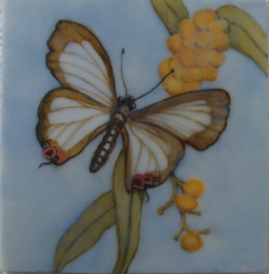

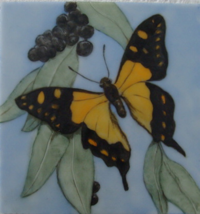

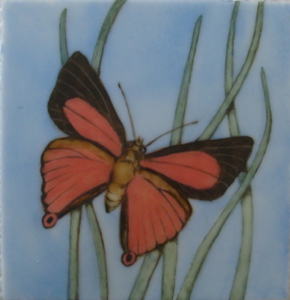

Maggie, these butterflies were painted with Josephine transparent enamels fired at 1085℉, then turned off. Jen
EDIT: Just looked at my notes: Sky and leaves are Josephine other colours are Fay Good. Yellow butterfly has Reusche bistre brown, stencil black and tracing black border detail in wings, fired 1 hour to 1200℉, 5 min hold off. Enamels fired 1 hour to 1080℉, 5 min hold, off.

Thanks for sharing this interesting experience. The painting is very attractive !Buttercup wrote:Maggie, these butterflies were painted with Josephine transparent enamels fired at 1085℉, then turned off. Jen

Buttercup, The butterflies are lovely. What did you use for a medium? I ask because you managed to achieve some nice color blending.
Re: transparent enamels 1200 F - brands
Thank you, Maggie and Vonon.
The Reusche paints are mixed with clove oil, The enamels are mixed with W & N Liquin. Jen
