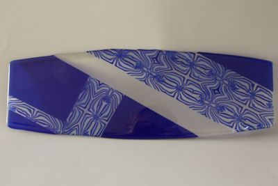

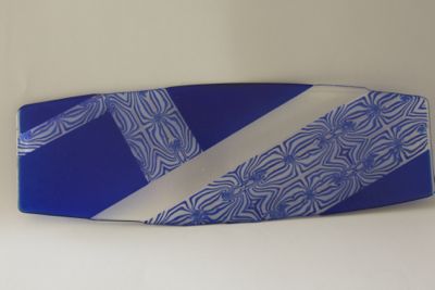

Okay, here's the piece that I want to flip and fire. Came out of the kiln this morn. Edges need to be worked on the WBS, but I'm leaning towards NOT capping with clear...
bottom (soon to be top)
geo back.jpg (14.82 KiB) Viewed 25263 times
top (soon to be bottom)
geo front.jpg (18.15 KiB) Viewed 25263 times
Posts: 638
Re: Damming Flip and Fire
Don't do any more! It's very striking. Do the edges, but the overall impression is great. Jen
