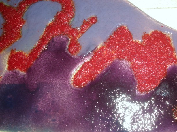

Here is a bad photo of the bad staff I want to correct by re-firing
I want the red not to look grainy, but one flat surface, what is the temp. it should be fired in.

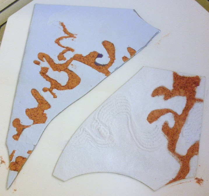

I had 2 pieces in the kiln.
1. the big one, which had fired at least 4 times before, is 3 millimeter, with several layers of powder on it.
2. A smaller one, 3 millimeter, first firing , a layers of 1215 BE frit 01+08 equal quantities. It is also grainy.
I am sorry, I can't post the schedule in centigrade. Of course I had to consider the fact that the bigger one was fired so many times already -
