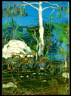

i was a leadlight artist for many years before taking up warm glass and in that time made many panels for kitchen cupboards, which needed back lighting ,,,the most successful way i found was to put a mirror behind the panel,,,one drawback of doing this was the glass colour is doubled ,,light in ,then light out,,,,any way it is an idea for you to look at...the photo is of a table with no inside lighting ,,but a mirror behind the panels

Paul Schulz wrote: the photo is of a table with no inside lighting ,,but a mirror behind the panels
Paul, do you have a photo of the stained glass + mirror combination with inside lighting that you could please post?

by Paul Schulz
hi Peter have had a look through my photos ,,that one is probably the best that shows the mirror behind a panel ,,,with just the natural light ,but here are a few others that i did ,,,the three old guys around the camp fire was put in to a pub ,,,quite dark and not a lot of light,, it worked very well with just the mirror behind it , the other is a mirror with a foiled over lay ,,i had to use a flash to take the photos, as it is in a dark hallway ,,but with just the light in the hallway it still comes to life. i would say for you to get hold of a piece of mirror and put your panels in front of it ,have a look ,,you will get a far better idea if this will work for you...am having trouble trying to load the other photo,,,will try again after i load these

by Paul Schulz
- PaulSchulz_18.jpg (150.41 KiB) Viewed 27375 times
hope you can see this ,had to scale the pic way down to get it to load
