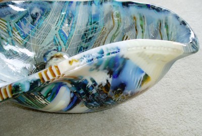

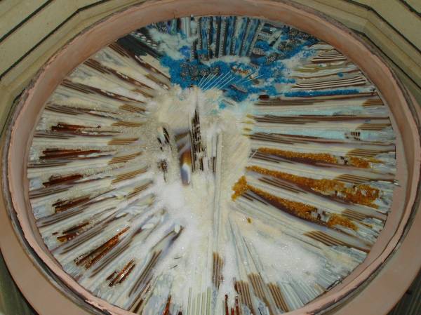

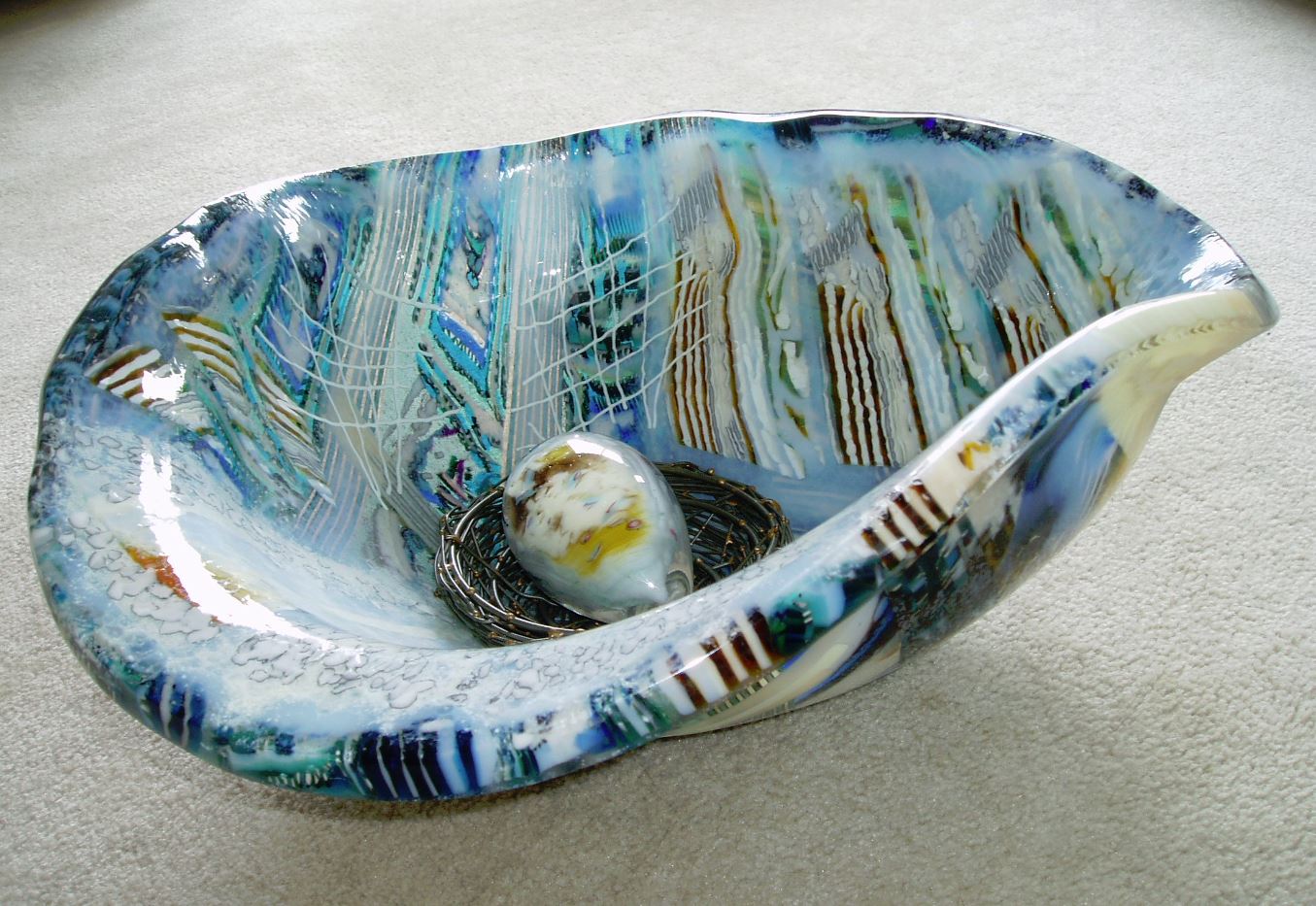

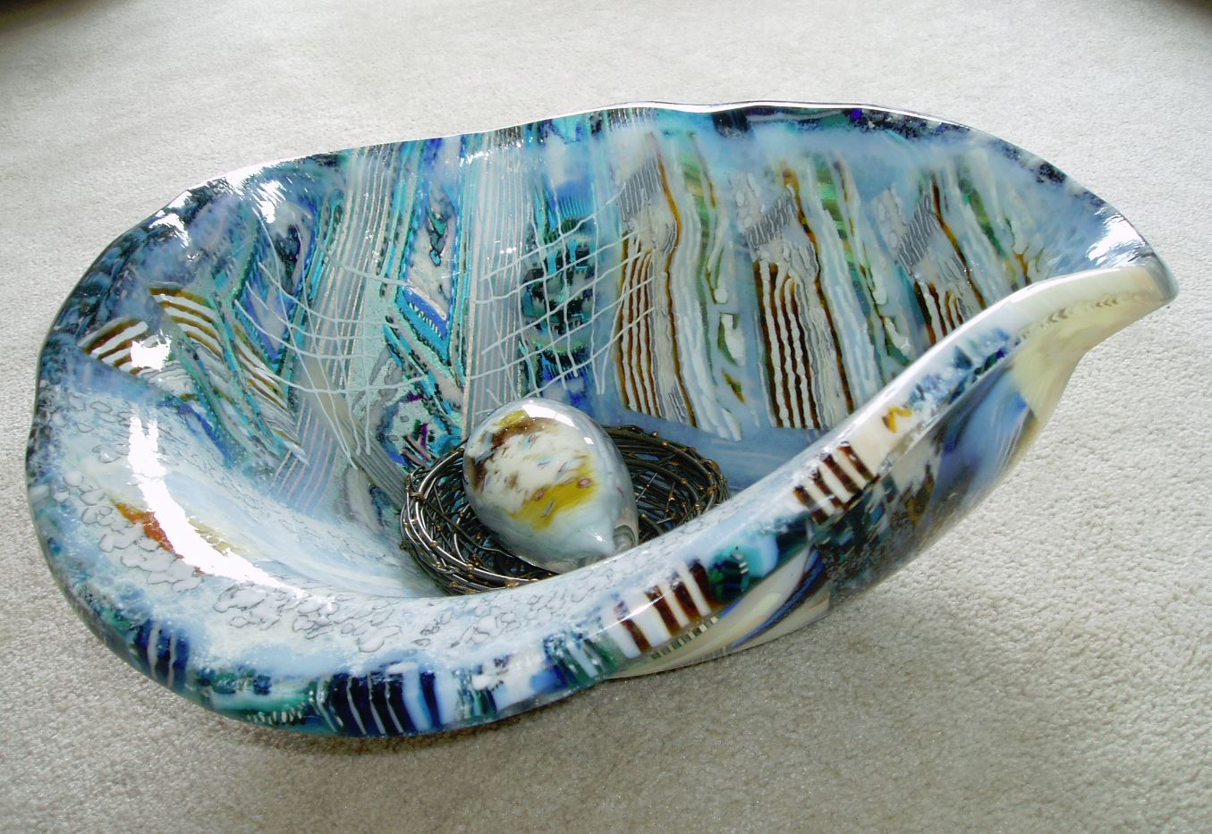

Here is a finished bird nest and below is a mistake that will actually make a really different looking birds Nest when finally done but it was a long journey that had me pulling my hair out.
Well sometimes your best laid plans go sideways or should I say SLIDEWAYS and continues to slump right through the ring you are sagging through even though you have looked at the right temp and shut it down to go to anneal. BUT the thickness got to me and it kept the temp deep inside the thickness and just kept right on going through the ring to land on the kiln shelf below. The wows of experimenting with a thick large piece that is 22 inchs and 3/4 inch thick. BUT at the end of the day instead of a nice lovely deep slump , I now have a new BIRDS NEST which was not the plan from the beginning. BUT also I must give huge hugs and thanks to Rick Wilton who in his busy schedule took time out to help a girl in trouble who needed a lovely polish around this unique piece. =P~ He is truly an inspiration to me to take the work to the next level and a fine polish .
Now I have to get the Forged Metal Birds Nest made to compliment the piece and to match the blown colour bar egg I love creating. Will post a finished picture as soon as it is done. Les

Leslie, you are too kind.
I don't think the true scale of the piece comes through in the pictures. This piece is 16" wide and 3/4" (19mm) thick. It is much more dramatic and striking in person than these photos represent.

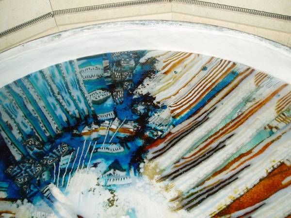

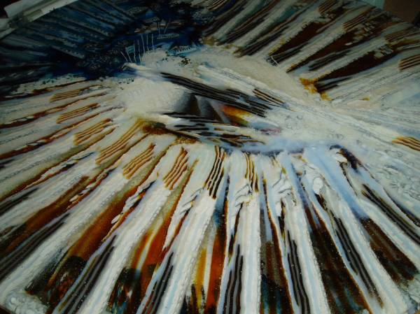

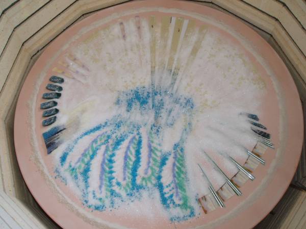

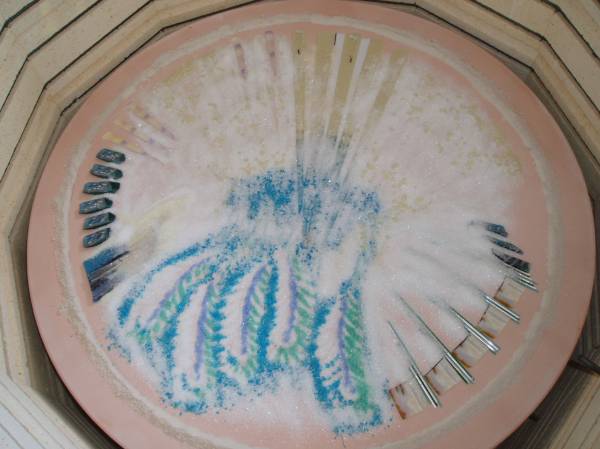

I put my head down and channeled my twin sister and came up with another bowl shape. I made a mold inside a stainless steel ring out of Mold Mix 6 so that it would then turn out to be the exact size of my 22 inch slumping mold. This way I will control the slump better. So here is the new attempt. I want it to be quite different on the underside so put frit down on kiln first.
Twins discussing what to do next. As is our photo , we were very foggy that day :)
This photo is the new mold mix 6 ring and the top of the vessel form which is placed over the design features on the bottom

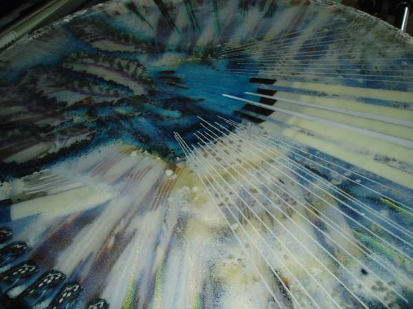

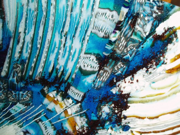

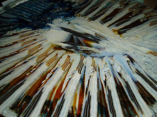

Here is the underside on the kiln shelf before the top layer goes on. Lots of reactive glass, and opaline to help make the underside alittle transparent to how the top layer through.

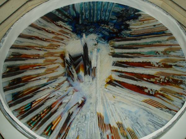

Well the flat fire is done and still will need some edge grinding but the rest is nice . I will slump in large 22 " inch mold today and see how it all goes. The underside is suttle with the sprinkling of Opaline so am happy with that and hope inside looks quite different from outside.
Les

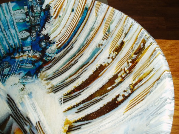

Underside
Re: Mistakes and Taking Risks
Underside
Underside

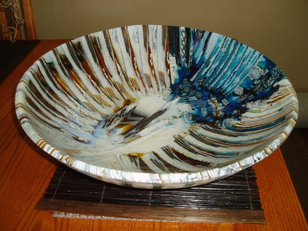

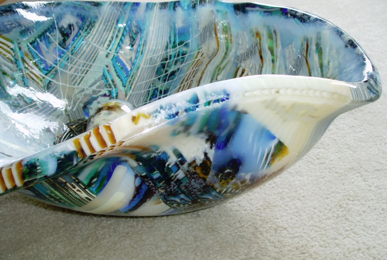

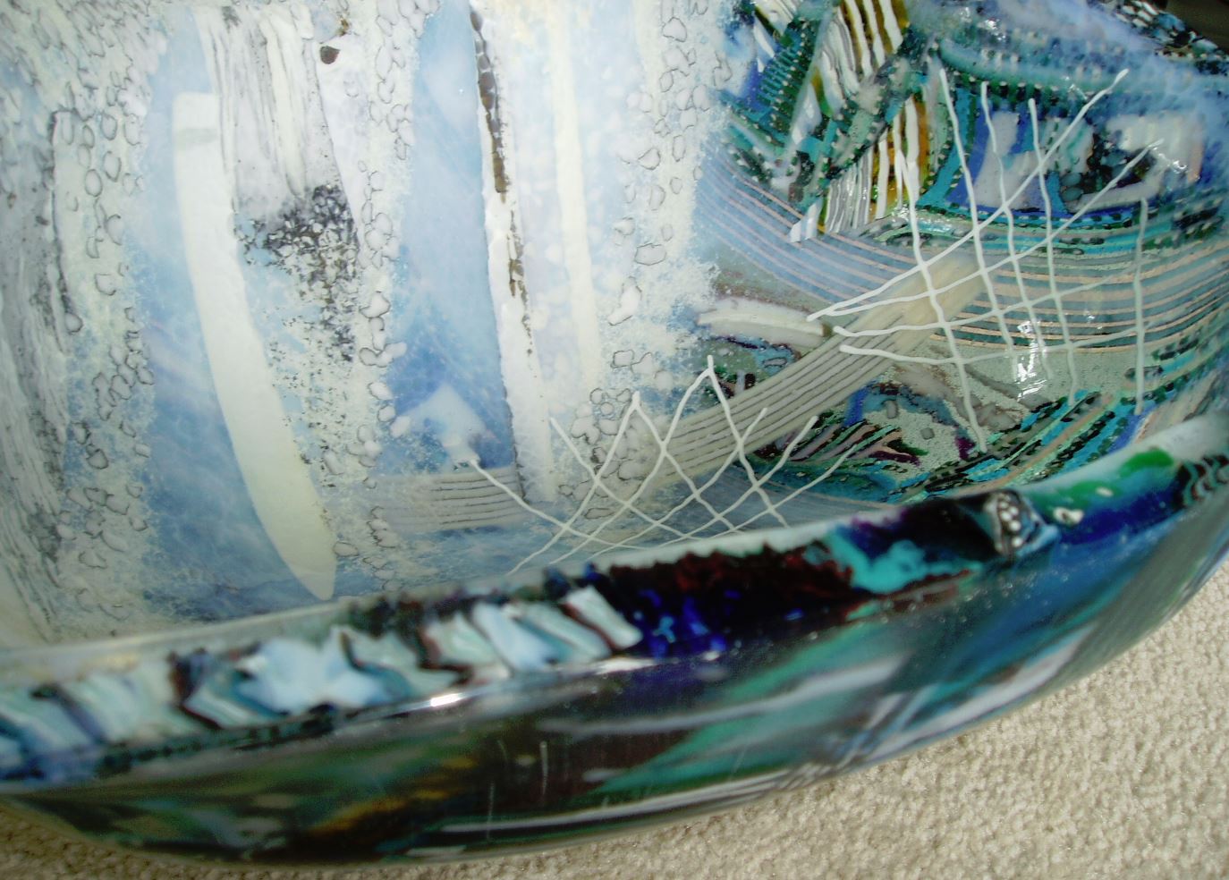

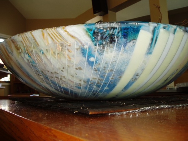

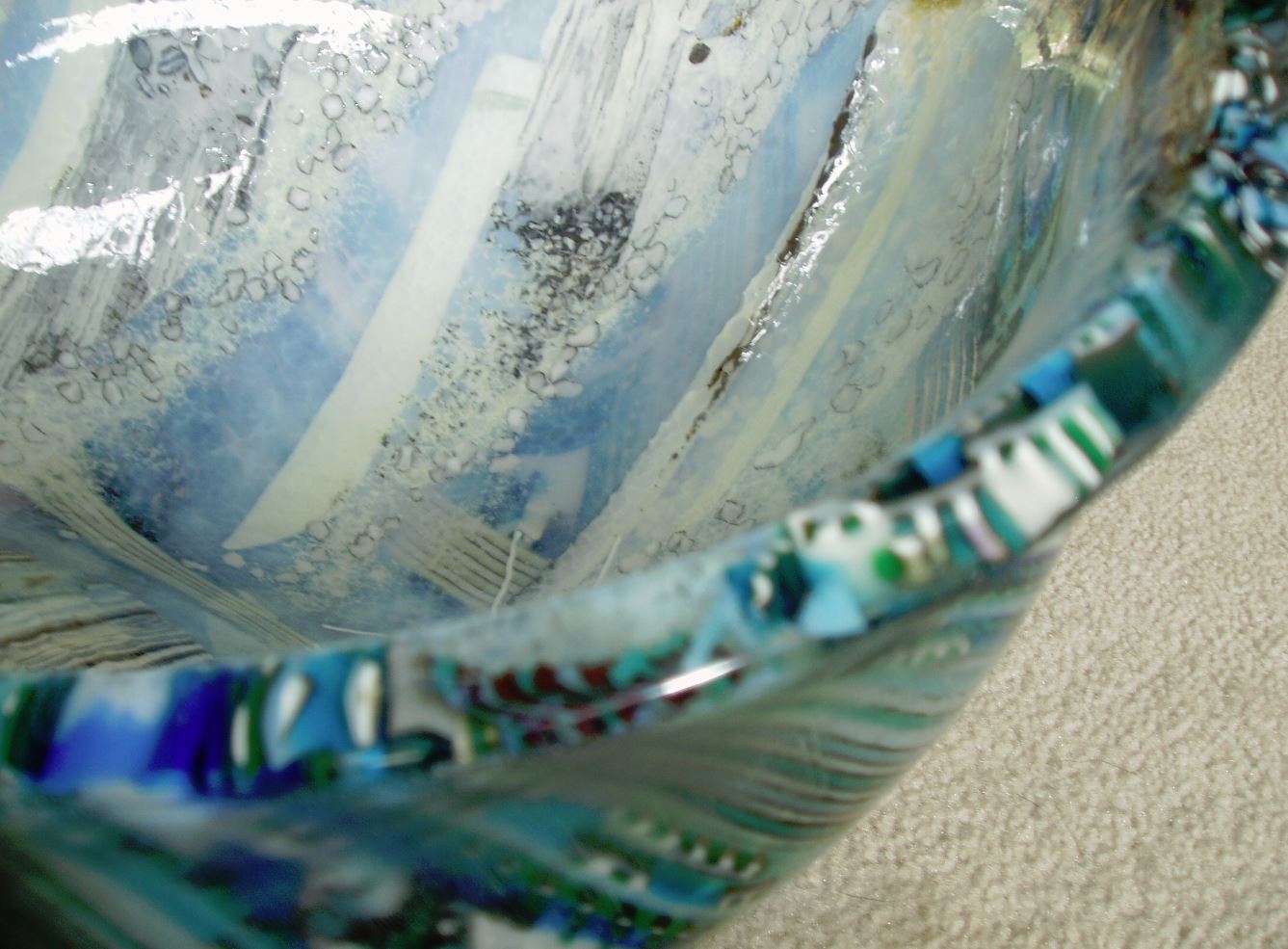

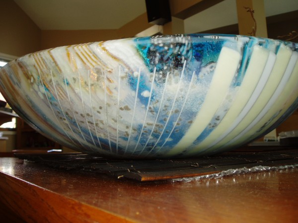

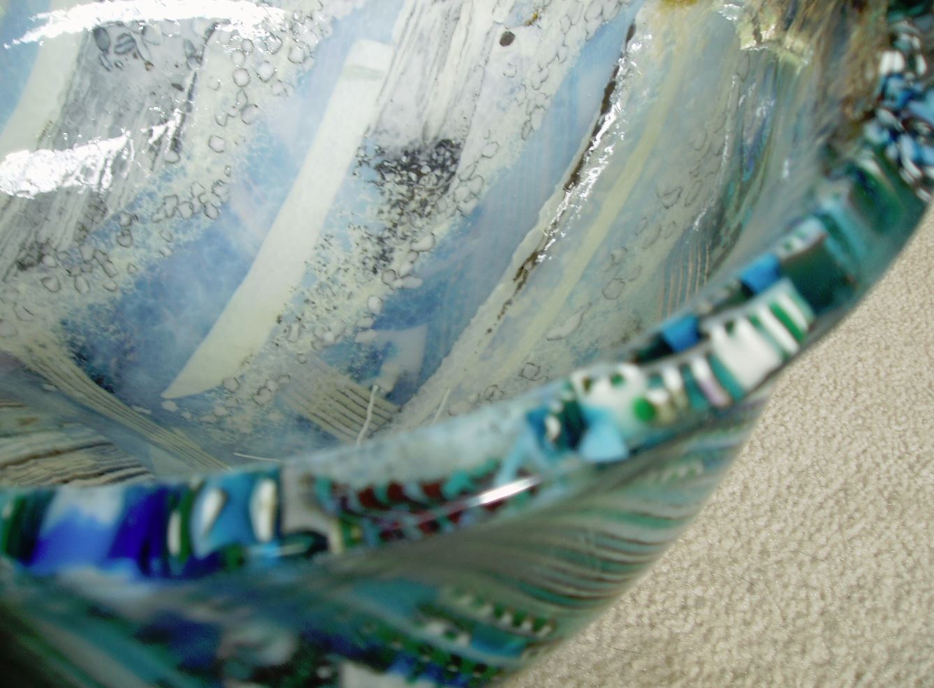

The bowl slumped nicely now off to the polisher to grind the edge . Not great photos but just thought you might like to see the finished piece.

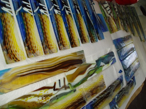

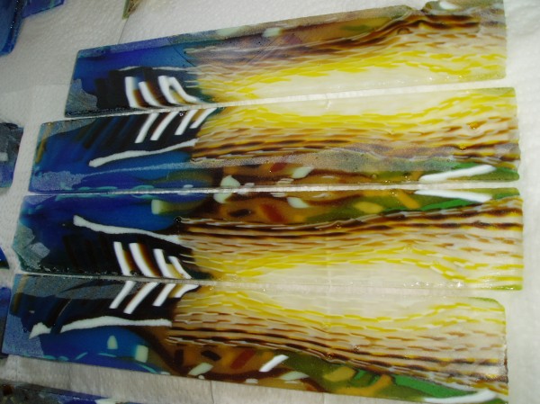

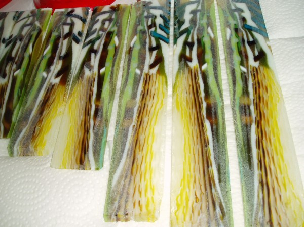

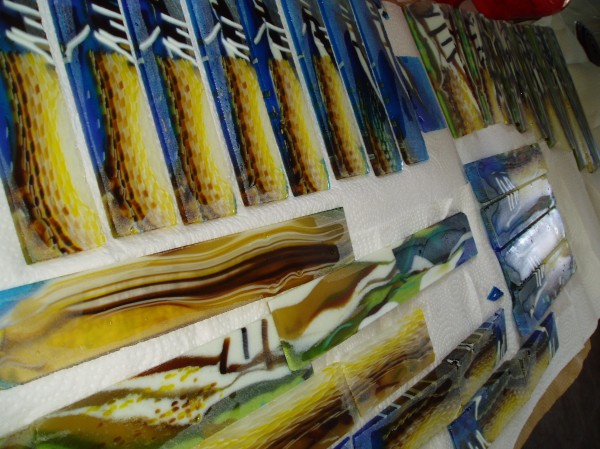

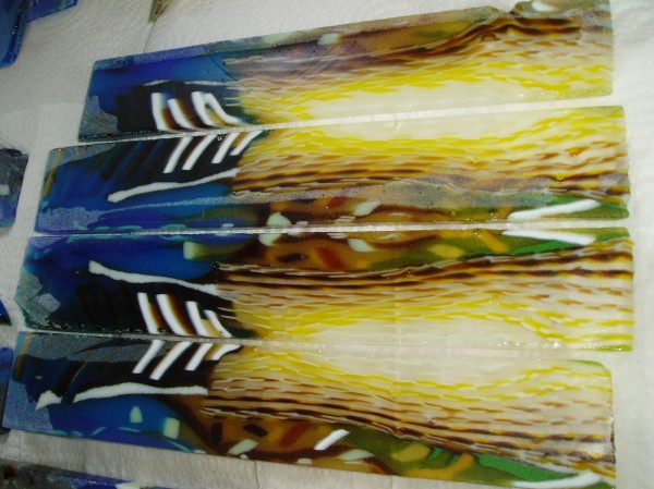

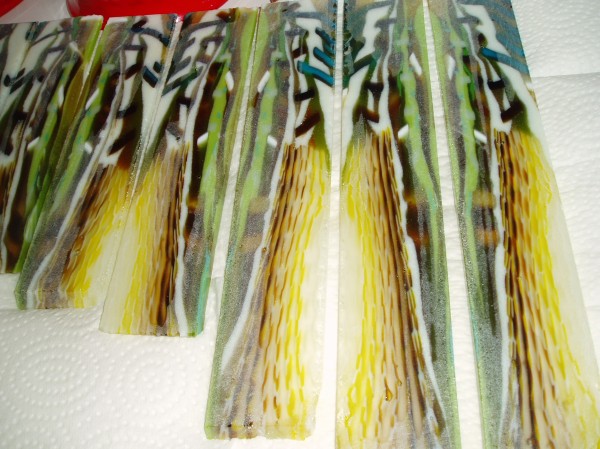

Thank you so much Dana for your kind words. Here are a few slices from my new Uroboros 90 FX colour bars for the residency. I can hardly waite to get to Portland

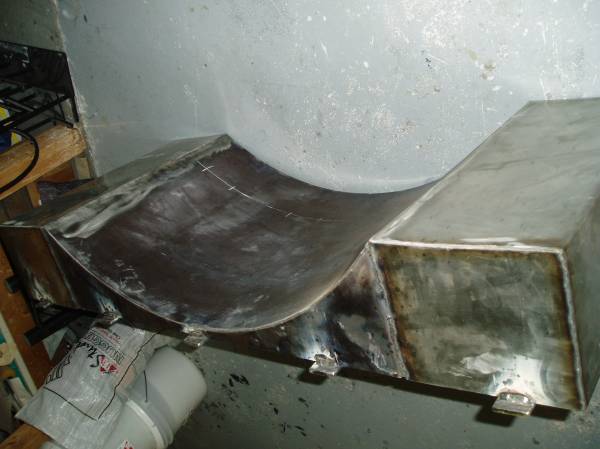

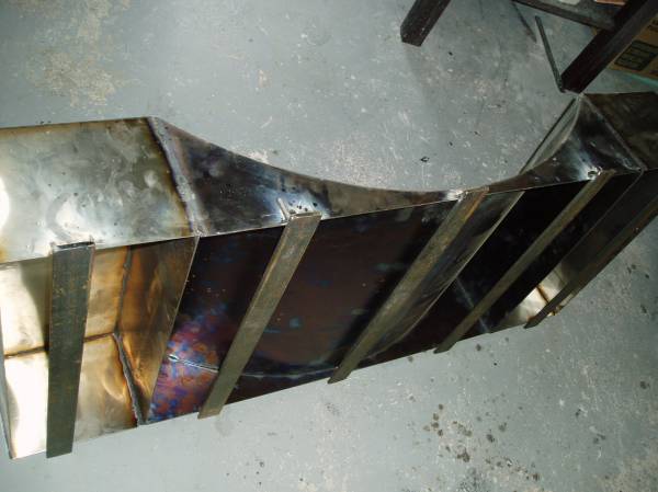

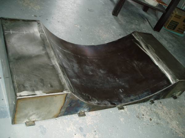

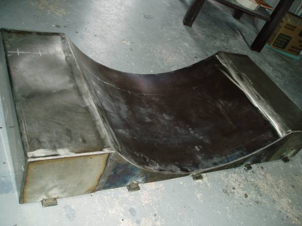

That would be wonderful , I will arrive on Thursday the 24th I believe and work hours to get the kiln ready for the flat fire ( and then large slump) on the 31st. So Monday would be super great. What do you think. Does that work. I will have to get the other kiln on by no later than the 31st so will have alittle time on the beginning of the week. Just call Uroboros and I am sure they will allow artists to come and say hi!!!! Look so forward to it. Here is my new slumping mold that I will be covering with a moldable ceramic material from Zircar Refractory Composites (experimenting so hope it all works ) Will allow the glass to have a cushion and air between the metal and glass is my thinking.
Mold is 50 inchs x 20 inchs x 8 inchs deep. Just enough room in Euclid Kiln but we will have to put bricks all the way around the outside to raise the roof up .
