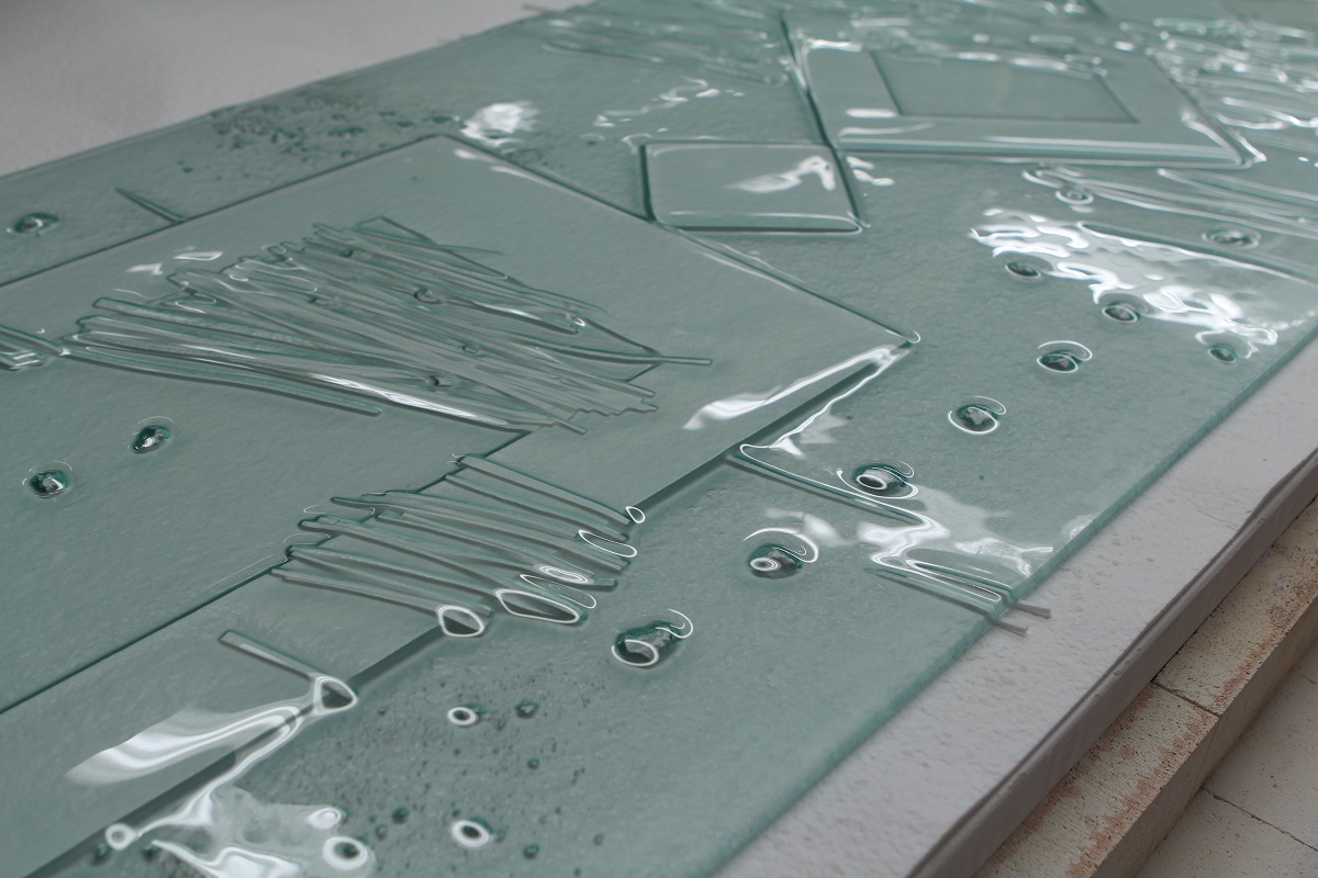

I never worked with float glass before and any related information is highly appreciated. I am working on the project, wall divider 30 by 92 inches, 10 mm thick. I want to create a mix of fiber blanket pattern and dry plaster and then to emboss this pattern into glass. I also want to keep edges of the glass relatively straight and fine detailing of small size texture. What would be the best combination of time hold and comparatively low working temperature? I am thinking of keeping the glass on hold at 1300 -1350 for an hour. Should I go higher for float?

Thank you. I got devit strips along edges around 1.5 - 2 inches wide. They really do not bother me, but I am thinking to try hand polish ... Is there any sense?
Re: Embossing float 10 mm glass
Did you dam the glass? If so, it isn't necessary. As Rick said, I like to work with 10mm glass. I clean it really well, fire tin side down, and have no issues with devit. I never go thinner than 6mm for any reason. The geometry of my glass remains stable, with the exception of the edges which round over, depending on how hot I have fired. With 20mm I will get shape change, but not with 10mm.Victoria Balva wrote:Thank you. I got devit strips along edges around 1.5 - 2 inches wide. They really do not bother me, but I am thinking to try hand polish ... Is there any sense?

Edges are fine I like them. except devit along the edges. I was thinking to polish it off just a little bit (but really I do not want to spend time on it). Alternatively in my mind the finished peace will have gold leaf applied to some areas and glass may just benefit from combination of gold leaf and mat devit. I think that to go higher temperature and shorter soak could be better in my case. The glass was cleaned perfectly before firing. Now the question is what is perfect cleaning and how could I avoid devit in future on float?

The devit was probably from burning out the binders in the fiber paper. To avoid that I vent the kiln up to 1100 f and usually hold there for 20 min or so. This hold just seems to make the glass happier. Venting is huge. R.

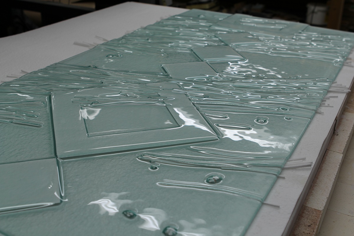

How to organize in the best manner the process of lifting/turning/moving large peaces of glass? Can somebody recommend special vacuum cups for textured glass or any other equipment?

Looks good Victoria, Rosanna is correct about the devit and venting.

There are soft rubber suction cups I have seen some shops use for textured glass, but not as 3D as in your picture. The cups I have only work on flat glass.
I have a set of glass grips that I use for any shape of glass. I discovered that they are obscenely expensive, and I can't imagine that I spent that much to buy them, but I do have a pair.
I like to use rubber glass handling gloves from CRL. 2 or more people with these gloves can lift and carry glass just fine. I have done this with slabs weighing up to 230 pounds.
