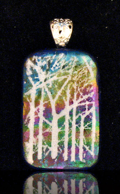

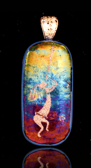

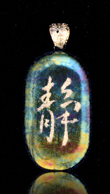

I have been experimenting with firing wissmach irid recently.
I fire both face up and face down. I find that face down is more predictable, but both yield excellent results as long as you don't fire too high.
these are some experimental pieces trying to use mica on irid. Have done more and better on pieces since these, but these pics were available.
