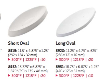

Have you used either of these? Easy slump? Or difficult? Got a picture of the final product?

It would help if you posted a photo of the molds.

Here ya go:

I haven't used them but Bullseye recently released a new Quick Tip: Suggested Slumping Schedules. It lists suggested slumping schedules for all their molds.

I've had those molds for about 15yrs. They are an easy slump.. just use Bullseye suggested schedule.

Check out the latest tip sheet from Bullseye:
http://www.bullseyeglass.com/images/sto ... dule_F.pdf

Those tips are great help - thanks. Besides giving guidance for slumping a new mold, they allow me to parity check my schedules I've worked out independently over the last 5 years or so.
