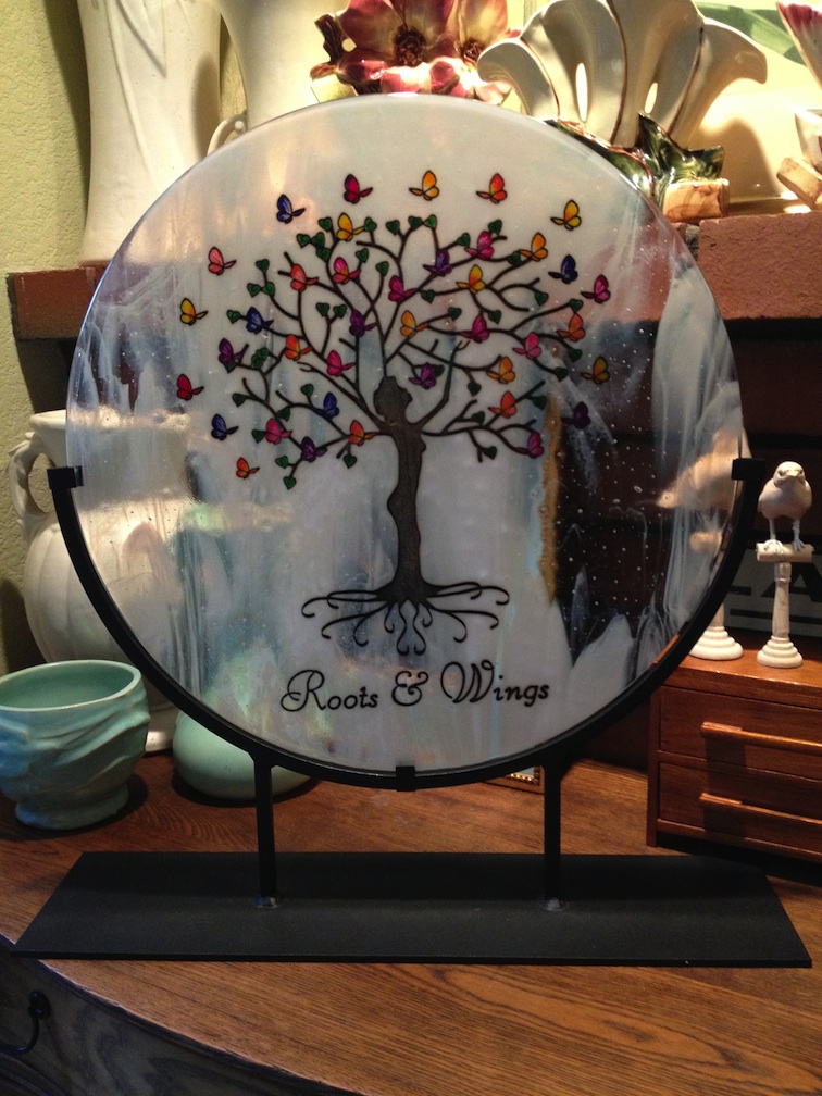

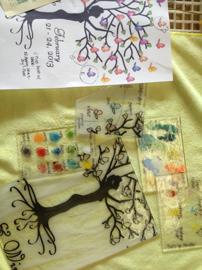

I create landscapes with several firings. Wanting to add small highlights, like your angels' eyes, I really didn't want to do a long tack fire again.
Recently found that Pebeo Vitrea 160 glass paints, applied with a natural soft brush for a fused glass look, work beautifully for this purpose. Bought mine at Dick Blick.
These instructions are from memory as I am not in my studio: Place dried work (usually overnight) in room temp cold kiln or oven and heat up to about 300 degrees and hold for 40 minutes and cool down to room temp.

Re: painting on glass
I've used those Pebeo paints too. As long as it's not a food-safe item, I think they're great. I had a project awhile back that needed to have vibrant colors to match my customer's graphic. Played around with my enamels and various paints before deciding on the Pebeo. I used both the 150 and 160 paints.
