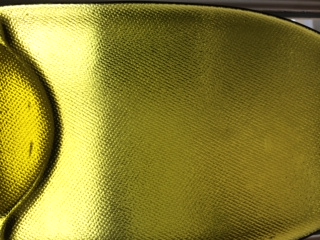

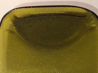

Vonon,
A dear friend asked me to flatten a large number of wine bottles for a project. I wanted to do this fast and inexpensive. I'd read that lava cloth would last about 10 firings, maybe more depending on handling and top temperature. If true, that would make lava cloth about as costly as shelf paper for me. I took a chance and purchased silica fabric refractory weld blanket (Refrasil). It cost about $25 dollars for a 33"x36" piece. The piece came to me loosely folded and had a few flaws in the surface - 2 threads were pulled. These imperfections haven't been a problem. The texture is small and shallow. The cut edges fray easily, but his can be minimized by cutting on a slight angle. I didn't stay with the kiln during firing, but the times I checked it I didn't notice any fumes or burn-off gas. Not being familiar with the product, I still stayed out of the room.
I cut a 15"x15" piece and gave it a try. My top temp is 1475F for 10 minutes. I think each complete cycle has been around 8-9 hours. I've gotten 15 firings into this piece and it still looks and feels like the unfired cloth - you can tell a difference, but it's difficult. I've handled the cloth several times between firings. I still have 3 more usable pieces. The texture is fine and even. The glass slides off the cloth. I found this process/texture faster, more pleasing to look at, and less expensive than the alternatives for THIS type of project.

Re: cloth "molds"
CC, it is hard to argue with success. I warn people that all silica cloths are not created equal. Refrasil is a name brand. There are knock offs out there.CCVICKERS wrote:Vonon,
Re: cloth "molds"
That is why I held my breath for the entire first cycle the first time I used it!
Thank you for making that important distinction. I used the branded Refrasil.
Re: cloth "molds"
CC, The results you got look quite nice and I must say the texture adds a nice element to the bottle project. I will give it a try. And, Bert, I'm with you on trusting brand names. Thank you for additional testimony and photos. Very helpful.
