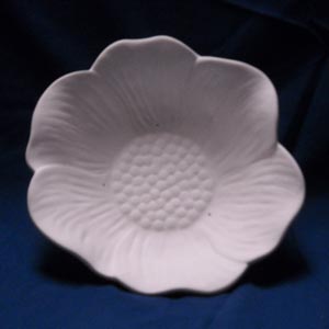

Hello,
Is it possible to make a mold of the inside of a bowl and utilize it? I was approached and asked if I could make 12 salad bowls just like this bowl which is made if some type of hard plastic. I do have a quart of silicon mold as well as ceramic mold and clay.
Thank you
Shereen

Re: Making a mold of a bowl
Posted: Fri Jan 02, 2015 7:58 pm
by Morganica
Arcoroc has a lot of this kind of stuff, at least in clear glass. The question would be if they're wanted in some kind of color or pattern, I suppose. The other question would be whether the design itself is copyrighted.
But yes, you can definitely make a mold of this. Several ways to go about it: The easiest would be to just make a silicone negative mold and then use that to pull a lot of refractory plaster molds from it. Then you can cast, do pate de verre, slump, whatever, into each.
The other way would be to make a permanent refractory--this mold looks as though it's not got any undercut/locking issues to prevent it--from it, and then coat it with release and simply use it multiple times. It would take longer to make the permanent mold, but simpler to just keep reusing it. OTOH, you'd have only one mold, so if you need 12 of the things, you'd be firing it 12 times. (unless you made multiples) If you simply pulled plaster/silicas from your silicone negative, you could make them all at once, fire all together (assuming your kiln is big enough), and have done.
There'd be another advantage to doing it that way, too: You'd have the same firing characteristics for all the pieces. If you're using a striking color, or a pate de verre technique, there can be variances between firings that might change appearance slightly. don't know if that matters.
Posted: Sat Jan 03, 2015 5:17 am
by S.TImmerman
Morginia ,
That's a great idea, I am going to change it a bit and they don't want clear. The colors are yellow/brown to go with green plates. Not my choice tho' however it's not as bad as the customer who wanted a full size ferret SG window a few years back for her bedroom window. Thank you very much for your reply!
Posted: Sat Jan 03, 2015 2:01 pm
by Bert Weiss
I would figure out a way to flatten the image, then mold and cast flat pieces, and slump them in a separate firing.
Posted: Sat Jan 03, 2015 2:37 pm
by rosanna gusler
Bert Weiss wrote:I would figure out a way to flatten the image, then mold and cast flat pieces, and slump them in a separate firing.
yep. me too. r.
Posted: Sun Jan 04, 2015 2:34 pm
by Bert Weiss
I never tried this, but I wonder what would happen if you worked with plasticene to make sections and flatten them. It this fails, I would look for a flat pattern to copy, and then slump it. You can purchase all sorts of plaster or cast metal patterns that might be appropriate.
Posted: Sun Jan 04, 2015 3:38 pm
by The Hobbyist
I would make a plaster cast of the center medallion. Then roll out a flat circle of clay. Press the medallion into the center and hand carve the petals and scallop the edges. Check for any under cuts that need easing and then bisque the clay when it's dry.
This will yield a mold that can be used to kilncarve the design into the top or bottom of the glass blank you have cut (and fused) to size. Since the mold will impart the design and well as a texture from the Kiln wash that surface can't be made smooth and shiny. If kilncarved on the bottom of transparent glass the finished bowl will have the design but be smooth on the inside for use and cleaning. That won't work with opaque glass.
The kilncarved piece can be slumped in any bowl mold to get the desired salad bowl shape.
That's a lot of work but you would have the option of composing the blank with different colors and well as frit or stringer appliques.
Jim "The Hobbyist"

Posted: Mon Jan 05, 2015 8:18 am
by S.TImmerman
Thank you all so much, what I've decided to do is carve the shape on a leather hard 14" round peice of clay. Fire it with vent holes. Pre fire a 1/4 in piece of glass and then use the mold with enamels/frit. Then slump it.
Would screening enamels over the prepared mold be better than using frit to pick up the lines in the carved piece?
Shereen
