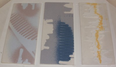

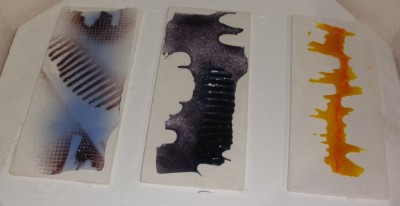

Here are my wafers - before firing, and after
I hope this makes sense.

From the amount of contraction between the pre-fire and post-fire images I would say that you have fired too hot. The degree that the edges have pulled in, and the amount of glassy/shiny lustre are the indicators of overfiring. I suggest firing to 696C for 10 minutes and turn off. Also the colour (viscosity) of the powder is going to have a big impact on the degree of pulling in. If you really want to maintain shape then you might have to fire wafers with significantly different viscosities in separate firing.
Were those wafers fired on fibre paper? I would recommend that you fire on a shelf with kiln wash. The fibre paper can embed in the powder and cause problems.
It will be a gorgeous project when finished.
Cheers,
Cheers,

Thanks , Bob
'Mr Wafers!' [among other things]
Yes I did fire on kiln washed shelf [ceramic one]
I just kilnwashed a bigger shelf, which will be dry probably tomorrow morning, and then I shall fire other pieces, perhaps more powder this time - even though I do not mind the wafers not being too even with powder distribution, as it will create different tones in the final piece.
I wonder, if there will be a reaction, if I fuse a wafer to a reactive background, will possibly depend on the thickness of the wafer. - - -
We'll see
and yes, I shall fire to a lower temp. again, especially considering that these wafers will be fired at least once more.

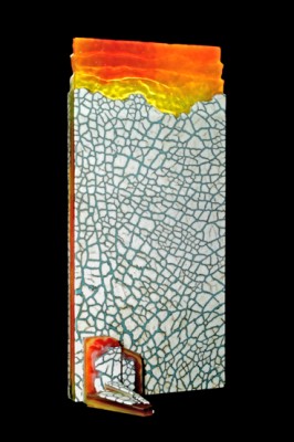

Valerie, I just wet the wafer and then rub the kiln wash with the flat blade of a putty knife... save the vinegar for the chips.
Havi... I find that wafers are very versatile. I really like the concept of building from components. If the wafer doesn't work out then you haven't wasted a lot of glass time or energy. It allows me the latitude to make mistakes.
My latest incarnations of wafers are realistic prints as shown in the attachment.
cheers,
cheers,

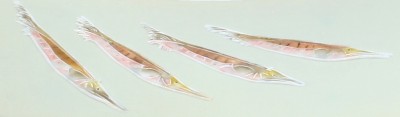

Hi again Havi,
You mention .. My my idea is also to build coloration in the waffers, and with them, but I go more for the abstract ... I attached an image where wafers made from transparent powders have been layered between sheets of glass. The top of the piece was then cold worked to expose the glass and wafers.
I include this image to give you an idea of other ways to use wafers.
Cheers,
Cheers,
