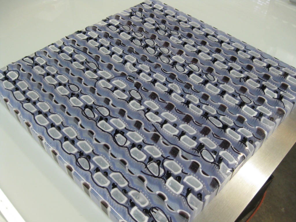

I was recently working on a piece about an inch thick and 17 by 17 inches in size. The glass used was Bullseye opaque white (sheet and stringers), 0013, along with light neo-lavender shift and crystal clear. On the third firing I experienced a dramatic shift in compatibility by the opaque white. The piece fractured along just about every white line, and within a number of squares surrounded by the white. None of the firiings were above a standard full fuse temp. I am aware that people have experienced compatibility shifts with Bullseye's dense white. Anyone have a similar problem with the opaque white? Tim

The initial firing schedule prior to cutting with the tile saw was as follows:
150-350-90
100-1100-120
100-1250-60
300-1510-90
9999-1100-60
70-900-330
60-830-60
60-760-210
80-350-0
The second fusing schedule was as follows:
80-350-90
60-11-12-
100-1250-60
300-1490-60
9999-1100-60
70-900-330
50-830-60
60-760-210
80-350-0
Black markings on the attached photo show the patterns of the cracks.

Tim- the only thing that stands out is the long hold at 1510. Are you sure that's necessary? Have you tried longer/lower?
Yardic Glassworks
- Posts: 80
Re: Compatibility Shift
In short, I probably could have gone lower for longer. This piece started as basically a large pattern bar stacked 2 inches high. The long hold allowed it to level out and rid itself of most of the bubbles, the final thickness being about an inch and a quarter. It was then cut on the tile saw to one inch strips, flopped, then in for the second fuse. The first fuse cut like butter on the saw, so I did not suspect any anneal issues. The results of the second fuse were quite a surprise. Tim
