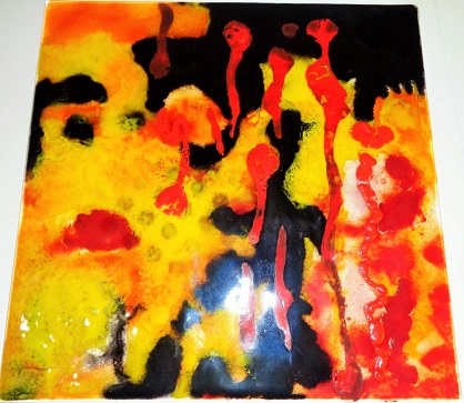

I can try and post here something I made which is mostly powders, but later I added liquid enamel.
On something else I used the silkscreen paste, but it needs to be fired again, so I have not even photographed it yet.
thanks for your input,
This is mainly powders, but the dripping is made with liquid enamels, my first experiment with this. I hope you can distinguish.
