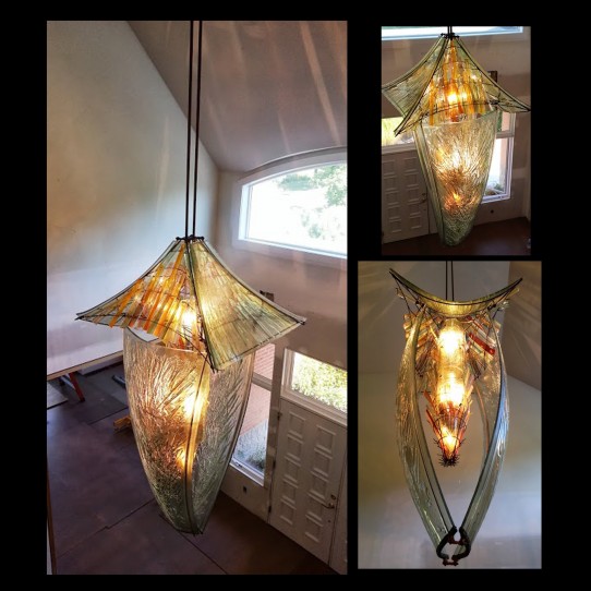

Need few lbs. of transparent enamels for a commission- and have used many from Cerdec, Ceradel, Drakenfeild, to most recently Reusche- never used Ferro or Fuse Master-
Pieces get fired twice- first to 1560F then to 1200ish to slump (1275 at the highest if needed)
Will be 2 layers of 1/4 plate sandwiched to cable slump like I have pictured.[img]
[/img]
path=/Verbage%20and%20Content/Color%20charts/TransparentSeries.jpg
and go as fast as possible up and down on my slump when most of painting gets done- luckily it's mostly blues/greens, some yellows so I can overpower to prevent burn off.
Will probably stick with Reusche Transparents
http://www.reuscheco.com/showColorCharts.asp?
But their damn honest and say 1080F on high end, while others say... and physics is physics and oxide=color
Any suggestions of other transparent brands that can take 1200ish for 5 min better?
Will also have Sn sides of plate facing out, with a lite borax spay on my 1560F, has anyone ever had issues with tin side and or borax hurting blues/yellows.greens?

Andy, it is hit or miss, mostly miss. I had a transparent yellow made by Hereaus (now owned by Ferro). It was good to 1500ºF. However most transparents will burn out if over fired.
FYI, Drakenfeld became Cerdec, which became DMC2 which became Ferro, who merged with Hereaus. Last I knew, Ferro made transparent colors in Germany but did not bring them in to the USA. They had to be bought in Germany.
You're best bet may well be Youghiogheny EZ fuse transparent, which are good in the 1400 - 1500º range and are compatible with PPG float made in Carlisle PA or Fort Worth Texas. I tested a lot of these colors and they did not react at all with the tin side, which expands your options. They do flow a lot more than the float.

Andy, transparent glass colors are intense colors that only require a thin layer, so no compatibility issues. The catch is that they are designed for glassware to not slump when re-fired. So, they mature around 1050ºF. If you can do a final firing, these are a good choice. Going hotter is a crap shoot with diminishing returns.
The Yough colors are simply ground up colored glasses. These require a thicker application, at which point, compatibility is an issue. There are a few other companies with comparable products like Thompson Enamel in the USA, and some European ones as well. These sorts of colors generally require about 1400ºF, and can handle hotter.
I got lucky for a while and my wholesaler in Maine was getting most of their glass from PPG Forth Worth. I think they switched, so now I have to test all over again. These guys buy a container load every week, from a primary supplier, and then keep the other suppliers around in case they need them. So yes, glass is just a commodity, and we often don't know.

I stuck with the same Reusche low fire trans I used in the past with 10 lbs it's way-
+ lucky I still have D211513 Ruby2776 from years back- DAMN!!! Gold has gotten expensive- $1140.00 for a pound today on what I paid $500ish years back.
Yes there only rated to 1080F, but have found by sandwiching between glass layers for my 1560F- + painting it thick on on the bottom to slump in a top fired oven - it works if I rocket fire from AP to bend- then rapid down to 500ish before I shut the lid and stabilize they work well.
Although I still wonder if borax is worth it.
To me it's back to the basics Doug Johnson taught us at UWRF- Doug was in Harvey Littleton's first glass class at UW-Madison- and founded the glass program Jim Engebretson took over when Doug gave up glass and went back to cermics/sculpture-
"Silica+ flux + color= ceramics glaze"
Dick Huss taught me the same was true for batching glass colors, along with time/temp/atmosphere basics.
So- is borax a flux in this equation?...
I use it to stay extra safe and extra clear, but is it's risk vs reward worth it?

borax is a water soluble flux. Consequently, acid rain is enough to dissolve it, making it fugitive. Back at the turn of the 20th century, they made vitreous colors using borax as the flux. I once had a job fixing and matching one of these panels. I ended up making a new painting and exposing it to a strong enough acid to degrade it enough to match.
