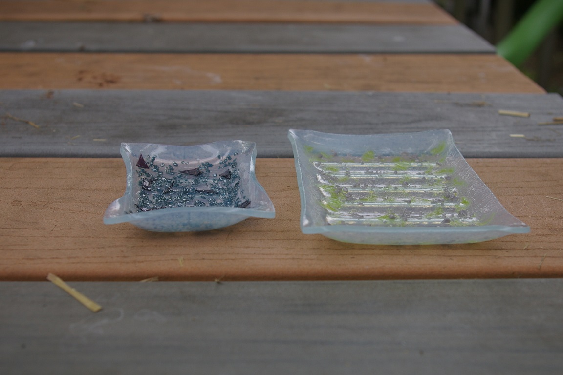

So with new numbers I made new soap dishes in my molds. My new numbers were ra 1 300 to 1100 hold for 35 minutes, ra 2 500 to 1225 for hold 10 minutes & ra 3 9999 down to 950 hold for 25 minutes.......I had NO spikes/needles !! And very little devitrification on the back of the slumped glass ;-) I am much happier on those 2 things.........but why is my glass still sagging into the molds especially along the longer edges on the small mold ? The same glass was used in both molds. Please comments are appreciated as I continue on ;-)

no one layer, i had also put on some frit to fuse into the glass ;-) Could that have caused the saggy edges ?

Yes, you'll have better luck with two layers (6mm / 1/4"). A lower slumping temperature with a longer hold might also help prevent the dogboning.

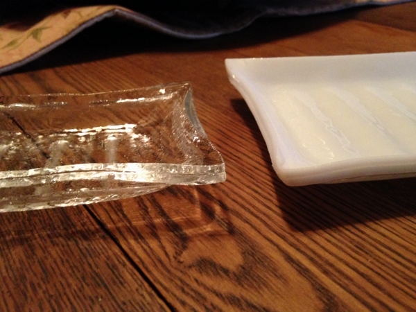

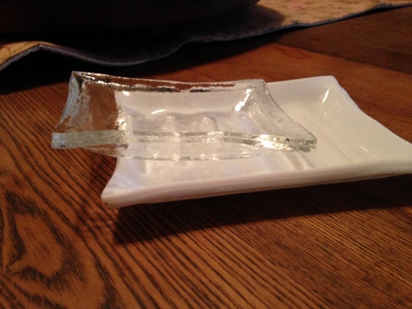

hello all did a 2 layer of glass on soap molds yesterday & wanted to share my pics. My settings were ra 1 - 300 to 1100 for 30 minutes, ra 2 - 500 to 1220 for 10 minutes & ra 3 - 9999 down to 950 for 25 minutes. Thoughts please on being able to " see" the gap in between , should I lengthen the ra 2 time longer ??
Posts: 1527
Re: soap dish/molds
Did you fire the two pieces together first in a separate fuse firing before you slumped?

Brad Walker wrote:Did you fire the two pieces together first in a separate fuse firing before you slumped?
I was just about to post a question on this. I'm about to make my first slumped item and it's a lot like the ashtray here. It will be 3 layers. Should the 3 layers be fused flat first, then slumped?
-BEP
Brian E. Parker -- Broken Arrow, OK
Posts: 1527
Re: soap dish/molds
Yes. Absolutely.

no i did not ;-( Still a learning process for me ! Will do 2 more sets of soap dishes, fuse them together, THEN slump them together ;-) THEN add the frit & confetti......OR could I do the frit & confetti at the first fuse & THEN slump them together ? I sure wish someone near me did a class ;-)
