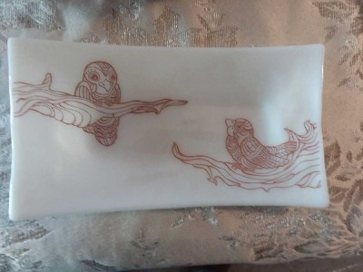

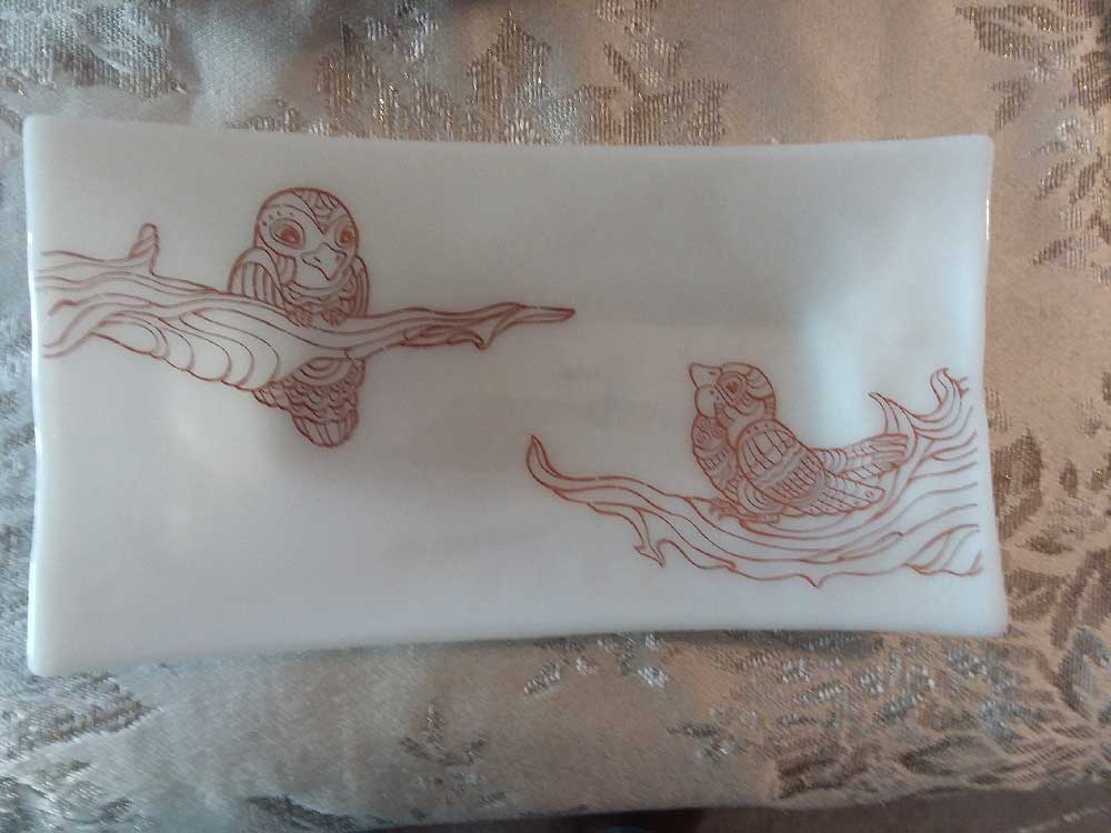

I'll add that different brands are vastly different quality. DOn't waste your money on "World of Paper" brand - will fall to shred before you even get a fingernail sized piece off. "Papilio" is some of the best imo - they have several different grades.
A light hand polishing with cerium oxide and a cloth will usually remove any haze from the decal base(usually a plant starch). Sushi dish made with line art by my daughter.
Planning on doing some more of this kind of stuff when I have 5 of my grandchildren here for the week after Easter. With their art.
