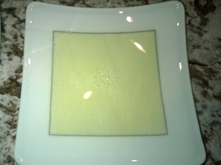

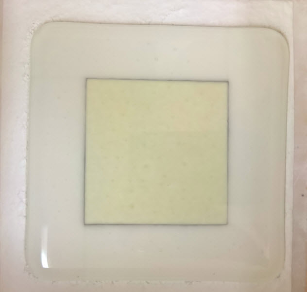

I think I'm not trying to do anything as complex as what I think you're describing, Cynthia. Here are two pics - they are not of the same piece, but they show what was going on.
The first is a piece after my normal fuse schedule for this kind of item in my Caldera - FAP from 1250 to 1480, hold 10:
And here is what it looks like after I've run it through that same schedule a second time:
Even now, as we speak, I've got a test in the kiln with a slower ramp to process, and a longer hold. Hopefully, that'll produce the results I'm after in a single trip.

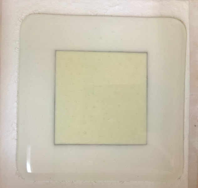

And here are the results of that test:
