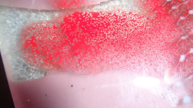

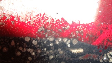

Re: WORKING WITH LIQUID ENAMELS OR GLASS PAINTS
DSC00909 - עותק.JPG (50.25 KiB) Viewed 46037 times
DSC00913 - עותק.JPG (52.51 KiB) Viewed 46037 times

If the Colorline people can't help you with your problem after seeing those excellent photographs, then its time to move to a different paint. I'll repeat a detail of my suggestion to provide all of that information AFTER you obtain and experiment with some of Brad's Sunshine colors. There are a lot of people on the board who use Ferro Sunshine series porcelain overglaze colors. They can better help you diagnose your issues, if indeed those issues still occur with Sunshine paints.
Even so, the way that red paint is 'crawling' is interesting. it's like the pigment in it is gathering with surface tension more so than the nearly clear edges that are underneath. Is it two layers of paint that you've screened in a single application? or simply a single layer of red paint that is separating into two layers, clear edges and red hills? Both layers are crawling. But it's complicated processes at work there. I don't understand what's happening.
http://www.lakesidepottery.com/HTML%20T ... awling.htm

Havi, you are applying too thick a coating. This causes the orange peel effect or cracking and volcano effect. (thinking about it I think orange peel is caused by under firing) These colors are really strong.
Color line are really Ferro Samba series. These are similar to the Ferro Sunshine series but require a bit higher temperature to mature and are lead free. I have limited experience with Samba series, but that is because I prefer Sunshine. Application should be identical with both, firing simply higher for the Colorline (Samba).
As anybody reading this board knows, I have been advocating the use of this style of colors with fusing glasses for decades. Bullseye finally picked up the ball and is running with it.
Havi, stick with it. These colors can be used with many print making techniques. Think thin.

And most important according to them - the paint surviveS MULTIPLE FIRINGS - this is not proven in realty, in reality each firing 'burns' more of the original paint, It happened to me more than once, in more than one piece. with more than one color.
I had also trouble using violet color - which became white after firing - and I have photos to show this.
Luckily , I am used to photograph everything I put in the kiln before and after - for this very reason, also in order to track successes , and be able to repeat them. So I have everything documented, including the specific schedule of each firing.
I wonder what response shall I get if I put this on BE bulletin board.
From what you say I understand that I should try learn more about the Ferro Samba series. I'll check it more carefully.
In any case those who sell Colorline should experiment more - and have exact specifications that represent the real product , its abilities and disabilities. I know now, that there are others who had the same experience as me, and probably more who would not admit a failure....but know I am right.
many thanks,
