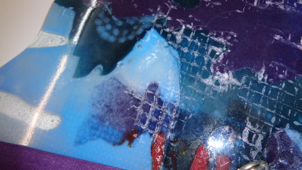

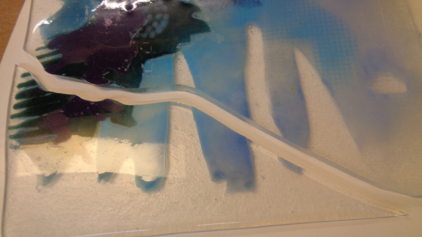

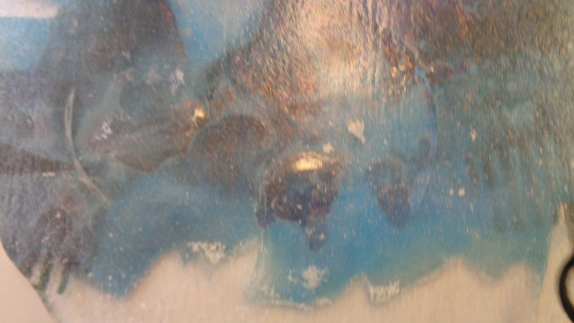

Here are photos
of the breaK
of the cracks on the back side, But then why are the cracks where they are???
on the front side [ very hard to see them, even in reality
The violet was BE 1234, the 'green' is definitely incompatible.

Stress is stress, regardless of where it comes from. Stress is cumulative, so adding a little bit more can cause a crack. If you have compatibility stress, combined with annealing stress, and you add a puff of cold air to it, your result is not a surprise.
Many years ago, I was trying to cut the thinnest strips possible from a sheet of Bullseye streaky green opalescent. I found I could do this consistently in a place in the sheet where there was just the opal base. The glass would break on me in the streaky places. I called Bullseye to ask why. I learned a lot from this little experience. They told me to look at the edge where the streaks were and what I saw were deep striations emanating from the score. In the places where the sheet was consistent, there where no striations. These striations were caused by stress from the compatibility differences between the 2 glasses. We know that 2 glasses can live together within a range of compatibility stresses, without breaking. If you get towards the outside of that range, you will get effects.
I just saw the picture and it looks like a combo of annealing and thermal shock to me. There is no trace around an offending color, which indicates incompatibility.

Photo 1 looks like annealing to me. I don't think 45 minutes is long enough hold at 515C/960F.
