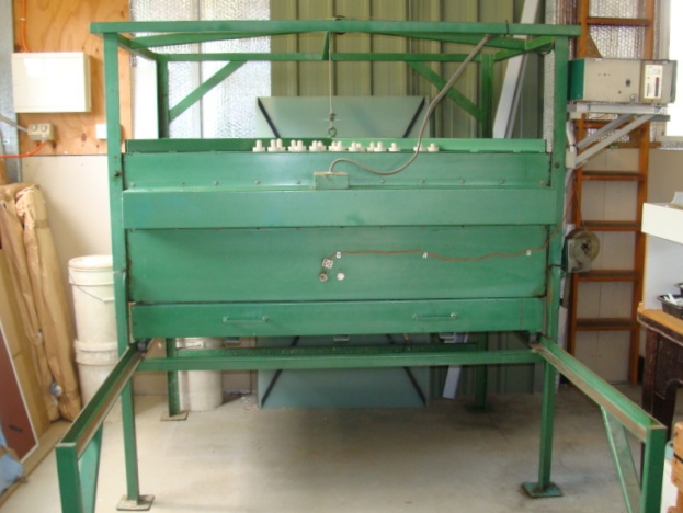

I, too, have three kilns and have a large kiln for sale. Where are you?? I'm in SE Queensland so picking it up might be a problem if you're in the US. I'm taking offers, highest will take it. Jen

I want that big green kiln but I can't have it

Queensland is in Australia,right? If so, not gonna work. I'm in Chicago (U.S.). But it looks pretty cool.

Don, for you, just pay the freight and as a 'thank you ' for all the good advice you provide I'll send it to you! Jen

Hey Jen, can I ask wh you are getting rid of that kiln? I've always thought that design is very nice but you don't see it around much. Is it difficult to use?
Posts: 634
Re: large kiln
Hi Chris. I just haven't needed to use it. Everything I've done so far has fit in one of the smaller kilns. I got it because I wanted to make some large panels for the house we are building but the design changed and so it didn't get used. (That's the problem when you're building it yourselves, part time...too many opportunities for new ideas. Any project that isn't actually underway is fair game for revision. I counter comments that I change my mind a lot with the reasonable response that I've just had more than one idea in my life!)
I'm not sorry that no-one has made an offer. (Maybe advertising it in the Gardening section had something to do with that). The base of the kiln runs out very smoothly on its rails and it would be nice to use because you don't have to duck your head under the raised top, which I think would make me nervous. (I think it's called guillotineophobia ). It has large bung holes at the ends for viewing the interior while it's firing. The winch that raises the top works smoothly.
Sorry I can't tell you more, Chris. It's not wired in but if I do fire it I'll report back.Jen
