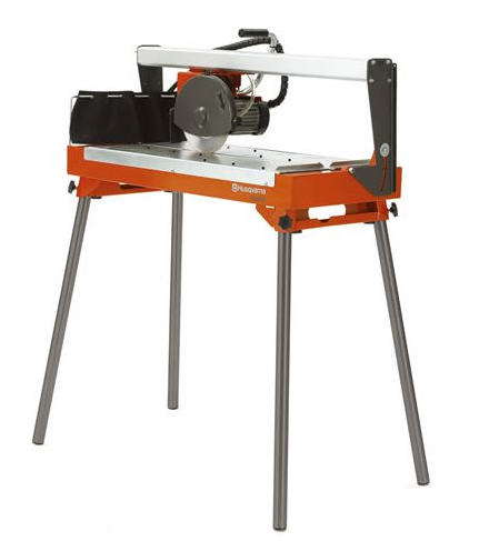

A rail tile saw looks like this. I live in Australia, many of the tiling specialists here are originally from Italy. This is the type of saw they recommend and is easy to find locally. Mine is made in Italy, but there others. Many years ago I participated in a class with Patty Gray in Sydney. I have the idea that Patty said to me she has a rail tile saw and is (at least was then) very happy with it. She mentioned they are expensive (they are or at least were when I bought it).
This is a picture of a Husqvarna tile saw, from CRL

Re: Removing Rim From A Large Drop
aka bridge saw, being sold more and more for larger tile work. I got cheap thin wood blades as stiffeners for thin kerf diamond blades.
Mine's got a lock to keep the saw from moving on the rail so I could push work into the blade but I'd rather hold the work on the table and take successive cuts and finish on the flat lap and WBS.

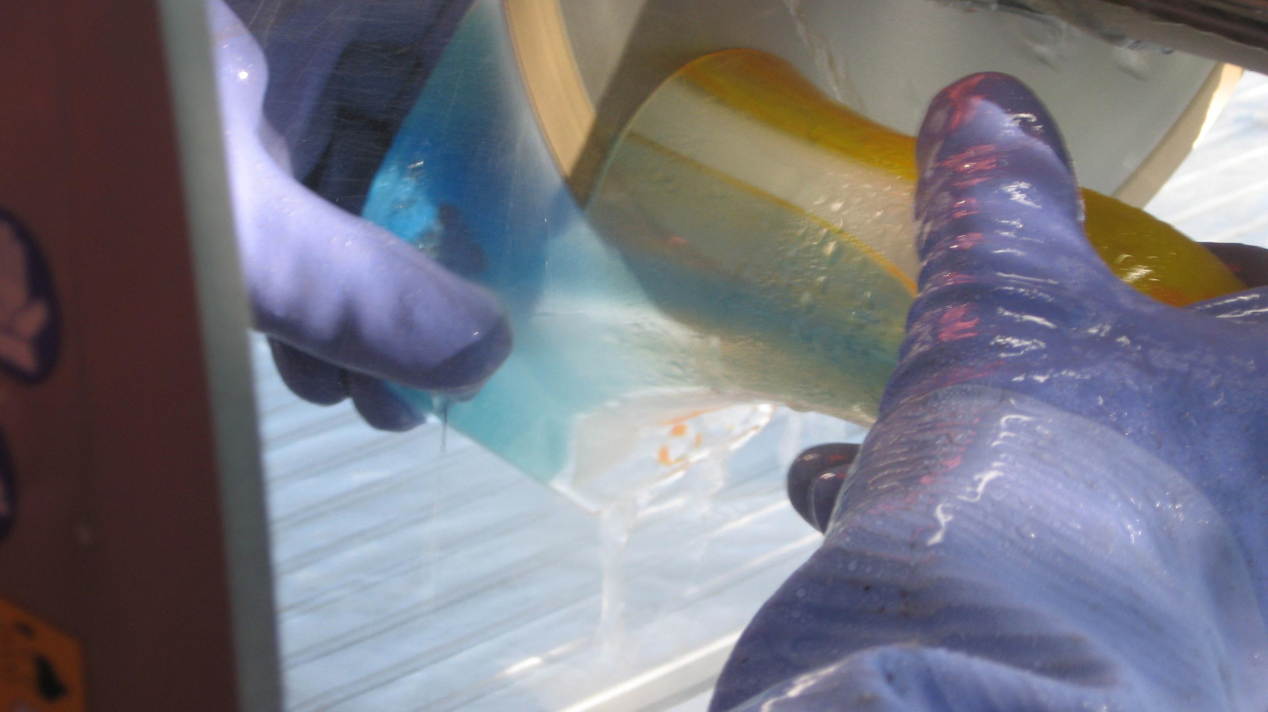

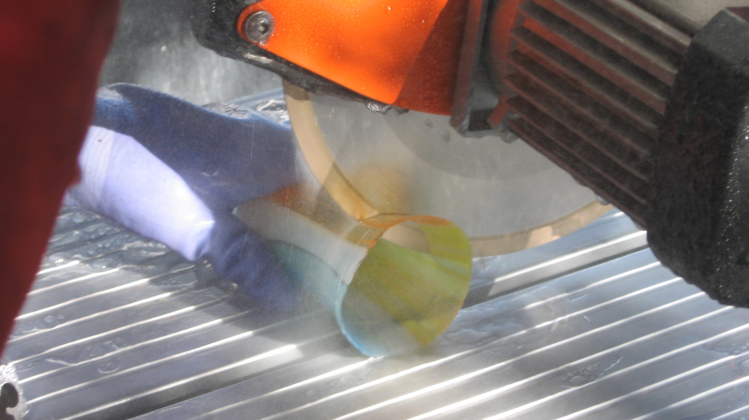

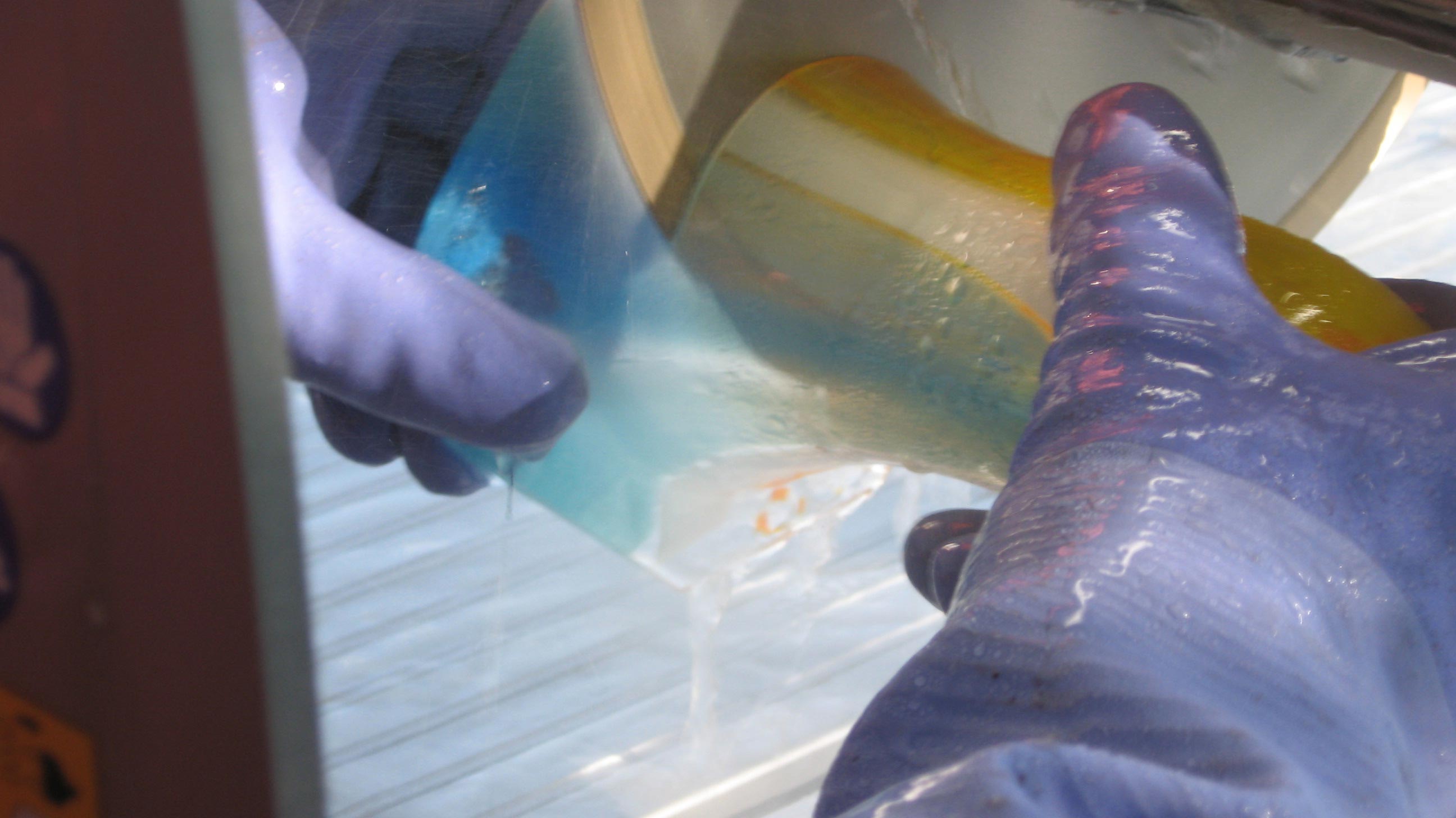

Hi Jen
Trying to see if I have some pictures of how I did it (a couple of years ago). Will post again if I find any. I am a bit of disaster when it comes to keeping pictures organised .
First I cut the corners of the flange to get an octagon shape. Then held the vases (made with 3 layers of 3 mm glass) by hand with the flange parallel to the saw blade. Locked the blade in place and move the vase slowly against it, letting the saw do the work, rotating as necessary, removing the whole flange in one cut.
Had 3 to do, twisted the first one slightly and broke it. The other two worked well.
However these were tallish drop vases (about 10 to 12 cm from memory), and not very wide at the rim, therefore not too difficult to hold, and not very heavy.
Warren's piece is much larger, heavier, and I would think a different shape (probably more like a wide cone), I picture it would be difficult to get the hands around it. Everything gets wet and slippery. Also being 5/8" thick, one would have to hold very steady for much longer.
However, I would think it is possible. If i have any time this winter, vases (drop and slumped) are my "project"...will be interesting
When I researched this on the internet at that time, came across some posts were people scored around the rim, tapped and removed the flange this way...sounds to me pretty difficult to do, specially with thick glass, but - from the posts - it is doable.
Best regards, seachange

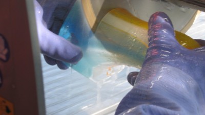

Hi again, found my pictures
This orange/blue small vase I cut further to remove the flare at the rim...was after a more or less straight side.

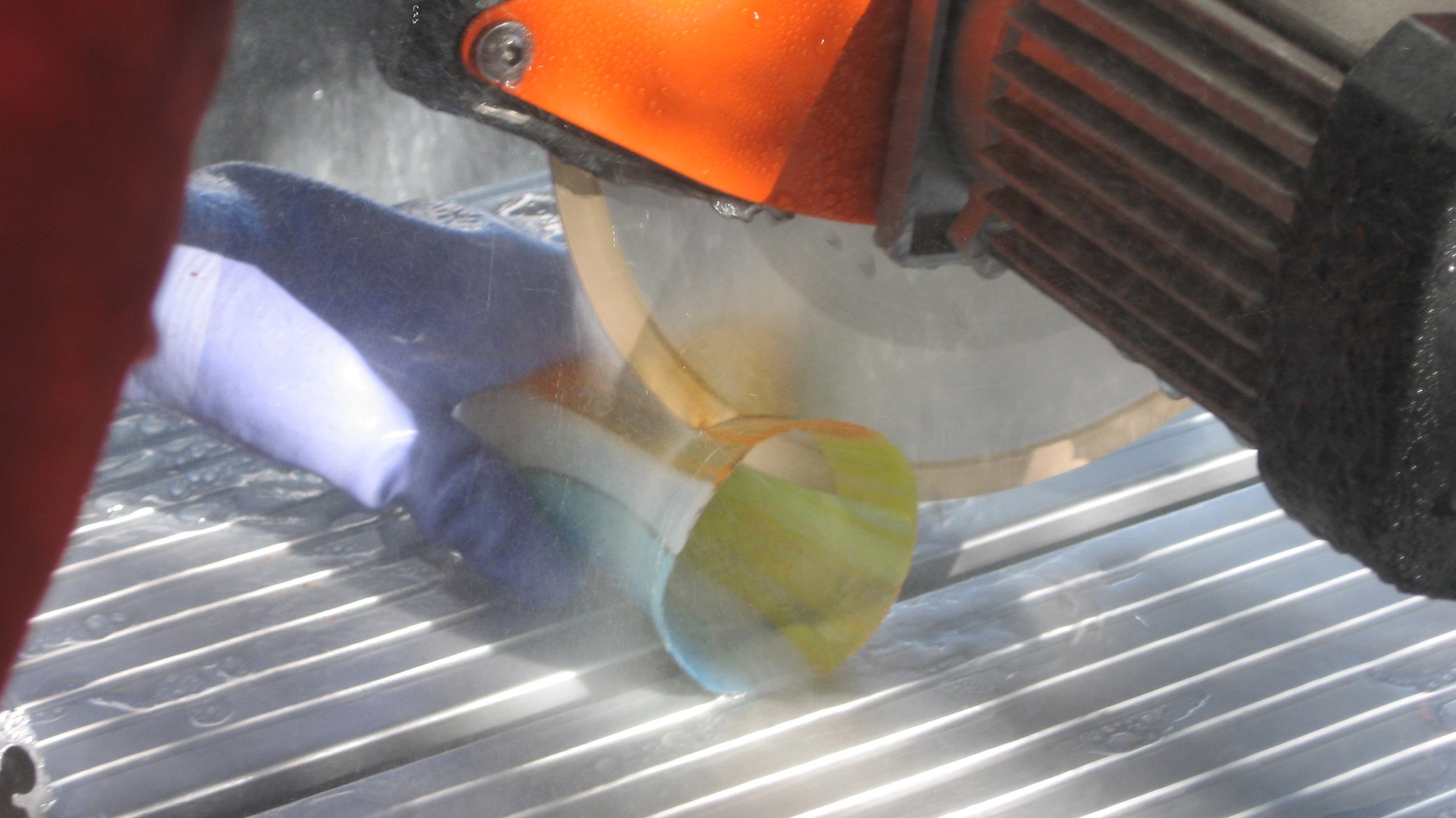

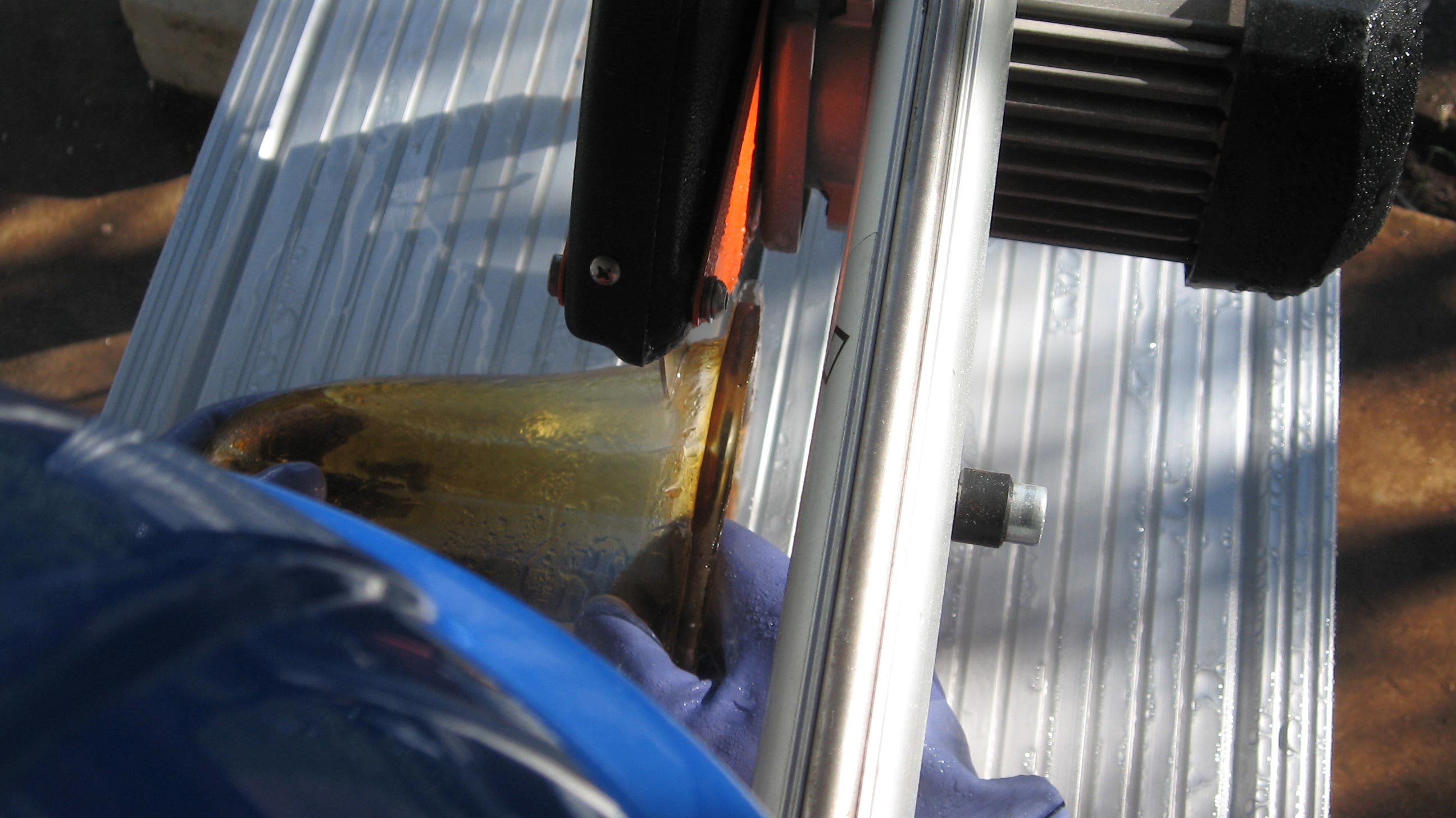

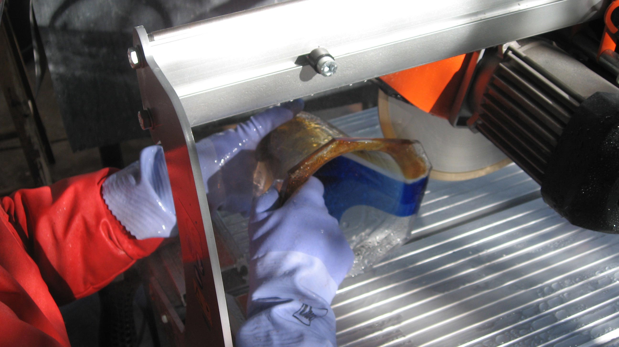

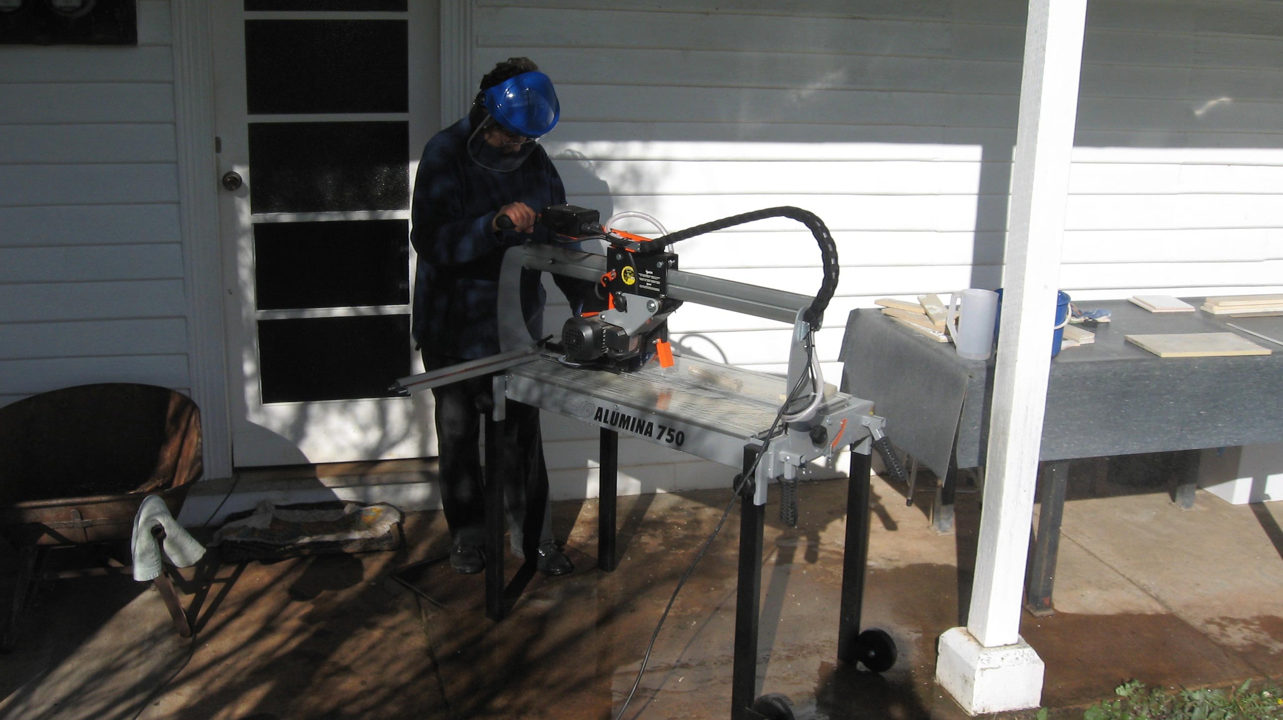

Re: Removing Rim From A Large Drop-pictures
Here is a picture of my tile saw, first practicing by cutting some old shelves.
Plus cutting a slightly larger vase.
Hope this is useful.
Cheers, seachange
Cheers, seachange
