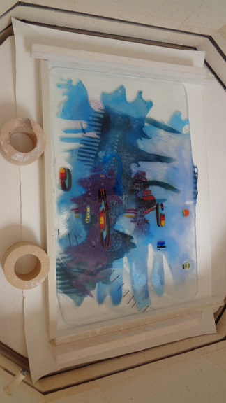

1. Here one can see how far the piece is from the kiln elements....
2. I have marked In black where the piece had broken....

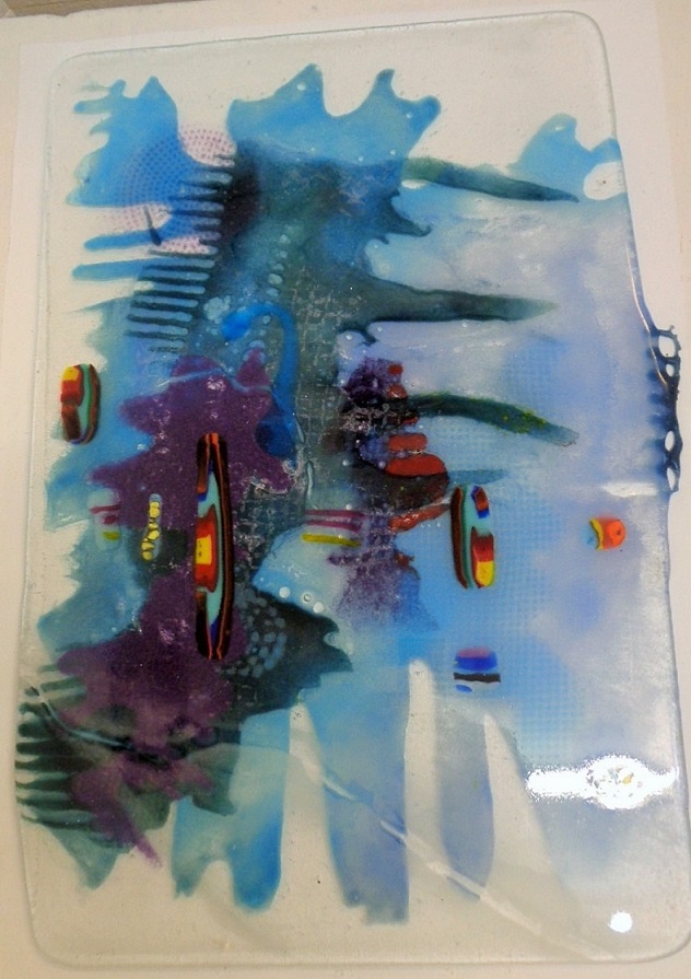

Re: TO RE-FIRE OR NOT TO RE-FIRE
Hello,
Please see the photo I put on my previous post.
After 32:07 hours I took out of the kiln ONE piece.... [quite an exaggeration in conservative schedule]
Of course I am happy, or shall we say satisfied, but still quite suspicious, I really do not know what will happen in a week time, or longer time or less time.
I also checked for stress , found none.
Thanks for your help and co-operation.
