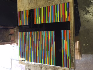

So I had a piece crack and I'm a little confused.
I was putting pieces together that were previously fused together. It seems like it cracked on the way up as the crack was partially fused back together. Strange that it wasn't totally fused back together as the parts I was putting together were fully fused.
My question is n schedule... How fast would you go up to temp? The piece was in total 16" x 16" about 1 centimeter thick or .39". I went up at 200 degrees an hour which is what I usually do. Is that too fast?
I'm sure it would be easier to post a picture... I'll have to learn how to do that.

Posted: Wed Jun 01, 2016 3:49 am
by Chris Lowry
This was the piece
Re: Help with crack
Posted: Wed Jun 01, 2016 8:16 am
by Marty
Your initial fuse of strips can be fast- 300dph- with a serious bubble squeeze around 1100.
Subsequent firings of a piece like that shouldn't be any faster than 100dph (up to 1000F) because of the thickness and the black part. Every time I think I can get away with a faster firing I am reminded that I can't.
