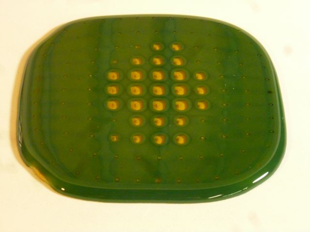

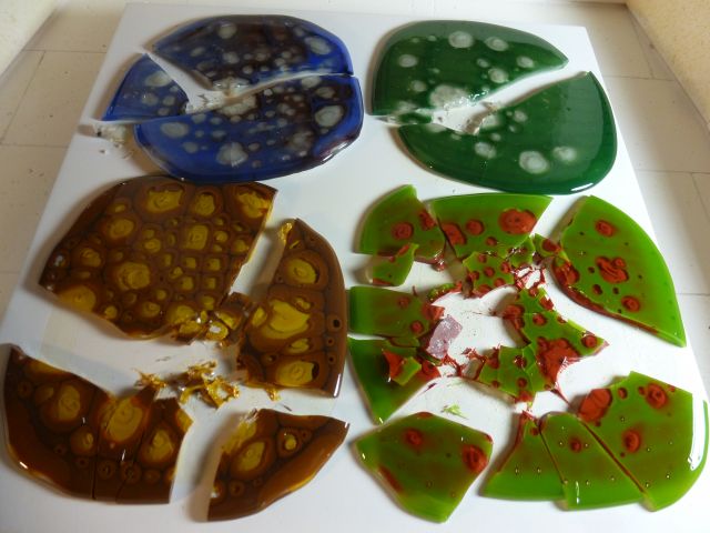

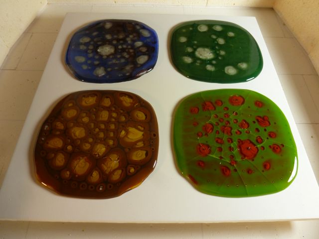

Two bubble-up firings. The first is fine and was slumped into a plate. Next was 4 smaller pieces on the same schedule. All have multiple cracks. The cracked one in the lower right is even the same glass. What happened?
Everything was the same except the size of the glass (7” vs 4 ½”) a different kiln shelf and I noticed the total time in the kiln was 8:02 vs 8:20 for the ones that cracked. Cracks are sharp so it happened on the way down, and some places are really stuck to the kiln shelf. Thermocouple bad? Controller bad?

No problem here

Disaster
Spread out

Probably not enough kiln wash. Most likely, sticking in some places.

I'm with Brad. Especially with a new kiln shelf, if the kiln wash is too thin (or nonexistent), the glass sticks and tears itself apart as the kiln cools. Are there bits of kiln shelf stuck to the bottom of the glass?

More kiln wash seems like an easy fix. My notes say I used 8 coats on both firings, but I have been known to be senile. I will try again and see what happens.

The experts were right. Not enough kiln wash. My notes say 8 coats of kiln wash, but my guess is I was distracted with something and picked up the wrong shelf. Thanks for the help. This BB may be one of the best "tools" I have.

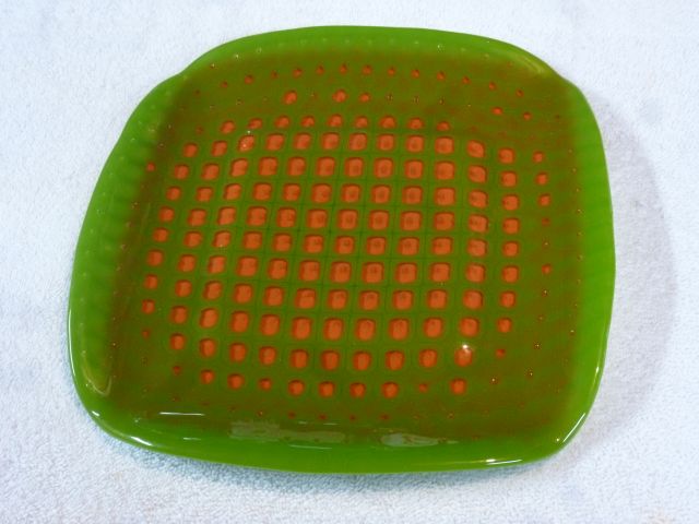

The latest with 8+ coats of kiln wash. No cracks!
