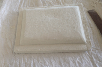

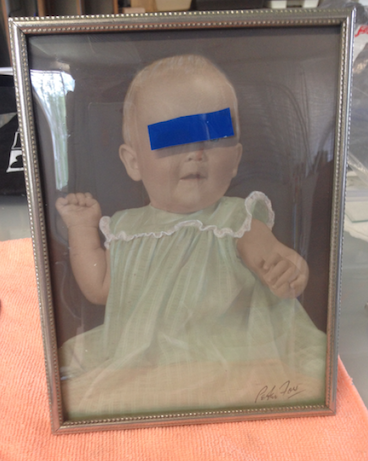

When the temperature cooled down I made a mold from a piece of old kiln shelf.
Mold made to slump picture glass.png (139.28 KiB) Viewed 25270 times
The glass is a piece of 2 mil (+/-) picture glass from an op-shop. I don't know if it was tin up or tin down. It was old so may not be float. It was cut slightly larger so it could be trimmed to fit after firing. It needed very little trimming other than the corners rounded off a bit.
The schedule used was:
1. 1050F over 2:00, no hold
2. 1100F over 0:30 held until it started to move @ 2:43 of program, watched until it was where I wanted it
3. 1000 AFP held for :20 mins
4.Off. Left kiln closed till next morning.
Can't believe it happened in one shot!
