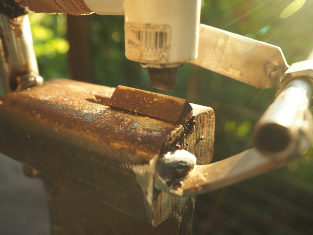

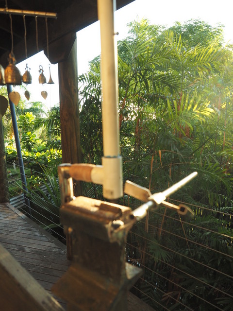

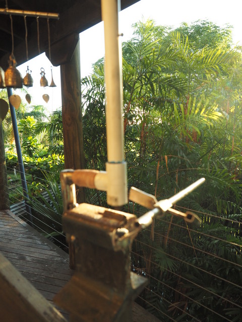

Re: Murrini
This is a work still in progress. Will be experimenting with the angle on base edge to see if a more precise end to cane can be achieved. I don't bother going too short but it's great for repetitive longer lengths. Making the base more acute will definitely have to improve the release of chopped piece, as sometimes this can happen. I can get a fair speed going. - haydo
