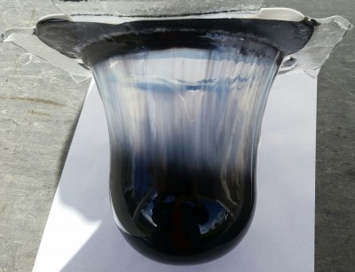

Hi,
I am trying to make a black/white drop vase as a gift.
The blank is 4 layers of 3mm BE glass, 5" square, starting on the shelf:
Tekta clear
white
tekta clear
alternating strips of black and white.
Fully fused to 804C 1480F. Due to the full fuse and no dams the blank spread out to 6 1/4" (this is ok, I am experimenting and learning).
Had intented to drop 6" using BE smallest mold (8633, inside diameter 3" 8cm). However, because the blank got a bit too big, decided to use the next size ring, 8632, ID 4.9" 13cm.
Reduced height to 5" props.
Added 1 1/4" wide strips of tekta around the blank, to avoid it falling into the mold. As mentioned before, I am learning so was not sure if the blank was wide enough to stay in place.
Blank placed on the mold with the top - the black and white strips layer - now towards the bottom, so it becomes the outside of the vase. The mold covered with a ring of fibre paper with the whole cut 1/8" wider than the inner diameter of the mold.
Don't know if this is really necessary, I get a bit of a rough surface on the outside of vase and wonder if this is from the 2mm fibre paper. Had used it once before (in another failed attempt at a vase). Saw in the BE video that they disposed of the fibre paper ring after one firing. Thought it wasteful, but may be it is necessary to replace it for every firing.
It took 4 1/2 hours to touch bottom. I hold at 680C 1256F until it is ready.

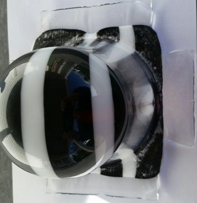

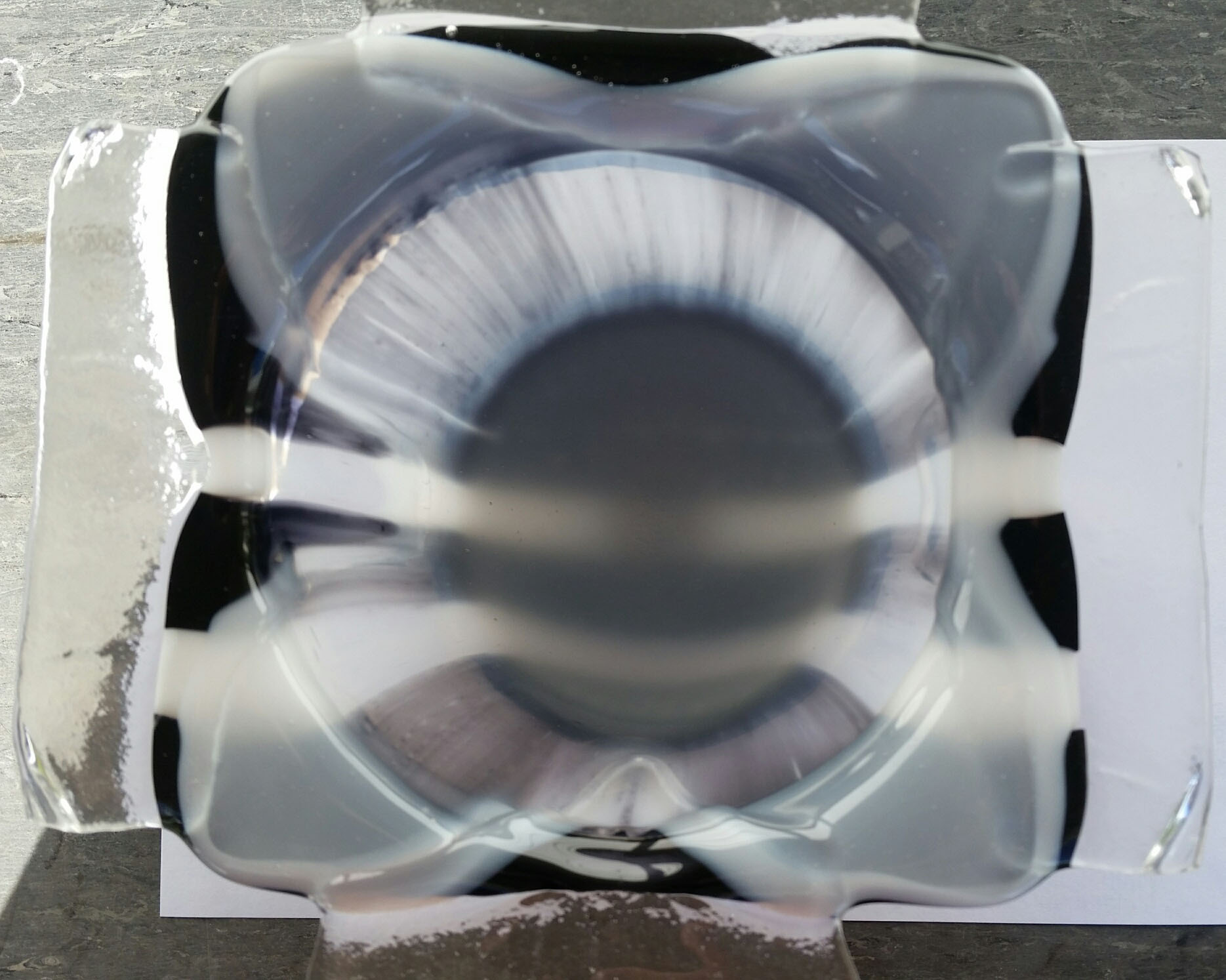

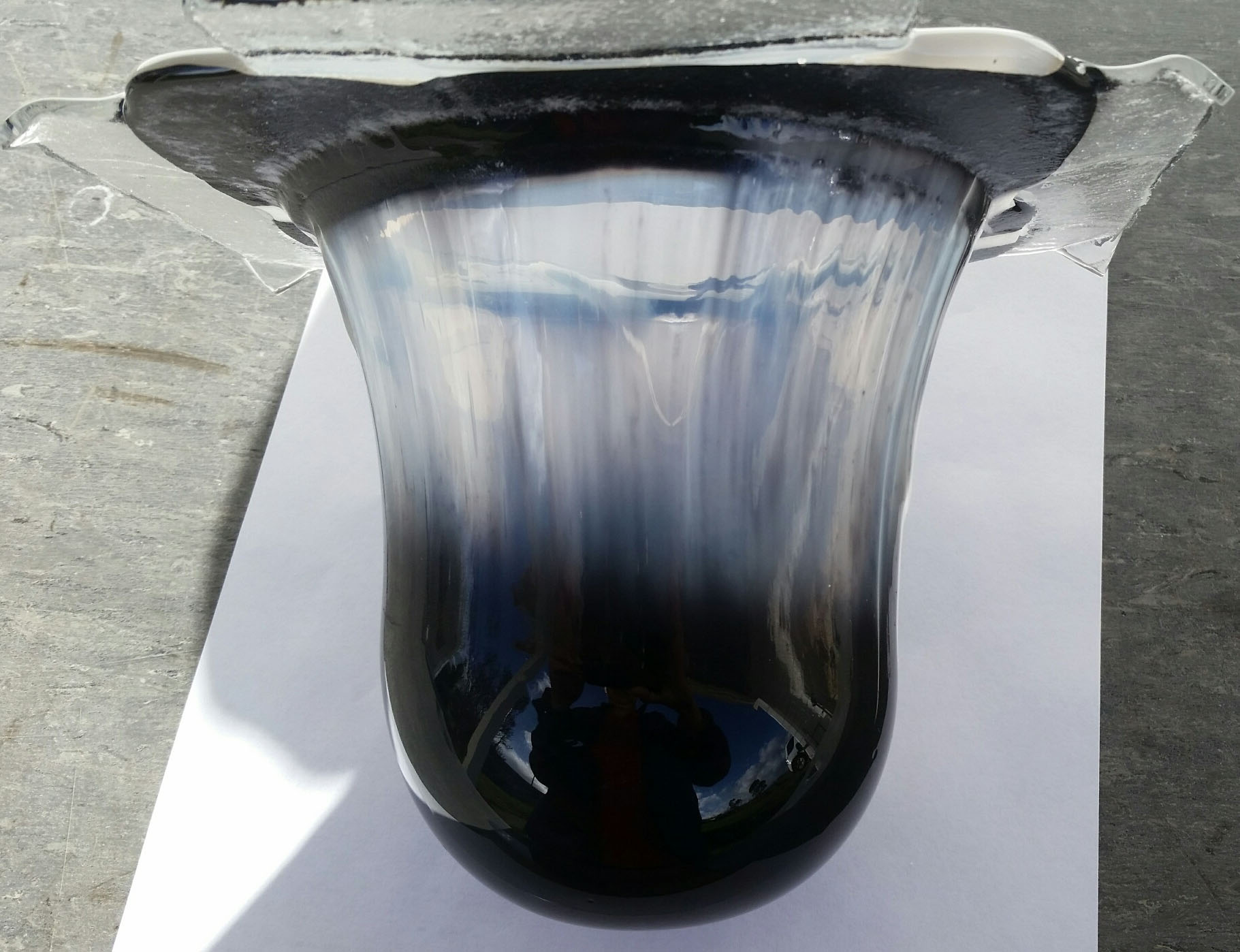

As you can see in these pictures, there is still enough of the colored blank remaining on the flat rim (to be cut off). I thought this should have been enough reservoir of color to get more intense black and white from rim to bottom, but the top half of the vase is very diluted and transparent.
Have seen in the BE video that the glass stretches more towards the edges (close to the mold), and very little in the center. But all my research on the web seems to show that blanks are normally fused from 4 or 5 even size squares of glass (not by piling little extra strips of colored glass around the area corresponding to the inside rim of the mold)
My question is: how do I get enough color density on the top half of the vase? I really have no idea how to move forward from here.

vase side - wide black strip on the blank

too fast a firing would be my first guess.
That is why the bowls that are steep sided are fired with 3 different molds over 3 different firings.
The other way would be to get the magic temperature in your kiln that will allow it to move downwards but only slowly.
Or much simpler, drape the piece over a mold and then deal with the folds and the usual problems of the base not being perfectly flat.
Then you have the choices of lapping it flat and or gluing on a base.
Not only have you got no colour, you have super thin glass on the sides..... :shock:
Use stiff black perhaps but then you could have issues with the white's viscosity and compatibility.

Regarding the firing schedule, I am using the top elements of my kiln only:
332F to 1256F . Takes 4 hours to get to 1256, and by this time it has already dropped close to 1". Then another 3 hours until it touches bottom shelf and flattens out a bit (i keep watching it).
I thought this schedule was a good balance between time spent and results. However it makes sense that if I have a slower firing then more glass will stay on the sides and the color will be denser. Perhaps dense enough. Will make another similar blank and test it.
Thanks, seachange

suggestion here.
try using bottom element only and heat to perhaps 1175 only.
rather than trying to get a large flat bottom be prepared to make a stand or cold attach a base to it. It will be more stable that way anyway.
as for the 1175 the glass may not start moving. You will have to figure out the time and temperature required to move the glass but slowly.
the problem is getting the flat base causes the upper thinning.
Draping it is far more efficient.
My 20 inch vases had inch thick folds around the lip but they were never thin.

I have taken Amanda's class, you'll learn a lot from her. I've made a lot of these since that class about 15 months ago. I have to agree that was probably too high of a temp, especially with black, since it tends to move fast. I've done quite a few with a similar setup, 3mm of color and 9mm of clear. I can drop them 9 inches and still have color saturation.
The one thing I didn't see in your post is whether the color was on the inside or outside (up or down on the mold). The side against the mold doesn't move as much as the top of the glass, so if your color was down, that could be why. I usually drop them far enough to just get a base started, then use my disk grinder to put a flat base on it, hence I don't want to grind the color away so I put it (generally) on the inside. But I've done it on the outside, and you do get a very different result, but never that little color, although I've never done black. But mine are typically 1mm, maybe 1.5mm after cutting off the rim, and I've never experience what I see in yours.
One other thing that I do, I just take the initial building of the blank to tack fuse temps - 1350, and hold for 10 minutes. Because I cut the rims off, I do a bubble squeeze from 1100 - 1250 at 50 degrees/hour, and I sift clear powder between the layers. This gives me very few bubbles, and what are there are very fine. And I have a 4.5 inch square. Bubbles in these drop rings can be a real pain with long, thin holes filling up with crud from finishing.
Oh, and Amada takes hers to a full fuse, but I like to do precise patterns, and 12mm of glass without damning just moves too much.
I really, really wish I could achive that :-k
Have reduced drop temperature to
182 - 1100 - 0
133 - 1250 - till drop
This is with same black/white blank, 4 layers total, 6" drop. Changed temperature only, to be able to compare. There are so many variables one could try, it is mind boggling.
Color saturation was better. I removed the top to check thickness of the rim, still too thin and fragile, mostly less than 1mm, in some places it is paper thin. Have made 2 more of the same blanks, but at present I feel a bit paralized with indecision, don't know what to change to improve the result
Oh. Never knew it could make a difference. This is very interesting - I am learning a lot. Yes, the color was down on the mold. My blanks are, from the shelf up, 3 layer tekta + 1 layer color. Or tekta, white, tekta, black + white strips.
I am fusing the blank with the color strips on the top because I trap bubbles in between the strips if they are covered. Also the white on top of tekta to avoid picking up kiln wash with the opaque color.
Although I have been working with glass for a few years, have never used more than 2 layers of 3mm transparent glass. Trying to get the blank right with 4 layers has also been - still is - a learning curve.
For the drop I am reversing the blank, so the black/white strips are lying on the mold. Imagined the color, being on the outside, would be more intense when one looks at it directly, instead of seeing it through the layers of tekta.
So, if I am working this out correctly, for the black white vase the blank could be, from the shelf up:
tekta
tekta
black+white strips
white
Then for the drop the tekta is on the mold, the inside of the vase will be white, and the black/white strips will be seen from the outside through the 2 layers of tekta. Will this be a better layout? I am personally not that keen on the black/white, but it is a wedding present to be delivered in September...if I can get it right 8-[ . At present I am going through the glass like if it was water running through my fingers. It will be a very expensive gift.

I am making a bit of progress, mainly by changing which coils I am using for the firing, it seems to be working much better. Do not quite yet understand why, but I will give some details in another post a bit later this week.
Will make a few more tests and see if the better results are consistent, not just a bit of luck.
Best wishes, seachange.
