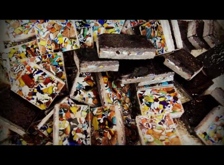

I have troubles in edge fire polishing
I use murano glass. I make plates in first firing, then i cut in small pieces with dish saw and the edge stay rough
Then i need to firepolish the edge in a new firing
I tried some times but the edges stay opaque? Maybe any help from antidevit on the edge? Maybe something wrong in the schedule?
Any help will be appreciated

My.schedule is
0-550 30 min
550 soak 15min
550-690 asap
690 30 min.
690-750 asap
Stop
I also tried to brush The edges with spray A but nothing
After cutting with saw i also try to use grind with a b dry belt to get less rough but nothing
Any help?
Thank you
