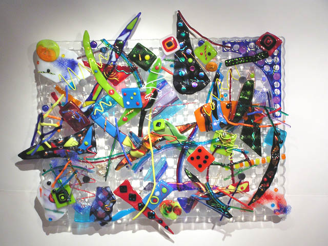

Hi all, I have fused and 40" x 24" piece, the base double thick clear. There are many added elements fused flush, but there are large areas that are just the DT clear without additional glass. I later tack fused some additional elements on, and they are 3 or 4 mm thicker than the 3mm base of the glass. The glass is well- annealed for hours. This will hang on a wall. Should I be concerned that the 3-D pieces were not fused down long enough to even out the thickness more? I just don't want the glass to go into thermal shock, or be fragile. thanks!

Assuming you annealed properly, you shouldn't have a problem.
Re: thicker and thinner together- ok?
Brad is right, and remember it is not just the annealing for hours, but the cool down is critical. A lot more stress is added with uneven thicknesss.

Yep, took most of the day to cool that puppy down. Then it just sat in the kiln for 3 days.
Thanks so much, what a relief! (pun intended).
