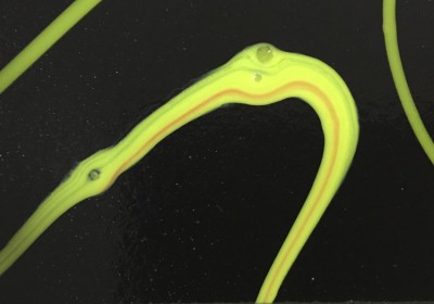

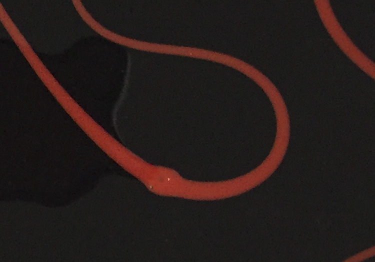

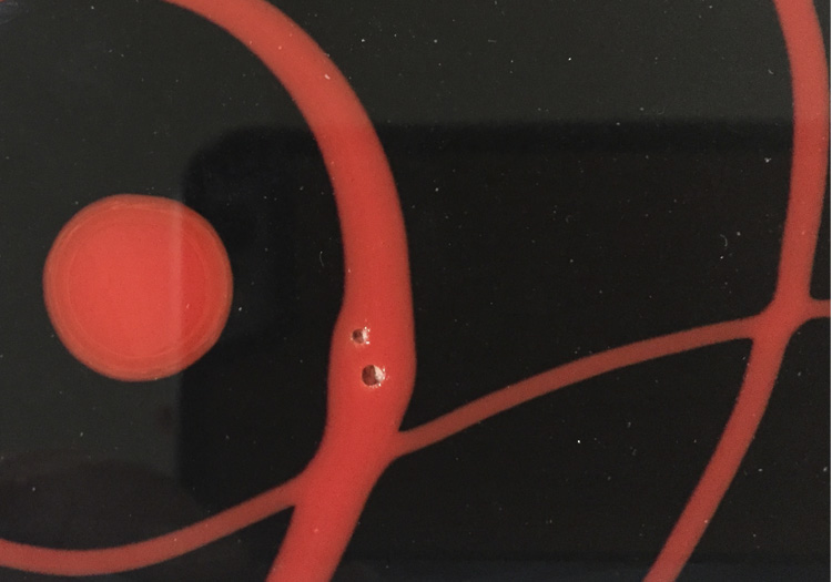

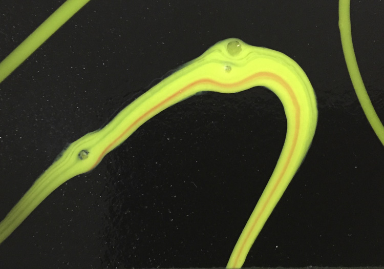

Hi Brad, thanks for your help on this. I've added three photos.
Photo A (green), done about a year ago, shows what happens on my initial full fuse firing of vitrigraph to a sheet of glass. This kept occurring, so I stopped at that time trying to make vitrigraph work. But, I like what’s possible with vitrigraph and know other use it. I haven’t read or seen others discuss this issue, so I'm not certain why this is happening and it may be as simple as a result of the schedule that I’m using. Photo B shows a recent piece, this one is subtle bubble, but often the subtle bubble becomes a problem on the next full fuse when I add design elements to the piece. Photo C shows the craters that opened up on the second firing — I’ve cleaned out the holes and will fill them in with fine frit of the same color and fire again — this does not always work out well — the color isn’t always a perfect match and ends up looking like a patch job. Ideally, I want to work with vitrigraph and not have the bubble/crater issue do deal with at all. Thanks again, Brad, I appreciate your feedback.

Glad I asked to see photos.  Before you posted them, I had thought you were talking about bubbles trapped between the stringers and the glass underneath.  But from the photos it looks like the bubbles and craters (which are popped bubbles) are actually in the stringers themselves, not in the area between them and the glass.  That would suggest the bubbles are being created in the process of making them in the vitrigraph kiln, then becoming more noticeable during the subsequent firing. You haven't talked about how you make the stringers, but I do know that if you fire the pot too quickly you can get trapped air bubbles in the stringers.  Is there any chance that that's what's happening?
