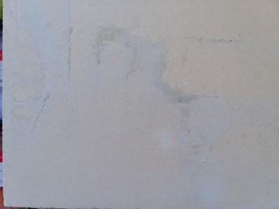

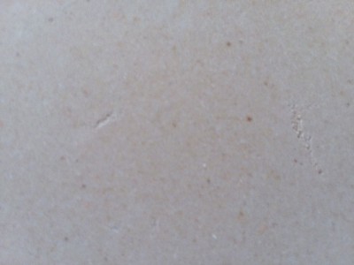

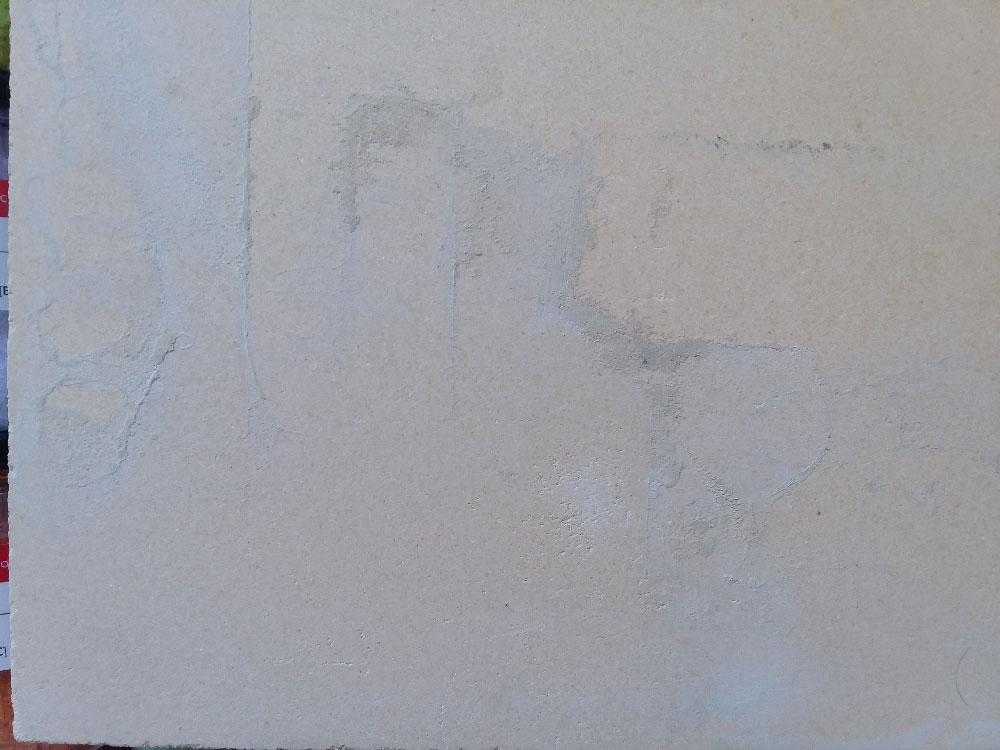

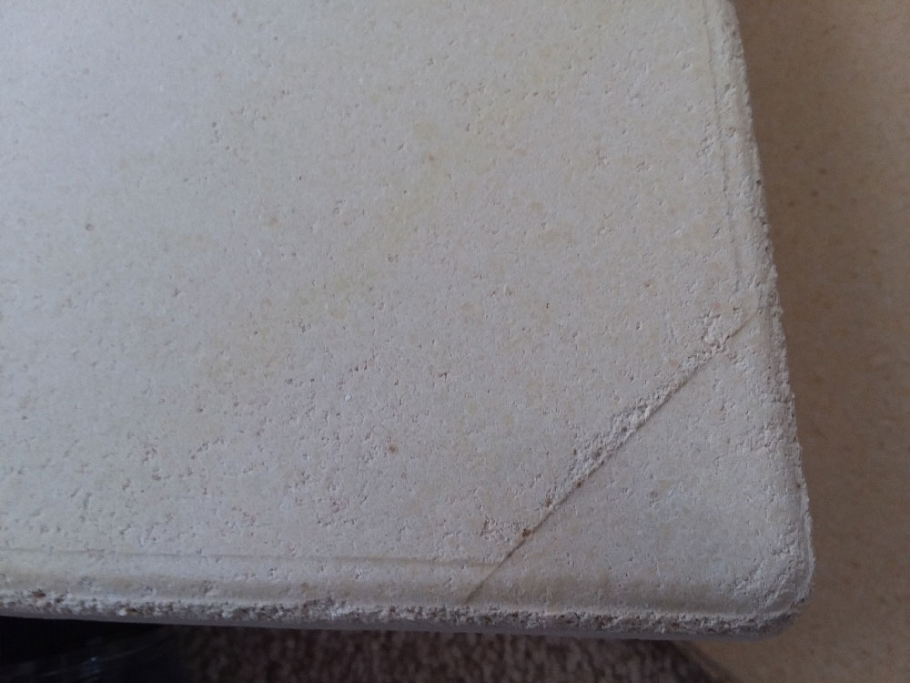

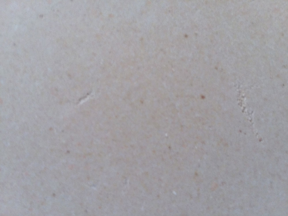

This is a new problem for me after 12+ shelves. I order some from one place - 15" shelf has a depression about 1 mm deep, in about a 4" swath running from side to side. Other side has blobs of clay on it and squiggles and scratched in the face probably 1 mm deep. Ditto (squigly/scratches) on the 13" round I ordered for the new kiln we just received for the wife's b-day. BOth sides. They (The Ceramic SHop http://www.theceramicshop.com) are fighting against giving me even part of my money back. So in meantime I figure I'll order from somewhere else. Oh dear, these are even worse - not only deep scratches and caked with filth on one side, but there is a 2"(short side) triangle about 1 mm deep, on one corner of both sides of the square. The round was worse than the other one - no wash in the world could fill those pits. What the!

Go to a large pottery supplier in your area.
Ask when they are getting a new shipment of shelves.
Physically go through and sort out the shelves you want to buy.
The reason there are scratches in them is because 'the best' kiln shelves come from England in wooden crates packed with straw. If the straw shifts, the scratching can occur.
You have to look through the crates before they are casually unpacked by pottery type people. Potters do not worry about small scratches.
I got perfect mullite shelves that way.

Most of the shelves in my area are from Mexico, not England. I one went through an entire shipment of shelves and was unable to find a single one suitable for fusing. You're right that pottery people don't care about scratches, and unfortunately most shelves are for pottery people.Kevin Midgley wrote:Go to a large pottery supplier in your area.

Just fill the divots with thick Bullseye kiln wash.
Scrape or sand smooth any way you figure will work but wear a dust respirator.
Then once smooth, coat the entire shelves as per usual and fire as per normal.
Helps to do the filling while the shelves are warm as in slightly above boiling temperature so they dry completely.
As for the shelf company not wanting to talk to you, given that pretty much all shelves come that way from the manufacturer so they have no control over what they get to sell, I might also stop talking with you.
The time you spent squawking about defective shelves could be better used to fix them and make glass.
However it certainly is a PITA.

Appreciate the thoughts Kevin but I have lots of shelves without these kind of nasties in them - and accepting these would mean I have to do this patch-up dance for the remainder of the shelve's useful life. . . . And thickly built-up kiln wash areas are highly prone to coming off and lodging into the glass piece. The one with 4" wide swath that is 1 mm lower than rest of board can't be leveled with wash. I don't believe in putting wash on a warm, porous item since the human hand is an extremely poor measuring device for temperature and there is no point in potentially thermally shocking and cracking a shelf or mold. Much safer for it to be applied cold and brought UP to temperature (candled) imo.Kevin Midgley wrote:Just fill the divots with thick Bullseye kiln wash.

Update - we agreed on a refund amount, I will chop them into dams,etc.
