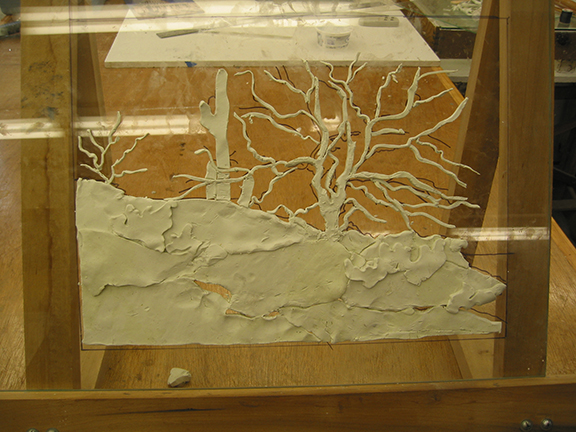

I will be doing some frit casting for a largish stained glass piece. It will be tree limbs. Lots of limbs. I have done this before by making a clay positive: Roll out the clay into a thin tile, cut out the tree limbs, cast the thing in plaster/silica, then use the plaster mold for frit casting. One and done. It's a lot of work. I was wondering if instead I could throw money at it? Can I buy some sort of refactory product into which I can carve out the tree limbs in relief, coat with kiln wash, and then cast frit into? Or can I cut out tree limb shapes with a razor knife out of some sort of blanket and cast into the cookie mold onto the kiln shelf? I'm looking at my bookshelf and thinking that somewhere between Lundstrom, Halem and Walker I could probably find some suggestions. But I've typed this much, so there it is. I'll look through Brad's book and If I find anything, I'll reply.

Here's an example from ...my god!, sixteen years ago! It's a pain in the neck and I don't need to worry about the texture of the surface, I can paint the textures I want.

Sounds like a cool project. Are you looking to cast just the tree limbs? Your 16yr old photos show what looks like some landscape included with the trees. Assuming just tree limbs.
