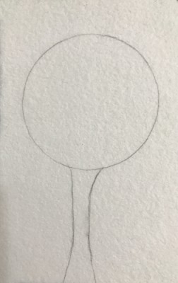

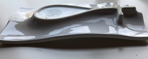

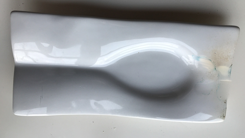

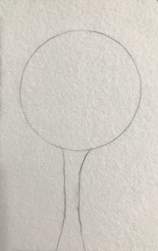

I'd like to use 1/4" fiber felt to make a custom drop mold, which would create a spoon rest. Looking at the ceramic spoon rest that I currently own, it looks like I should make an oval and then a long slot that goes all the way to the edge.
Here's the ceramic spoon rest And here's my crude sketch on fiber felt of the cut I would make (it's a circle rather than oval to match the glass design) All the drop molds I've seen are symmetrical and have no cuts through any edge. So will this work or will the glass just run out the open end?! I realize I could just retain the closed edge and it would probably still work as a spoon rest but I am interested in the question of an open end anyhow.
Sorry if this is extraordinarily dumb.

Hi Judd,
Sorry I wasn't clear. I'm not slumping a bottle. I'm slumping art glass.
I fused two layers of art glass and now I want to make a spoon rest with it by slumping it through a custom mold made of 1/4" fiber felt, on 1/2" posts.
I can make the drop mold with a round spoon shape and a long slot for the spoon handle, and I can just end the slot before the edge of the mold. But I was just wondering what would happen if the slot for the spoon handle continued all the way through the edge of the mold.
It's really a general question about molds with an opening on one edge - whether that's possible or if the glass would slump not only through the mold opening but out further than the edge of the mold.

				Peter McCarthy
- Posts: 19
- Joined: Wed Feb 22, 2006 10:48 am
- Location: Cambridge, MA
Re: Drop mold for a spoon rest (open end)
There's a simple solution to that potential problem: Make the mold longer on the open end than the glass you'll be slumping.
				Ed Cantarella
- Posts: 155
OP - if you have only fused 2 layers of 3mm glass, there is no problem to the handle "groove" extend out past the glass.  The glass is not going to travel down it, due to the 1/4" rule. 2 layers are 1/4" thick.  Glass travels outward if thicker than 1/4", inward if thinner.  I'm curious if you are planning on using ridgidizer on the cloth followed by kiln wash.   Gonna be rough without and only one time use.
