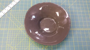

Had an issue with slumping a bowl made from Spectrum 96 glass. We always use B.E but had some of this still around and wanted to try slumping a larger bowl. Have been fusing for just over one year.
Slumping Program used is as follows fired in EvenHeat Studio 24 Kiln
400F 1265F :20min
AFAP 900 1:00hr
150 700 :00
The glass is 6mm thick and consists of a dark grey and one of Spectrums speciality glasses. There were no numbers on the glass and purchased from the only store in Fairbanks that sells fusible glass.
It was cut into an 11" circle and fired. The black spiral glass was fired on top and had no issues. The gray that was in contact with the thin fire had some spots that looked to have trapped some of the paper. I sandblasted it with AO-120 and washed with soap and water then alcohol before slumping. There doesn't seem to be an issue with the grey finish after the slump.
The piece was then put into B.E Classic mold #8723. It was centered perfectly and then fired to above schedule. The bottom picture shows it somewhat, but the bowl is out of round by a good 3/8". I am assuming that the glass shifted while it was firing. I have since read on this site (suggested by Brock) that it helps to put a small bevel on the glass that is in contact with the mold to prevent slippage. I will do this from now on.

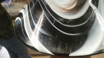

The other picture hopefully shows well enough the other issue with slump. The glass looks to have small stretch mark and a hazing (devit ?) on the surface that came into contact with the mold. I am not sure if the stretch marks were caused by slumping too fast? As for the hazing, I am not sure what the cause of that is.

My slumping schedule is more conservative. I've had issues with uneven slumping and slowed way down. I'll ramp @ 300 per to 1100 and hold for 20 min to ensure an even soak then ramp to 1250 @ 50 per. No issues to date. Also, make sure your kiln and shelf are as level as can be.

The bevel that Brock suggested was to enable the glass to slide on the mold rather than get hung up and cause the glass to de-center itself.
As for the glass, use Bullseye :D
More seriously some glass will because of its formulation to create the colour being used, will have a 'personal interest' in devitrifying. They are the glasses that want to stick to the kiln wash or whatever else they are sitting on in the kiln. Rarely clears but always opaque glasses.

200 dph to 1200, hold until slumped (look at it), then drop to 900 etc. No need for elaborate holds at 1100 etc.
Each mold will fill at a different time/temp.
Trying to flatten that piece will not give you joy. I'd give it away and start on the next one.

Bullseye's recommended schedule for that mold is 300dph to 1225 hold 45 minutes. 1265 is probably too high, especially with Spectrum glass. That can cause the problems you experienced.
Like Marty, I would prefer the hold at around 1200 for however long it takes. You only have to watch once, keep notes and you won't need to watch again.
You'll probably find it quicker and more satisfying to just make another one rather than try to flatten and refire.

Wrangell wrote: The bottom picture shows it somewhat, but the bowl is out of round by a good 3/8". I am assuming that the glass shifted while it was firing. I have since read on this site (suggested by Brock) that it helps to put a small bevel on the glass that is in contact with the mold to prevent slippage. I will do this from now on.
Having a raking tool(just the simple L-shaped stainless steel poker is fine)you are frequently able to gently poke and pull a piece back onto center between 1000-1250-ish.

You state that there was no number code on the glass. I do not recognize this as a "96" color... Because there is so much Spectrum out there that is not tested fusable I would suggest this glass is not "96".

Since this was one of her projects and not mine, she said there was not a number on the glass. Come to find out the 96 did have a number (OA/3005-95F Opal Art) Have been telling her to keep really good notes on each project but that's a bad subject.
All the glass that I use is B.E and now pretty much the same for her. As mentioned before, we have very little 96 and trying to use it all up. So to address Don's comment, it is fusible 96 glass. We even went to the store where we purchased it and confirmed this.
Been working on learning the Leatherbarrow crackle and pebble techniques (thats a whole other Topic) so haven't flattened the bowl yet.
One other question. Would it be a good idea to sandblast the devit piece before slumping or just see what happens? Was planning on sandblasting it as it only take a couple of minutes to do so.

Sandblast it.

But seriously, you might want to consider getting rid of ALL your 96 glass if you fear this will be a repeat problem - there are always ebayers looking to buy small, odd lots. I bought a used kiln about 5-6 months ago that came with easily $500-600 of COE 96 frit and sheet glass, and we are strictly 90. Sold it all to avoid this issue . . . Ditto with our old stained glass stock - people making mosaics love buying a 5-10 lb box of chips for $5-8/lb.
It's great you have a sandblaster - what Brad said.
