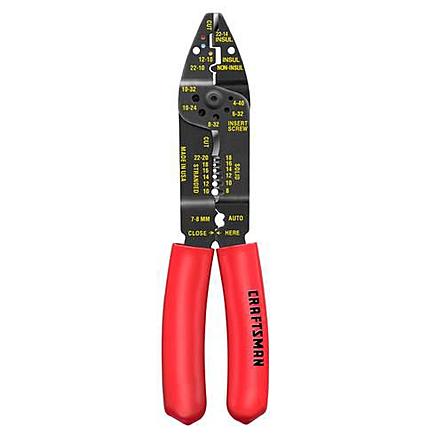

What is the proper tool to use to crimp element connectors? Once again I connected the new element with really crappy selection of tools...It can't be that hard. Help!
This kiln is an Olympic coffin kiln and it's always hellish...And the Skutt is tough as well. I asked Olympic what they used but the contact there had no answer...

The single purpose tools are awfully expensive. I just bought some butt splice terminals from these guys, and they sell the fancy tools. I'll use my el cheapo electrical stripper pliers to crimp them
https://crimpsupply.com/tools/crimping-tools
