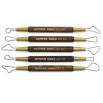

Mike, I use what are known as "ribbon tools" for carving vermiculite board and I also use them a lot on clay. On clay they are nice as they remove clay, not just push it from one place to another like solid tools would do.
Like these.
