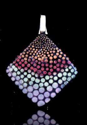

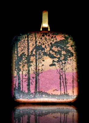

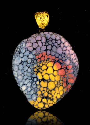

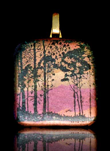

Re: HOMEMADE IRIDIZING?
Gold Silver copper bronze and red have pretty good staying power when fused up to near 1500.
Green, purple and blue are very finicky. We use interference colors for those. They use light diffraction (particle size)to create the color. Their stability goes up close to the metallic colors.
