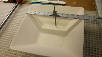

While most of our molds are B.E., we ended up buying some molds on eBay from someone who is getting out of fusing. This mold was kiln washed but never used.
It is not a BE nor does it appear to be a slumpys as far as I can tell from research. The mold measures 12" at the top and the sides are 45 degrees with the bottom base of the mold being 5-1/2" square. It is fairly thick (7mm) and seems well made. Since there were no holes, I did need to drill 4 vent holes in the bottom corners where glass will touch down last.
Am wanting to slump a 9mm thick piece into this mold so so since the piece is only 9" x 9" it is not dropping the full distance. With that said, the 9" square has to drop 2" to reach the base. I have read on other posts here that slumping into deep square molds you can end up getting a dogbone affect. Would rather not practice on this piece as it is combination of B.E French vanilla, Dense White with Cyan sandwiched in between these two. Here is the schedule I am thinking of using..

I believe I have this mold. Mine has same measurements, and it is 4" deep. If you post a picture, I can verify.
After several practice firings, I have successfully used this mold with 6mm thick bullseye glass. I have started with 6mm thick pieces anywhere from 10"x10" to 12"x12", and have never had them slump unevenly. Just have to make sure the glass is level in the mold before firing- use a level. Some dogboning does occur due to the shape of the mold(square steep sides). Sorry I don't have a picture of any of those pieces.
Square mold resize.jpg (8.86 KiB) Viewed 10078 times
Thanks Wendy. This mold is 3-1/2" deep and 12" square. Will probably try a 6mm thick test piece when I go to use the mold. I ended up doing something else with the 9mm thick piece. Cut the square 10" x 9" piece into a 8-1/2" circle on the wet saw and then slumped it into the BE Classic round mold #8723. It turned out pretty well.
I did remember about the firing issues with the Dense White at certain temps. It turned out good. Will post a photo on another Topic as it raised a few questions.
Back to the square mold. It is a really nice size and I will try to figure out slumping into it the advice from you and Brad.
