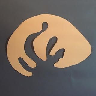

Hello friends,
Happy Holidays, Happy New Year
I want to make a piece , whose contours on one edge are completely curved. I want to do it strip-fusing.
It must be dammed, but I am not sure I know how.
I was thinking of making a dam from 1/2" fiber board. But I know that this thickness of fiber board is insulating, and probably will cause a thermal shock at the edges of the piece. It happened to me once...
Is there another suggestion???
I'd be more than grateful to consider.
Many thanks in advance,

I would cut it out of Ceramaguard, but I'm not sure that's available in Israel.
Second choice would be to use long strips of 3mm fiber paper, which can be wrapped around the dammed area several times, then secured with lots of small kiln posts and strips of cut up kiln shelf.

Thanks, Brad
We get cermaguard in Israel, this was my original idea, but my experience is that cermaguard works as an insulator, therefore may cause a thermal shock.
So was thinking to put between the c.guard and the glass 3 m'm fiber paper. [like what you say above]
Do you think that this would be the better way?

If your concern is thermal shock then my approach would be to really slow down your firing ramps below 1000F so the glass has time to heat and cool evenly regardless of the dams.

I fuse up to 12 layers (1 1/2") fully dammed ... I ramp at 200F up to bubble sqeeze... never had thermal shock.

In order to get a nice rounded edge on top layer edge corners your glass, contact with dam must be about 1/16" above dam. This is easily accomplished using 1/8" thick fibre around inside of dam. If your dam is higher than glass you will get needlepoints at top edge corners) If you are just doing 2 or 3 layers you could eliminate the thicker dam and just plot out your shape with the 1/8" fibre pinned to shape (shelf must be fibre or vermiculite to accept pins) Done carefully this should turn out 100%. Good luck
