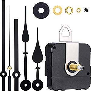

AndyT
Posts: 170
Location: Medford, Orygun
Re: Wall clock - how to hang
Post by AndyT »
Many clock mechanisms look like this.
Posts: 774
Post by Kevin Midgley »
bend a piece of metal and make the missing hanger to go behind the clock hands.
