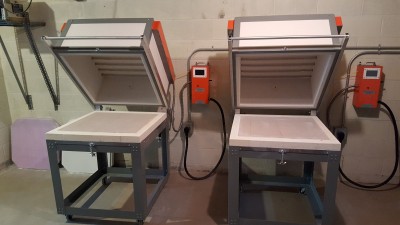

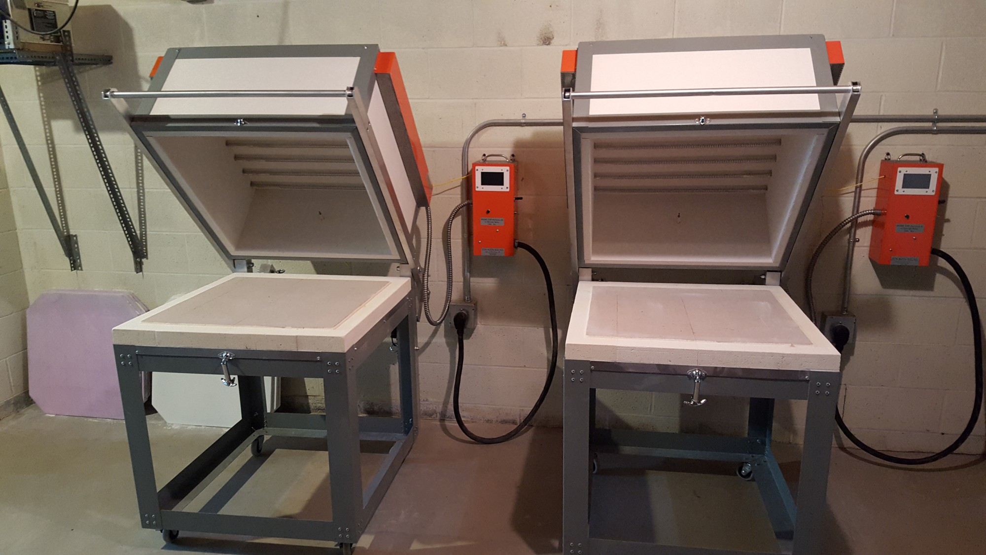

I owned a Nabertherm GF240 fiber kiln for nearly 10 years.  It performed flawlessly, required less electricity than a smaller brick kiln, and was my go-to kiln for larger projects.  Nabertherm is German; the kiln has fiber sides and top, with a brick floor.  The fiber is rigid, not blanket. I eventually sold the kiln to someone who still uses it today.
There are many European kilns that are similar in construction to the Nabertherm. The British made Kilncare, for example, is also a well made fiber kiln that is durable and dependable. I've not owned one, but I've been impressed with my experience using them when visiting the UK.
I'm not aware of any fiber kilns made in the US that are as well constructed as the European ones. Of the major US kiln manufacturers, most concentrate on brick kilns. The main exception is Jen-Ken, which does offer a line of fiber kilns.
A little over a year ago I purchased a Jen-Ken ProFusion 26. It's smaller than the Nabertherm I owned, but is similar in that it has fiber sides and top with a brick bottom. I really like the kiln and prefer it to similar size brick kilns I have owned. It takes less electricity, can heat faster, and also cools faster. It's also much, much lighter than a brick kiln, making opening the lid a joy rather than a pain. The main concern I have with the kiln is that I can't say how durable it will be. It has given me no problems for the year or so I've owned it, but for the long run I am concerned that the fiber on the outside is exposed. Although it fairly rigid (not fiber blanket), it isn't protected by stainless steel like the European fiber kilns. The jury's still out on durability, but I'm optimistic that it will last at least as long as the brick kilns I've owned.
All in all, I've had good experience with rigid fiber kilns with brick floors. If I did buy all brick kilns, I'll have them constructed with fiber lids and elements in quartz tubes (to avoid brick dust falling and elements drooping from the top). Right now I have a mix of both kinds of kilns, but if I were starting a studio today I'd lean toward fiber with a brick floor.

I have 2 Jen Ken Profusion 26 kilns. I bought them  over 2 years ago and have had no problems. However, after the first firing one developed a small crack in the exterior side panel (only on the surface). They sent me patching material to fill the crack ( the same material as the fiber) and it's been fine since. I bought the tap controllers and the mercury relays.

Wow!  Brad, that Nabertherm is one heck of a beautiful kiln!  I contacted a US distributor and learned they no longer sell to individuals, just schools and businesses.  Probably for the best, as I got the impression it was going to be outside my budget comfort zone
