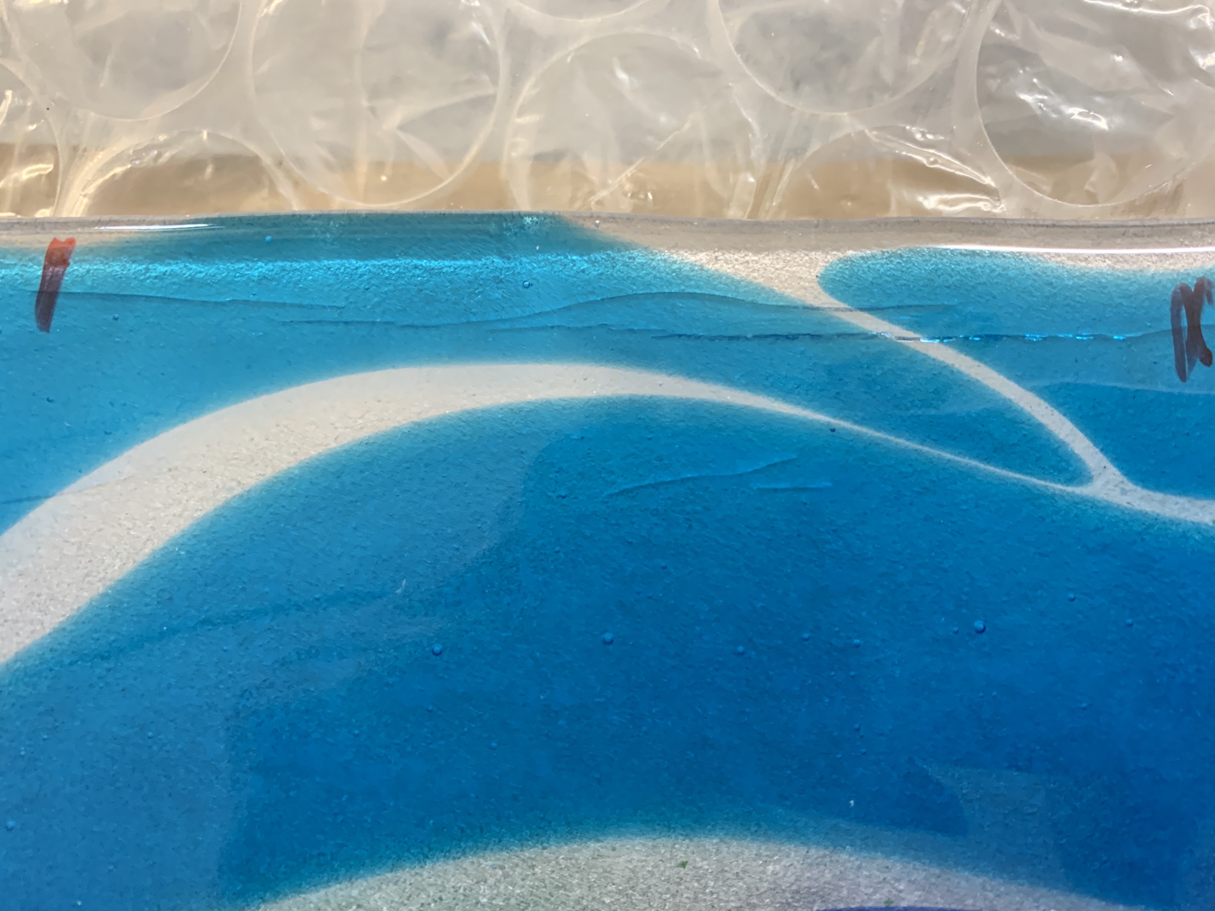

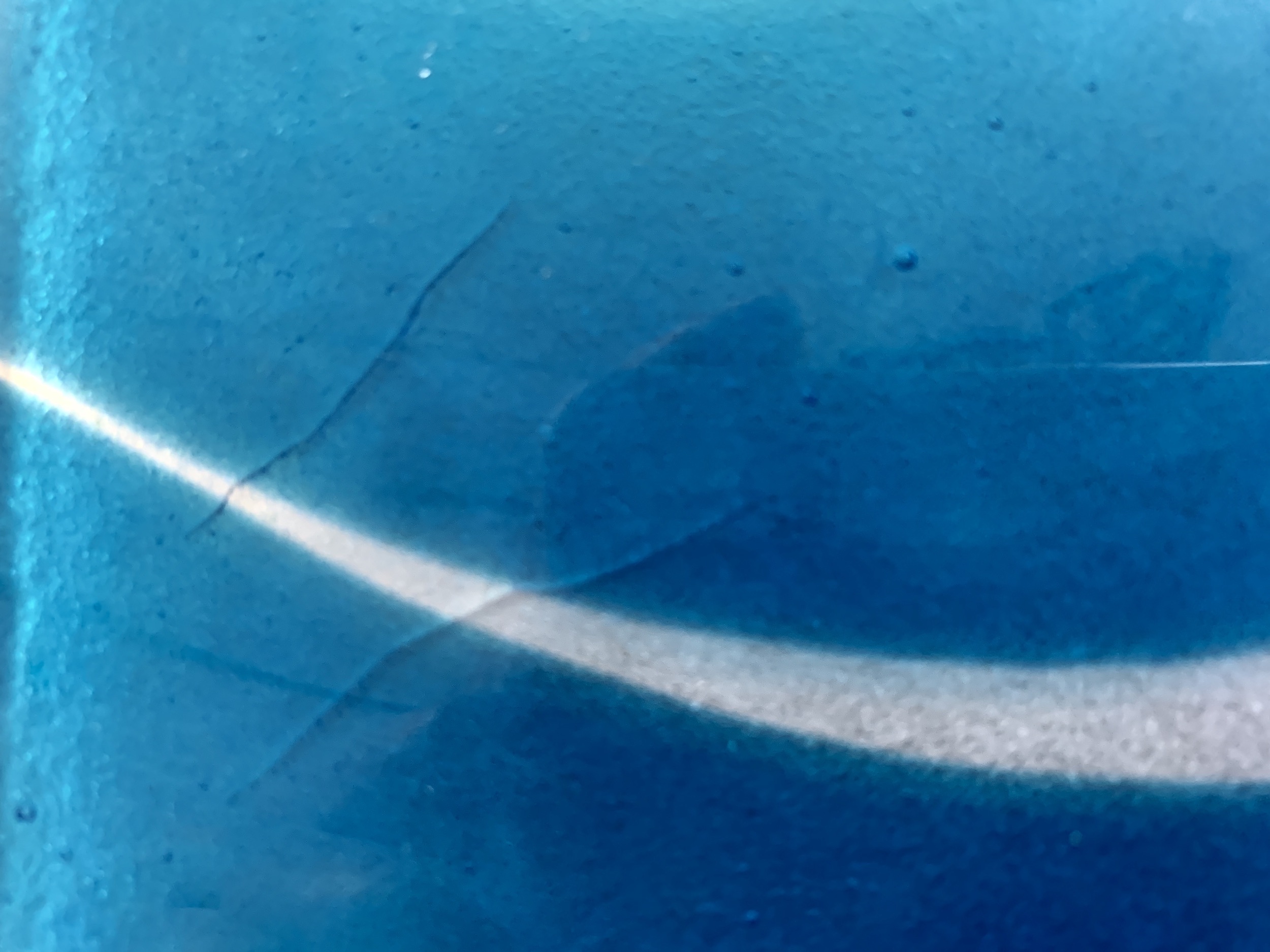

Hi Fusers,
Sad day. I made a beautiful 41' X 25" flat mural: Wissmach 5mm base, and 1-2 layers of Oceanside 96 glasses on top. Slow rise and 6 hours anneal. I've done this size many times, but always with just Spectrum/Oceanside.
I did grind down the corners a touch after fusing (diamond bit and water). But never had a problem grinding. Next day- I noticed fractures appeared on one side near one edge and corner. Out of the blue!
I was sad, and re-fused over 3 days, and the glass cured beautifully..(or so i thought).
3 days later, fractures started popping up. They are not cracks that go all the way through the glass. Internal only. But I DO NOT trust them at all. They are growing in number and size as we speak, (seriously).
Is there a potential compatibility issue between Wissmach and Oceanside that anyone has heard about?
I can not figure this one out. I can only assume I need to use only Oceanside, as I have always done.
Thanks for your input!
Bonnie :(

Bonnie Rubinstein wrote:Is there a potential compatibility issue between Wissmach and Oceanside that anyone has heard about?
Yes, there is. There's also potential incompatibility between Oceanside and the old Spectrum System 96. And with Youghigheny Y96. And with any other COE96 glass you can think of.
There's more to compatibility than coefficient of expansion.
Bonnie Rubinstein
Posts: 235
Location: River Falls, WI
Re: Fractures appeared!
Post by Bonnie Rubinstein »
Wow.
If that is true, I am in huge trouble. When I heard Spectrum was closing, I bought quite a bit of it, not knowing Oceanside would continue the manufacturing.
Why would Spectrum and Oceanside not be compatible? I assumed they were using all the same technology and formulas.
And Brad, can you elaborate on 'more to it than coefficient compatibility? That is really disconcerting!
(and The distributors I have spoken with seem to say the Wissmach and Oceanside are compatible) How off are they!
Bonnie Rubinstein
Posts: 1536
Bonnie Rubinstein wrote:Why would Spectrum and Oceanside not be compatible? I assumed they were using all the same technology and formulas.
Similar (not necessarily same) technology and formulas, but different manufacturing facilities, different countries, different levels of experience. It's really hard to make consistently compatible glass. Each manufacturer tests vs the product they're making, but almost no one tests vs products from other manufacturers (past or present).
In most cases, the laboratory test for measuring coefficient of expansion measures the difference in expansion between room temperature and 300C/572F. That's fine, EXCEPT that we fuse glass at a much higher temperature, one well out of the range of that measurement. The expansion above 300C/572F is at least as important (if not more important) than the expansion below that temperature. Expansion at higher temperatures can be several times greater than expansion at lower ones. And, to make things more difficult, it's not necessarily a linear relationship.
Add to that the fact that another factor -- viscosity, or the runniness of a glass at a particular temperature -- is also important in making compatible glass. It's possible to have two glasses with the same COE but different viscosities be incompatible. The glass manufacturer needs to take viscosity into account; it's the combination of the two factors that matters.
As an example, Bullseye clear 1101 has a COE of 91, while their white 0113 (which has a very different viscosity) has a COE of 88. Yet they're compatible because the manufacturer has taken steps to make sure they work together at FUSING temperatures, not in the range of the COE test.
Your experience proves that that's not always true.
As a general rule, I like to find a manufacturer I trust and depend on them to make sure the glass is compatible. If I use glass from another manufacturer, I always test first to make sure the two glasses are truly compatible.

I assume the fractures will become real cracks (?) and not stay internal in the glass? I haven't experienced this before...
Bonnie Rubinstein
Posts: 1536
Over time, that usually happens.
I have deliberately fused Bullseye and Spectrum S96 glass together and watched the piece fall apart over time. First, you see nothing, then a crack appears, then it spreads, and eventually the piece breaks. This can take years and years, or it can happen overnight, depends on how bad the incompatibility is.
