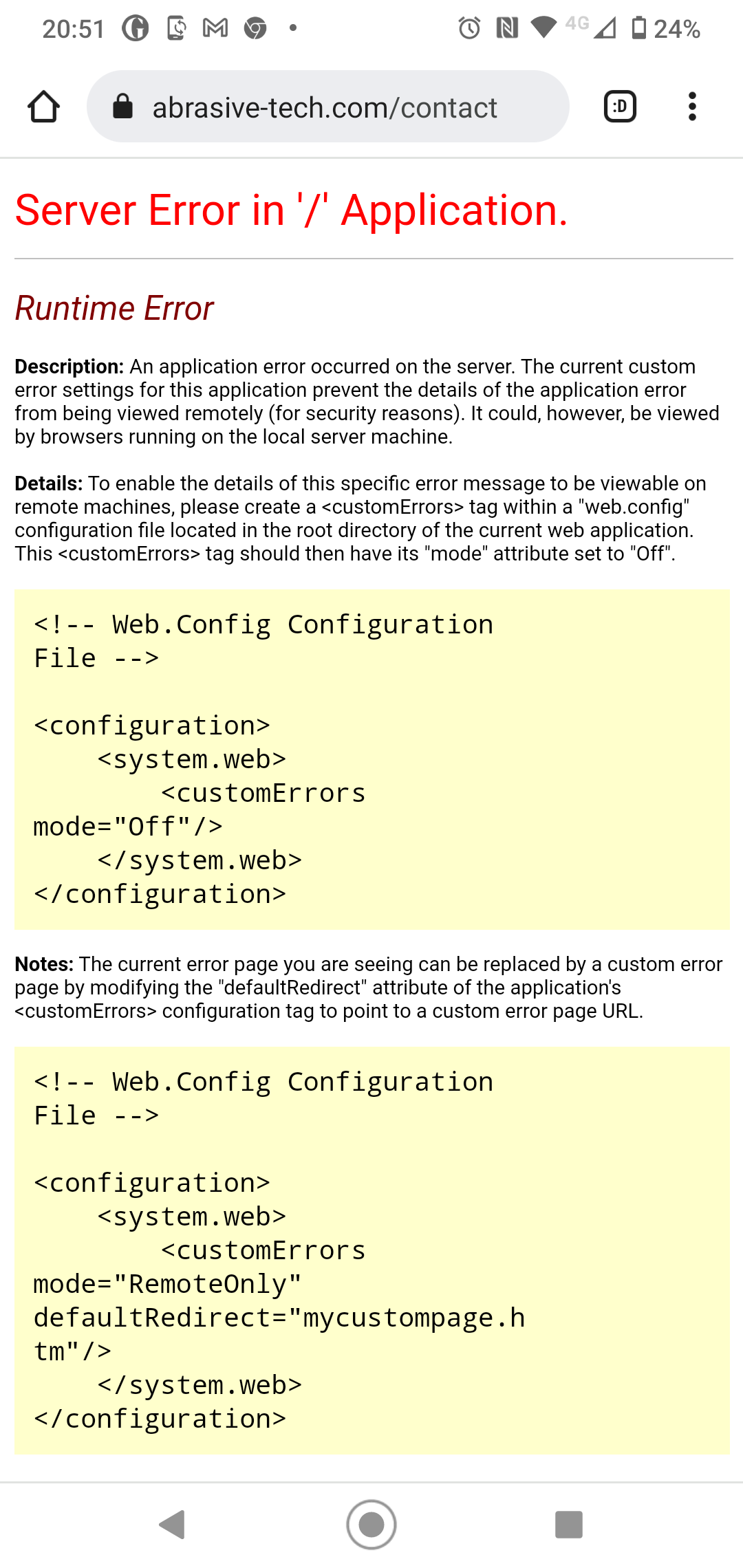

Thanks for the prompt response. I had tried contacting the European branch, based in the UK (which is where I am), but they
have closed - I could not even leave a message. I also tried contacting the US headquarters but the contact form does not work (the response I got each time I tried the form is attached). The web page does have a user manual, but it's the two page leaflet I already had. My contact at "His Glassworks" said the factory that produced the Crystal Master Pro 12 had burned down.
