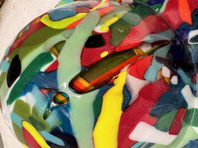

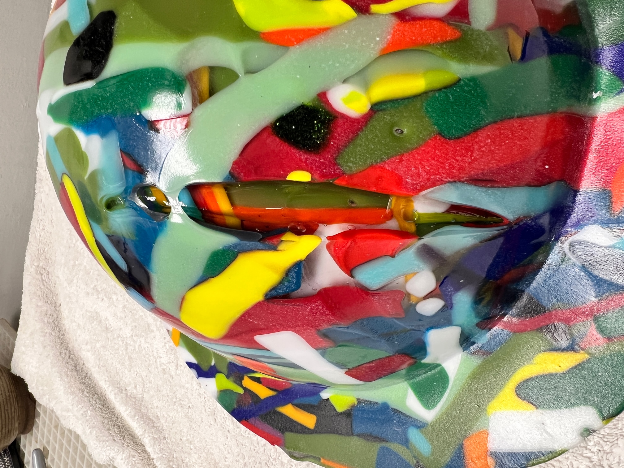

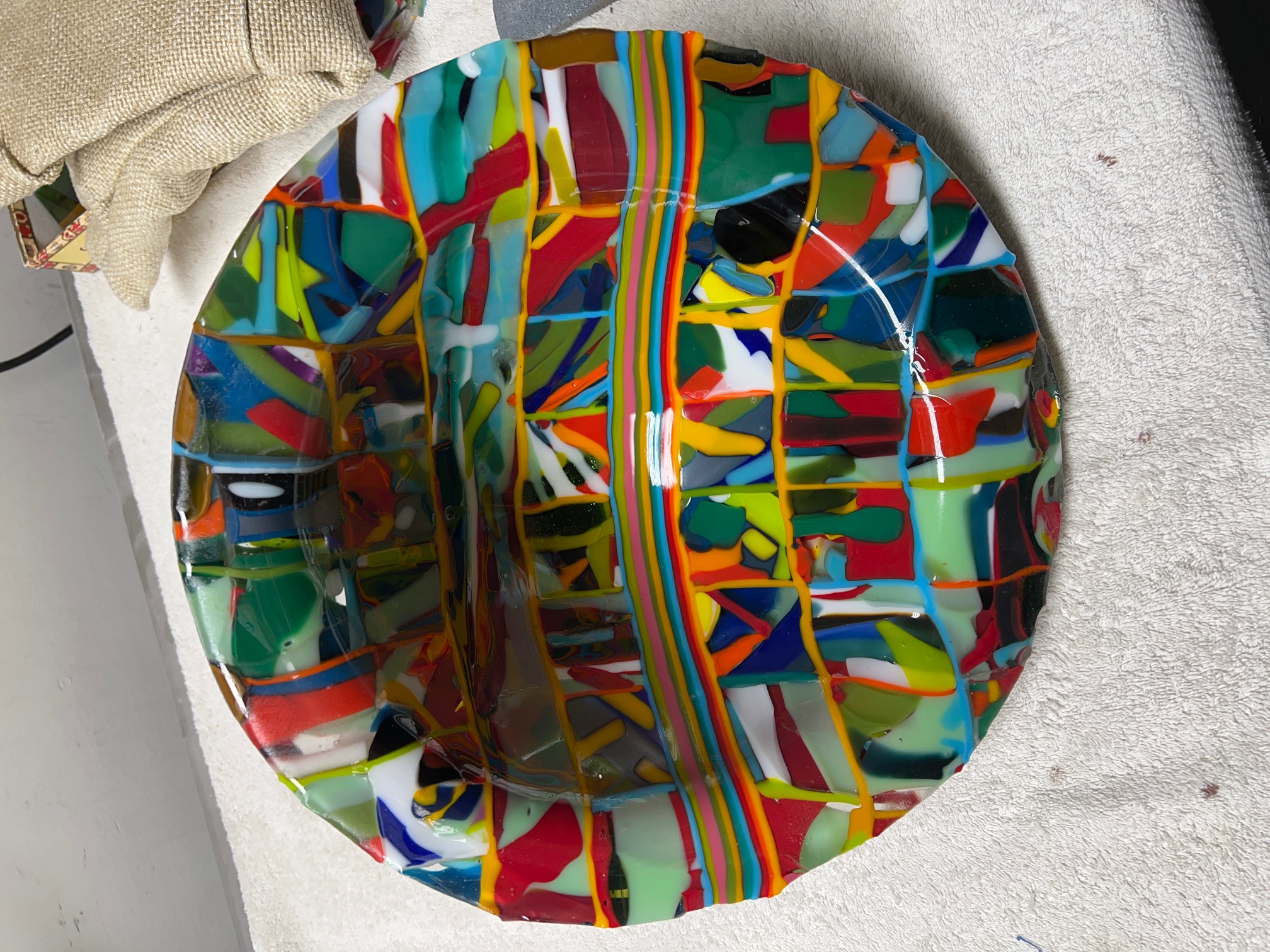

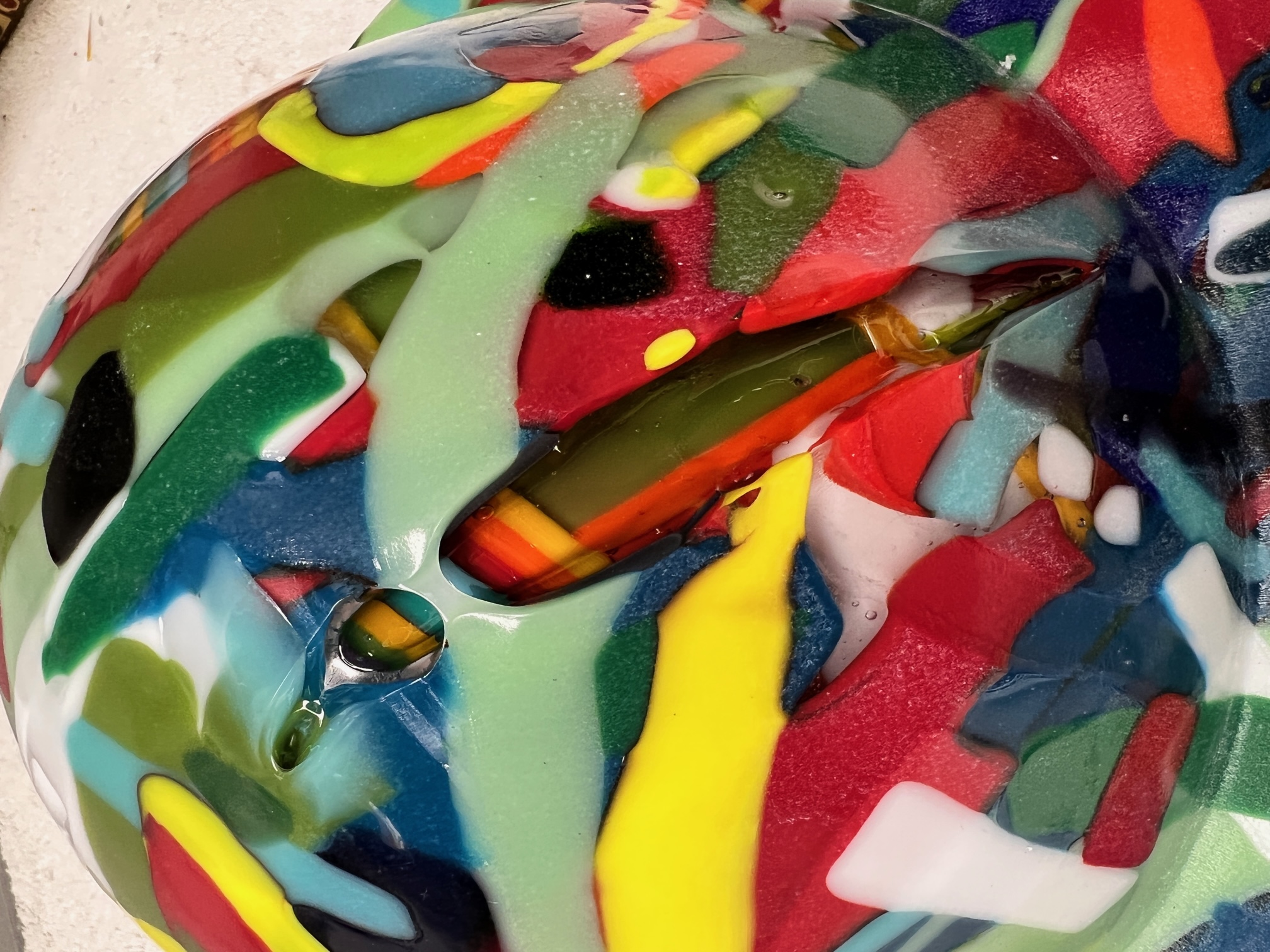

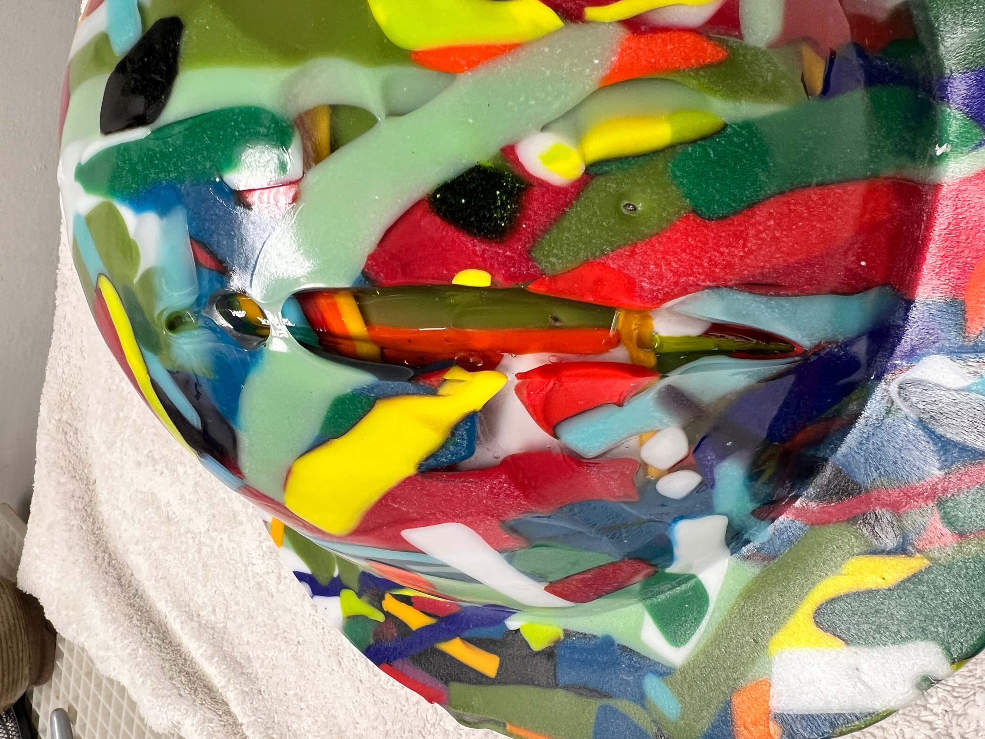

Setup. 14in diameter strip slab fused. Set kiln side down, place a circle of clear, build another strip slab design on top. Fuse to 1600, no hold, 900 for 1.5 hours, 100 to 700 ect. I have a 5/8 in x 14 slab set over a 10in hole in the shelf. Fire at 300 dph to 1250 and stop at desired depth. This setup has worked. Yesterday’s drop produced a split in the piece on the outside not going all the way to the inside. I have no clue why. Any guesses out there?

Looks like thermal shock from being too close to top elements. That kind of slit is characteristic of that situation. I usually see it in slumps.

Follow up. Slowed the heatup to 100dph. Same thing happened. I now know Brad was correct in that the top elements were too close. The delamination was always on the bottom of the slab. Dropping the shelf solved the problem.
