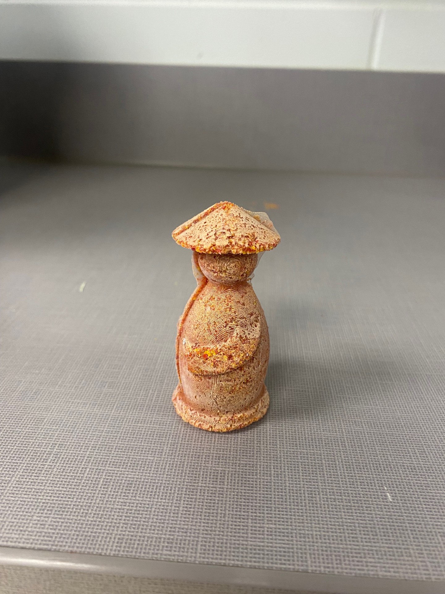

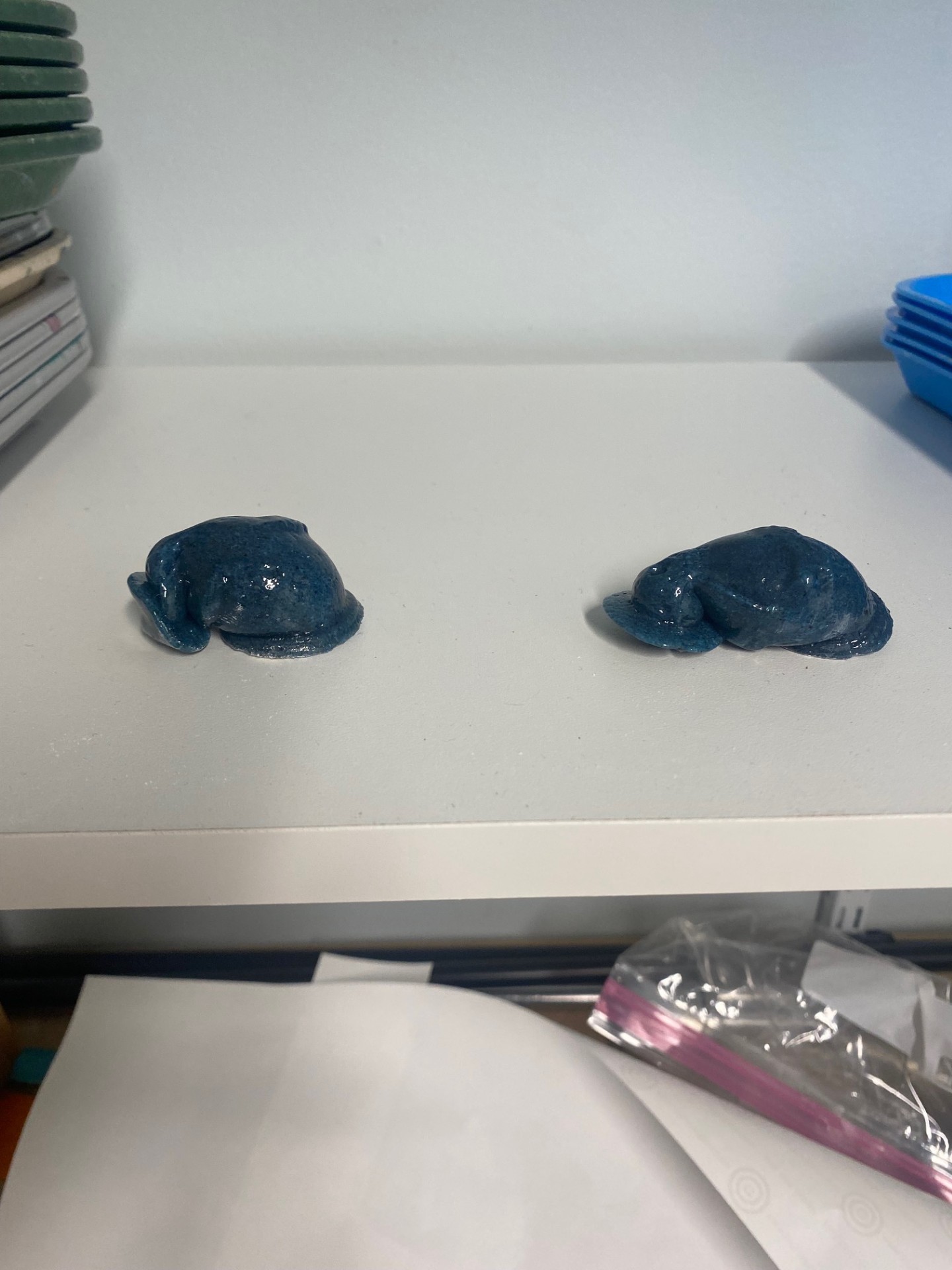

I am a glass fusing instructor and I have a student who is trying to make game pieces using the Freeze and Fuse technique. He has made his own silicon mold and the pieces are made from powder frit that he ordered from the local glass supply store. The pieces are roughly 1 inch wide and about 2.5 inches tall. The problem that we are having is that the pieces are falling over when fired.

How can I keep the pieces from falling over? Are they too tall to accomplish a successful freeze and fuse.

They're most likely way too tall.
- Location: North Carolina
Re: Help with freeze and fuse
Usually any type of undercut will fail.
Also, tall pieces will do exactly like yours did.
