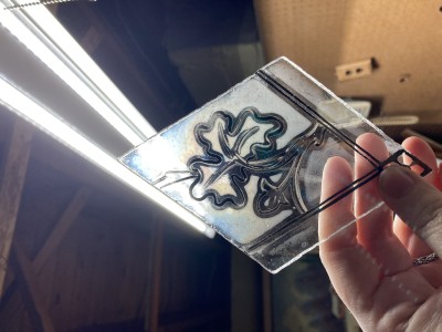

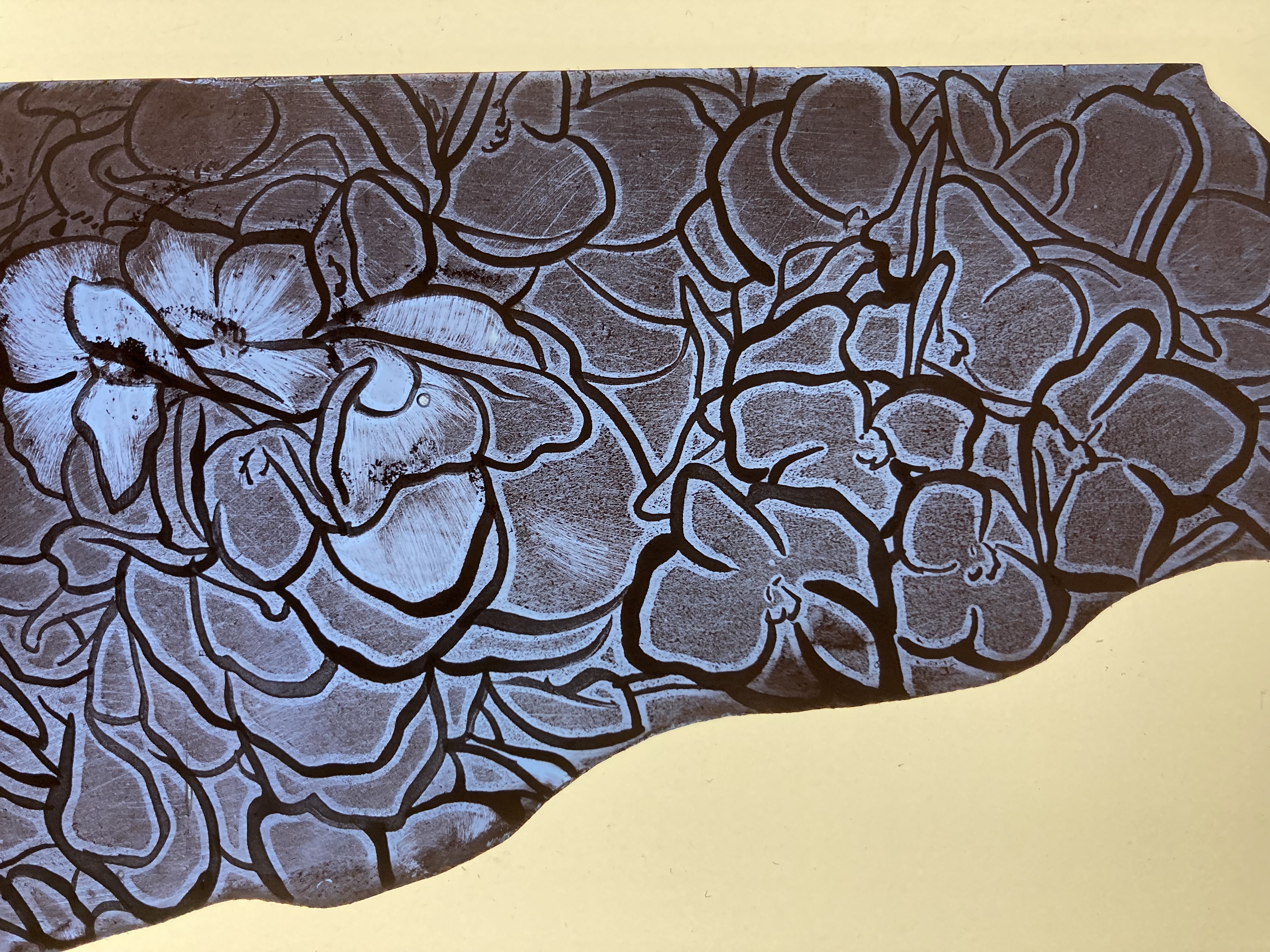

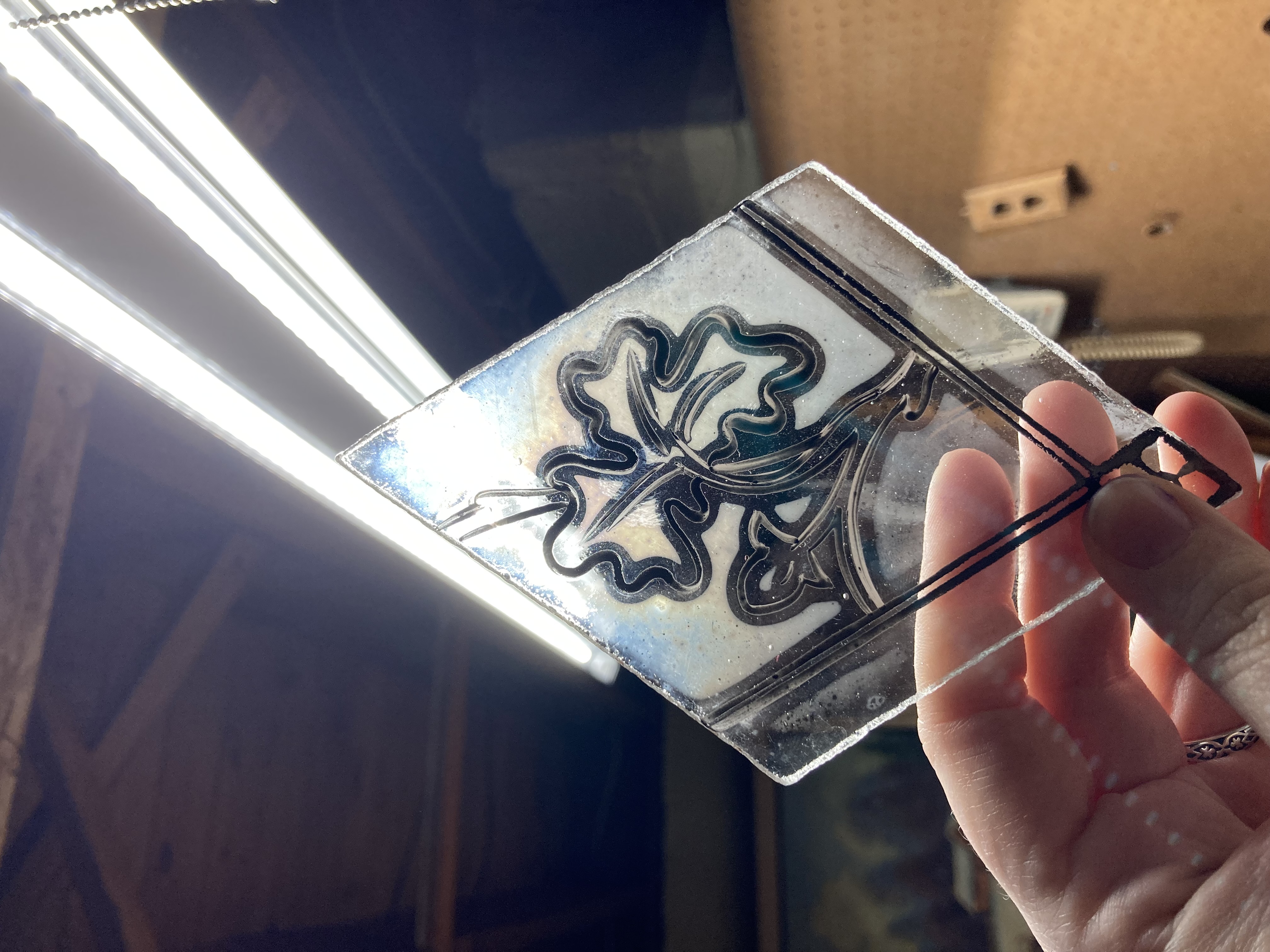

So I’m struggling with what I can only think to call “halos” around my painted lines. This is to say that I’m experiencing a strange film on my glass after it has been fired, but this film is conspicuously absent in the form of a halo around each line. If this were happening on purpose it might be neat, but unfortunately it’s just very very frustrating. A second layer of paint will hide it, but in some cases the effect is so striking that a secind layer only makes it more noticeable. (Such as in the blue hydrangea flowers below.)
It happens on almost all types of glass - from all manufacturers. (With the exception of some float glass.) It happens regardless of my painting medium. (Glycol or water with gun arabic.) I’ve tried different temps, different glass (so much glass), different paint, different brushes, different cleaners/glass prep, different cleaner/prep applicators, different glycol, different water, different hold times… and the only change is that now it seems to happen to every single piece. If anything it seems I’ve somehow made it worse.
It has happened in numerous different kilns at my local studio. It has however never happened to me in any gas fired kiln. I don’t believe it is the fault of the electric kilns - otherwise wouldn’t this be happening to more glass painters? I’m running out of variables that I can think of.
My last idea is to try a fiber shelf, as someone mentioned it may be a reaction between the kiln paper and the paint. But I’ll need to find some advice on that as I don’t know what’s appropriate and I don’t currently have the budget to buy many different shelf options. I am trying to save up to rewire my house so I can run my own kiln, but for now I’m stuck paying for each test firing - and that’s not helping me save.
Has anyone seen this phenomenon before? I’ve reached out the the SGAA, Deb Coombes, and a few other friends - but we’re all puzzled.

So after a dozen more tests, it appears it may have been a reaction between the black and the bullseye thin fire paper. Once I convinced the kiln operator to fire without the paper the problem seems to have resolved. We ran a few more loads just to make sure it wasn’t a fluke… and so far so good. Now if I only understood enough about the chemistry to know why this happens.
