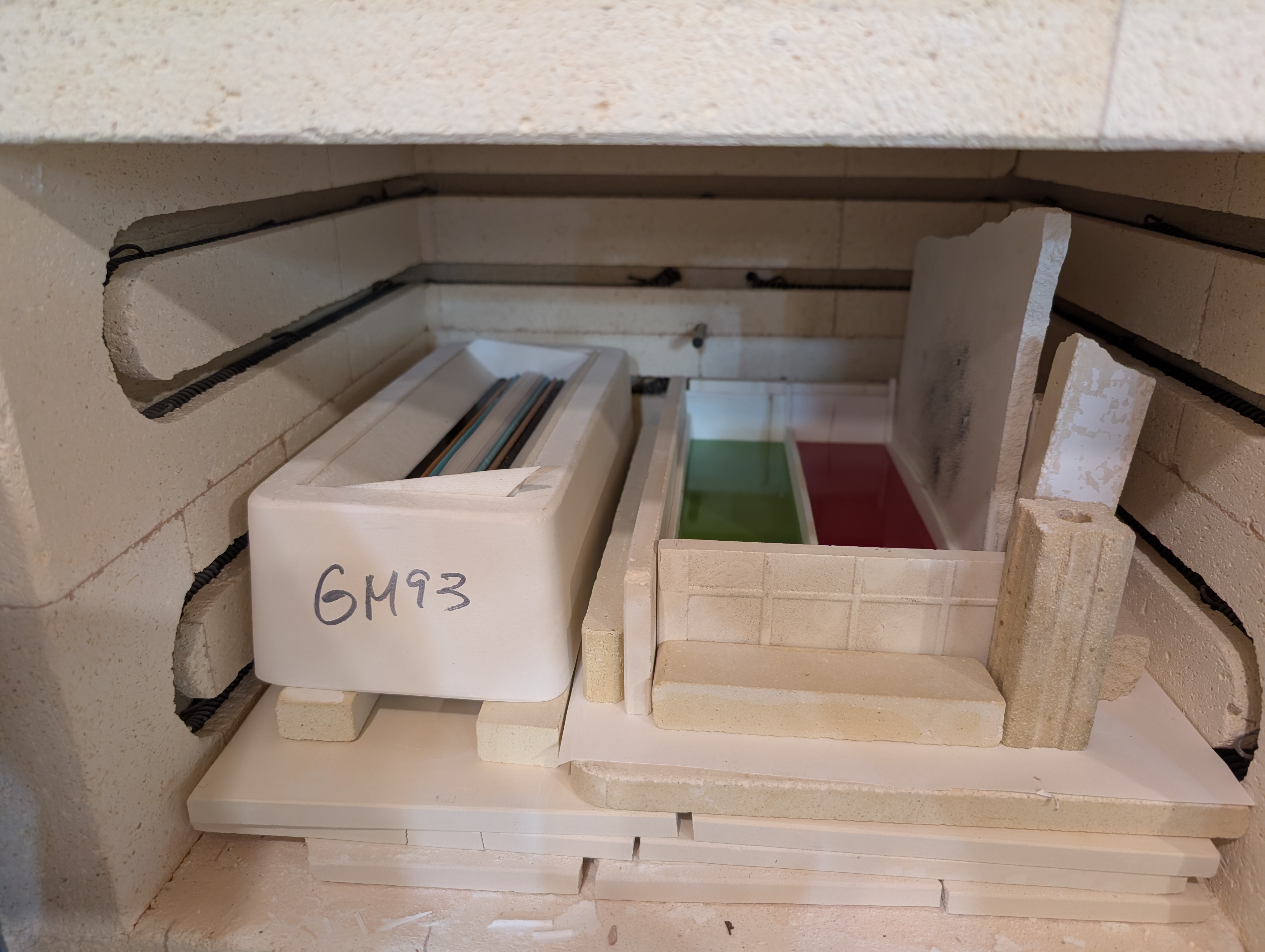

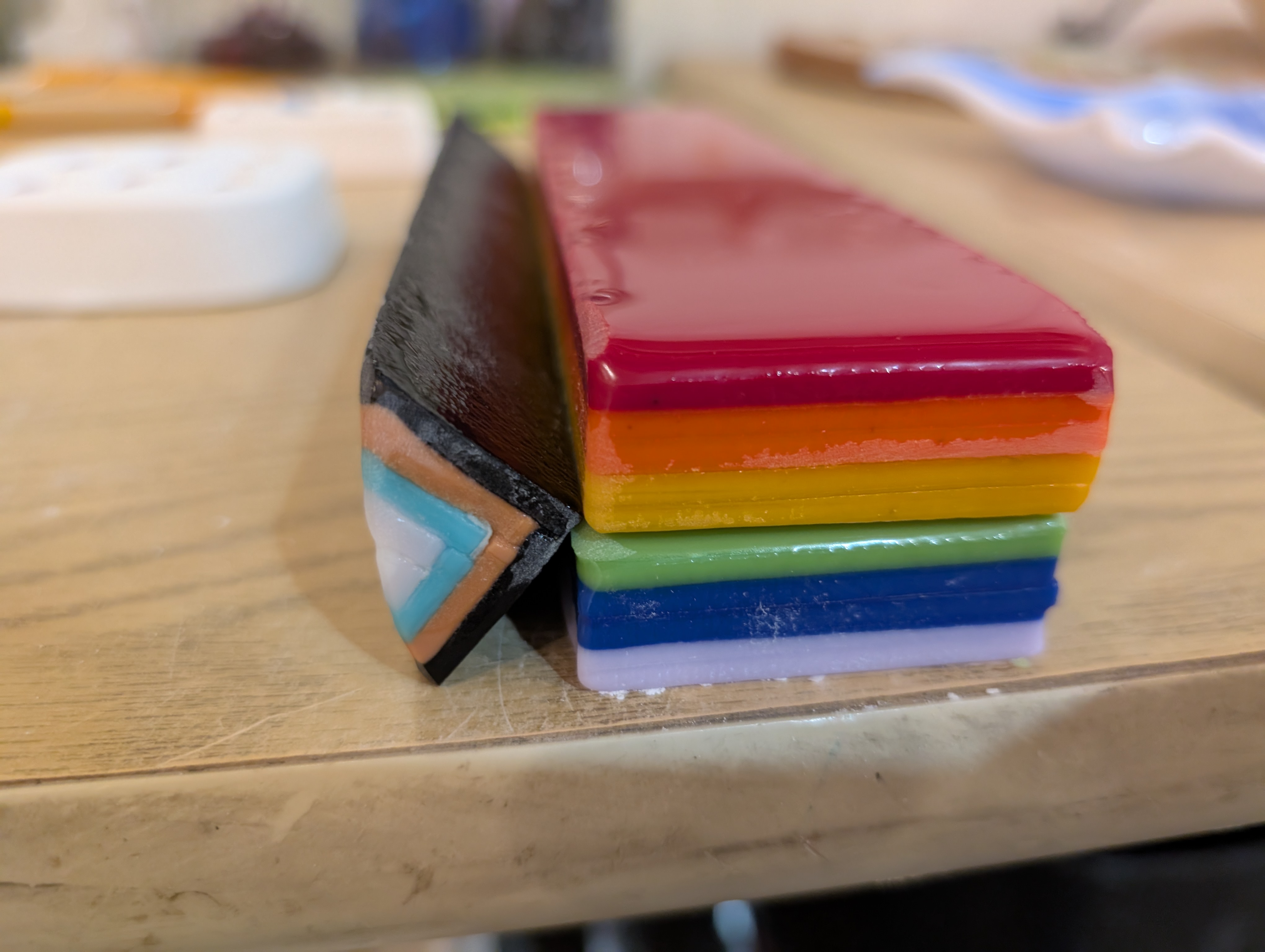

I fired these pattern bars earlier this week.

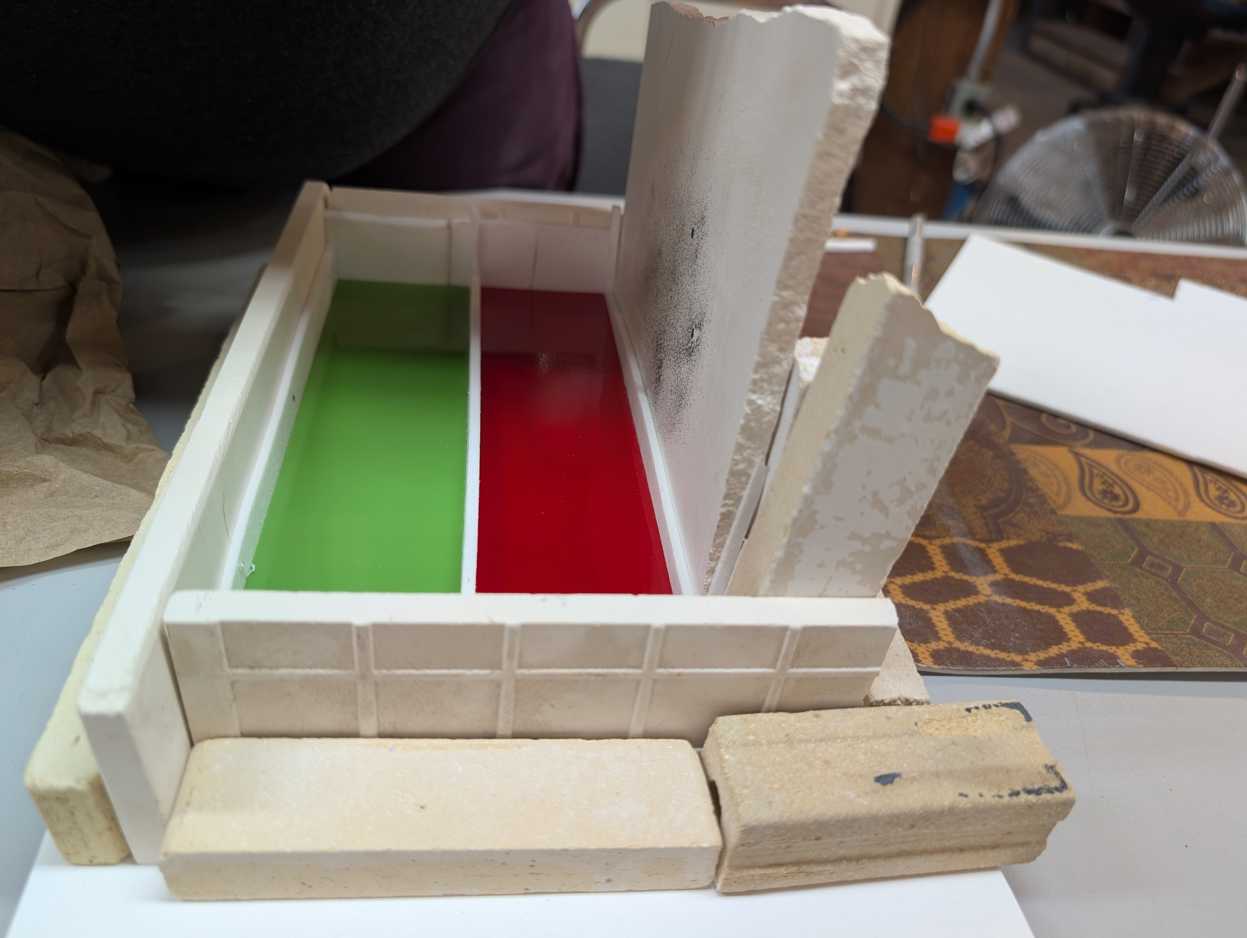

I didn't have a lot of good pieces to dam with so looks a little funky but I think I adapted well. And I know I cut the fiber paper badly. The glass is all Oceanside (well, the pink may have been Uroboros) and I used this schedule, modified from what Brad suggested in his book:

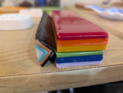

I'm REALLY happy with how they turned out; it was my first time doing pattern bars on my own.
The next step is to put them together. This is 3 pieces so I'm going to cut the bottom left corner off the red/orange/yellow one and the top left corner off the green/blue/purple pieces then turn them skinnier side down and put the triangle in the cut out part then fuse them together.
Given how they responded to the first firing, do you have any suggestions for the next firing? I'd like to try to make the pieces fuse together a bit more but I'm not sure how far to push it or whether I should be going longer or a bit higher. The kiln is small, as you can see in the first picture and all of the heating elements are in the walls. The triangle is the one I'm most concerned about getting more fused. I don't hate the current look but I worry it's more pronounced in the middle. I just like the blending together look more.

The horizontal stripes are 2 inches wide, each 3 color block is 6 layers of 3mm glass high, and they're ~8 inches long. I'm going to turn the stipes vertical and then put the triangle in the cutout then fuse again. Right now the plan is triangle on top but if someone has feedback on that, I'd love to hear it.

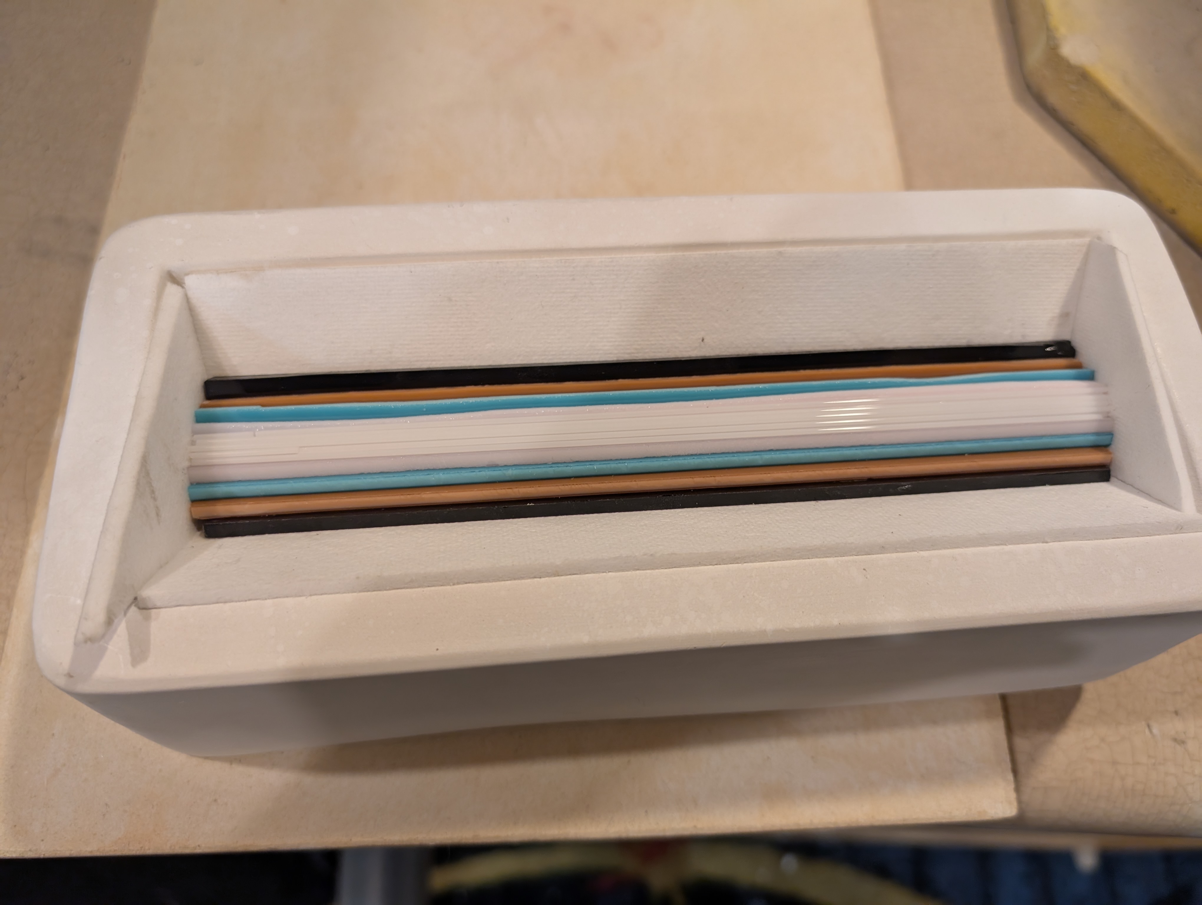

Edit to add: I fired the triangle on fiber paper in the mold due to reasons of lacking confidence in the ZYP & being told by a doctor I need to avoid the ZYP at the moment and not having anyone else around to do it. There's a texture to the glass now, very similar to when clay gets rolled out with a piece of canvas on it, if that makes sense. I don't know if that affects the advice about the next firing schedule bc of air getting trapped.
